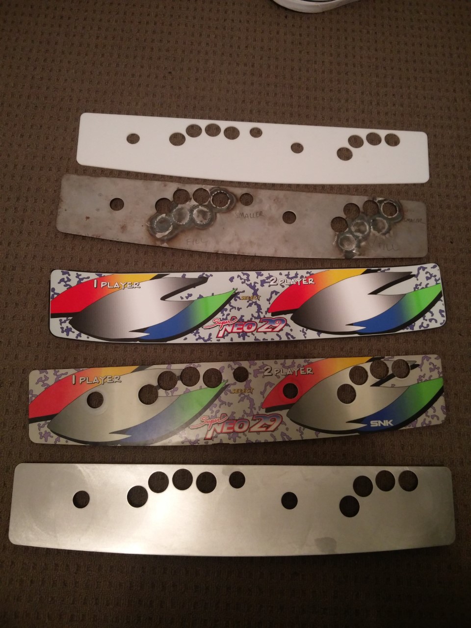

Hey guys about a year ago I remade the 2 Player 4 button layout for a Super Neo 29 Candy, I never got around to uploading it.
The print I have put on is from gameongrafix, originally I wasn't happy with it and asked for him to reprint it for me, basically It was too short.
He fought me and eventually sent me another print that was exactly the same?
I'm a signwriter by trade so I have no idea what is going on there.
The 2 pictures with the ruler are an original control panel and his print showing its undersize.
I think this was the reason I didn't want to release this because he would get more business, but hopefully he sees this and fixes the problem.
Please don't buy from him without asking for a fix.
It was laser cut out of 1.6mm Stainless Steel.
I don't have access to a stud welder anymore so thread was tig welded instead which worked although not as well.
As a bonus I vectorised the Instruction Strip and included that too.
I may in the future vectorise the side art as well as that isn't up to snuff.
I have a slightly rusty original one here that needs some love if anyone is interested.

I also want that exact CP - mine is 7 button without a select button. I've also got the gameongrafix overlay; my problem wasn't size but just that it looks average and I hate the feel of the vinyl compared to the original. Having just got my first sega cab on the weekend, the quality of the overlay is so much better (on the sega).
If anyone (especially in Australia) gets it together to get a run produced, subject to price of course, I'm down. There's at least one other AA member interested in this CP too.
I have no suggestions though, beyond noting that Alberto is planning on doing a run but that seems to keep getting pushed back.

The original control panels have been made by Lexan and it is expensive product. Stainless Steel is same too. Plus offset print is also expensive.
I think it will be 80-100 USD around Metal + Artwork part together.

I didnt make the art, I just made the control panel outline.
I've had one of these cabs for years, and around 20 years ago I had a local machine shop cut me a ill fitting cp, that's covered with plain black cp overylay.
I'd love to get a proper one. but with a 7 button layout.
Not a lot of activity in this thread..
I took the outline from this thread and added my own button layout (It's a mame cab, servostik joysticks), and added the studs.
I used 4mm press in studs.
I have a cpo on order, and I'm going to see if I can customize the insert, I have no photoshot skills.
