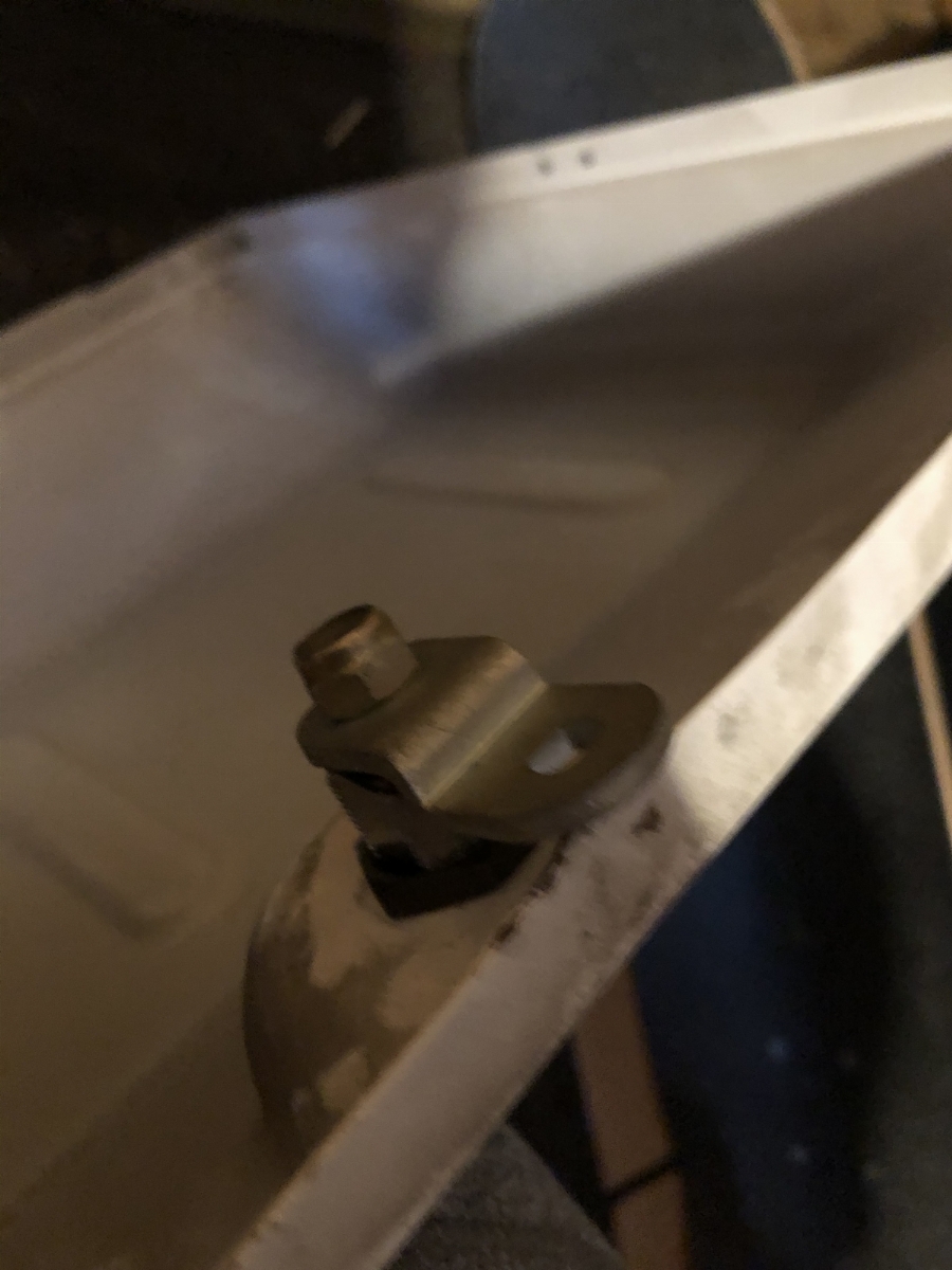

To start I need to break into this thing as I didn't get any keys with it. Luckily there are no locks on the main PCB door, the coin door or the coin box. There is one lock that is locked on the right side of the control panel and one lock on the rear access panel.
Since drilling locks is kinda a pain, I wanted to avoid it at all costs. I was able to sacrifice one button on the control panel to allow access to the lock and tang on the right side of the CP. Using a screw driver, I slowly and carefully backed the nut off the back side enough to allow the CP to clear the tang. (The only large flat-head screwdriver I had was the one I use for discharging, hence the attached wire)
Success, we are in the CP and have drilled 0 locks, but destroyed one button. I was planning on replacing the controls on this CP as they all feel like warm mush, so no big loss.

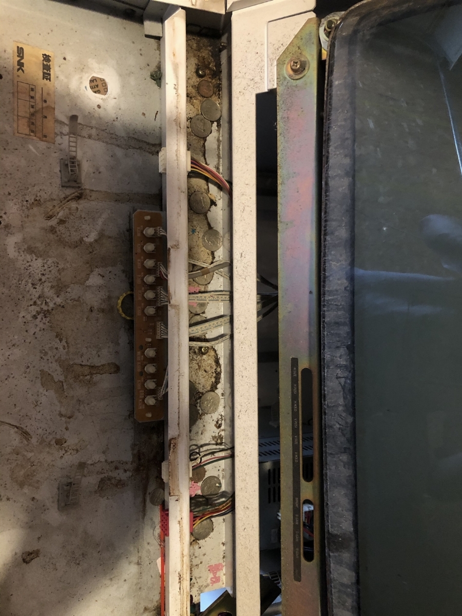

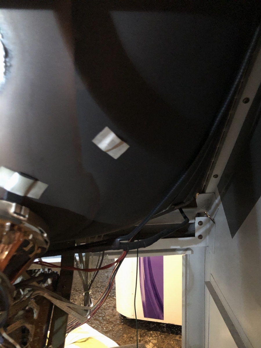

Next step was to take off the marquee and monitor surround. This cab doesn't have hinges for the monitor surround, instead it is screwed to the cab from the inside, with 3 screws on each side. One side shown below. This is somewhat difficult as the screws are right next to the side of the cab so not much room for knuckles and a screw driver. You can see a magnet taped to the back of the monitor, some factory tuning of geometry or convergence.

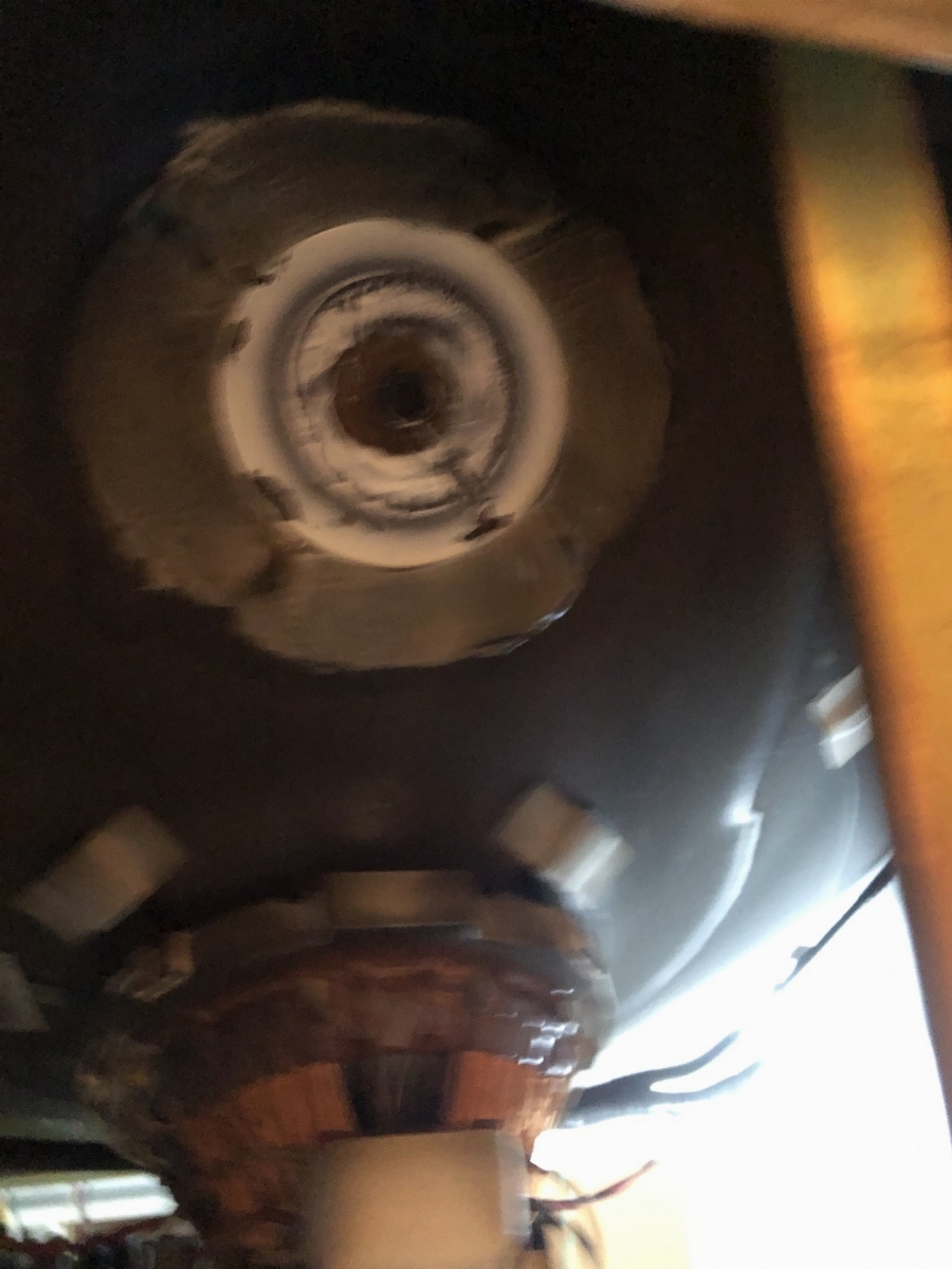

Monitor discharged and anode cap removed. You can see a nice healthy amount of grease. Be sure to leave the grease there, I believe it is to prevent arching.

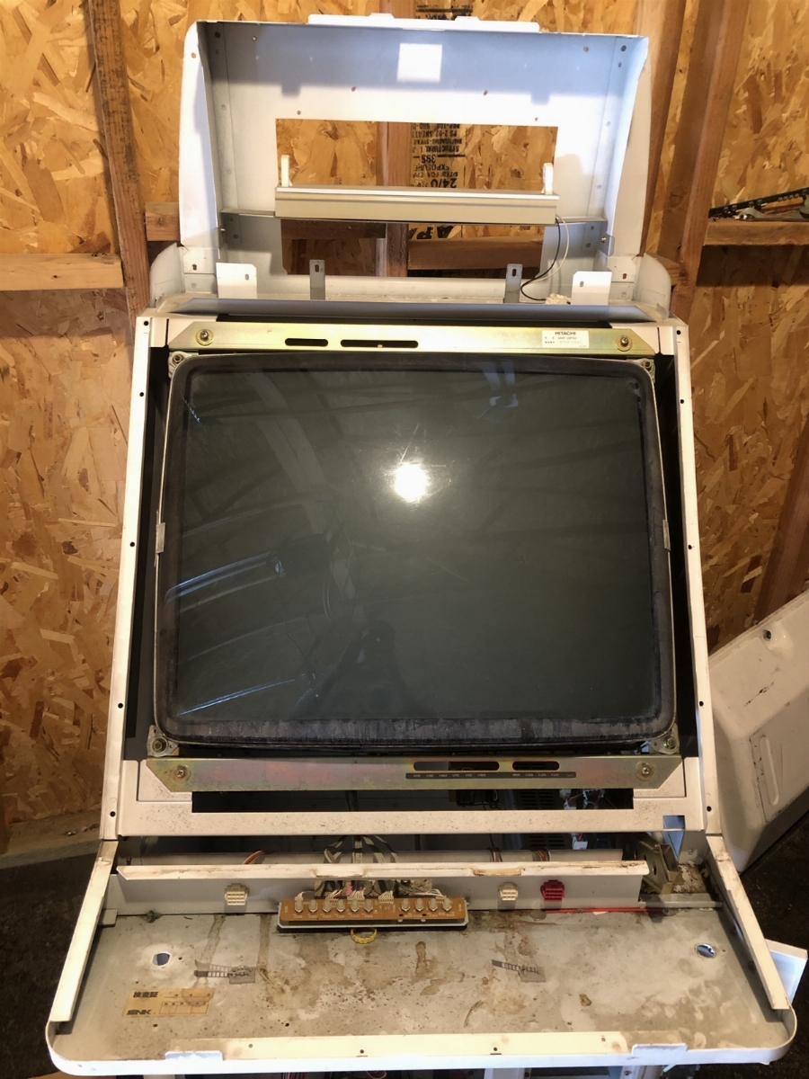

Monitor surround and marque removed
I'm rich!!

Monitor removed.
Control panel removed. It attached to the cab with 4 screws into the front, and 2 into the ledge. The 2 screw holes close together on the right side of the ledge are for the coin chute.

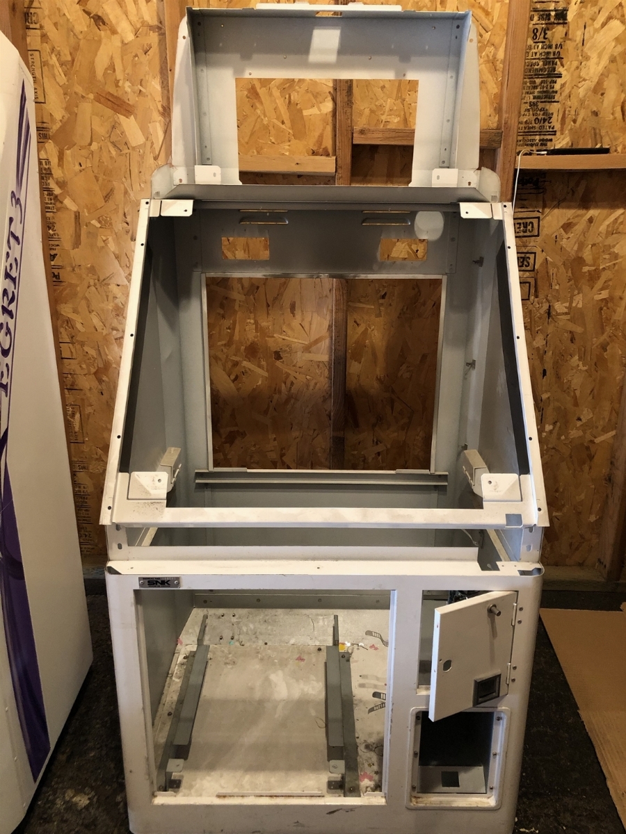

Interesting that the top marquee surround is spot welded to the main cab body. That is as much as can be removed by unscrewing brackets. I remember the Neo Candy 29, you could removed the whole marquee box from the cab body.

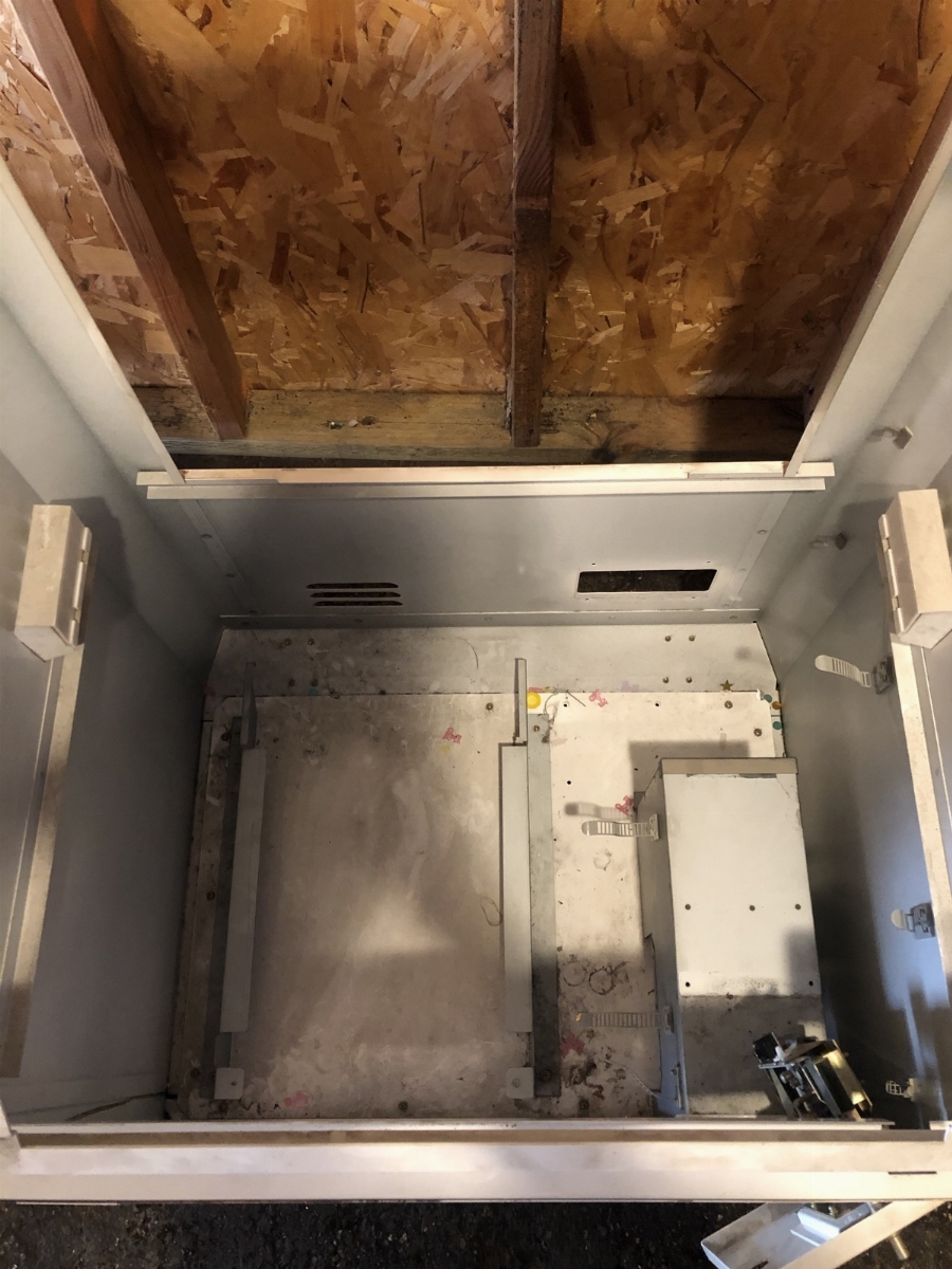

Coin box and PCB mounting board rails removed

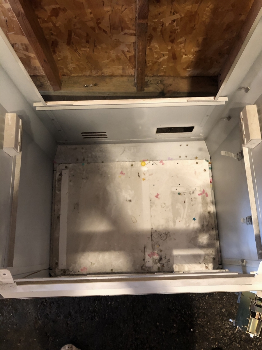

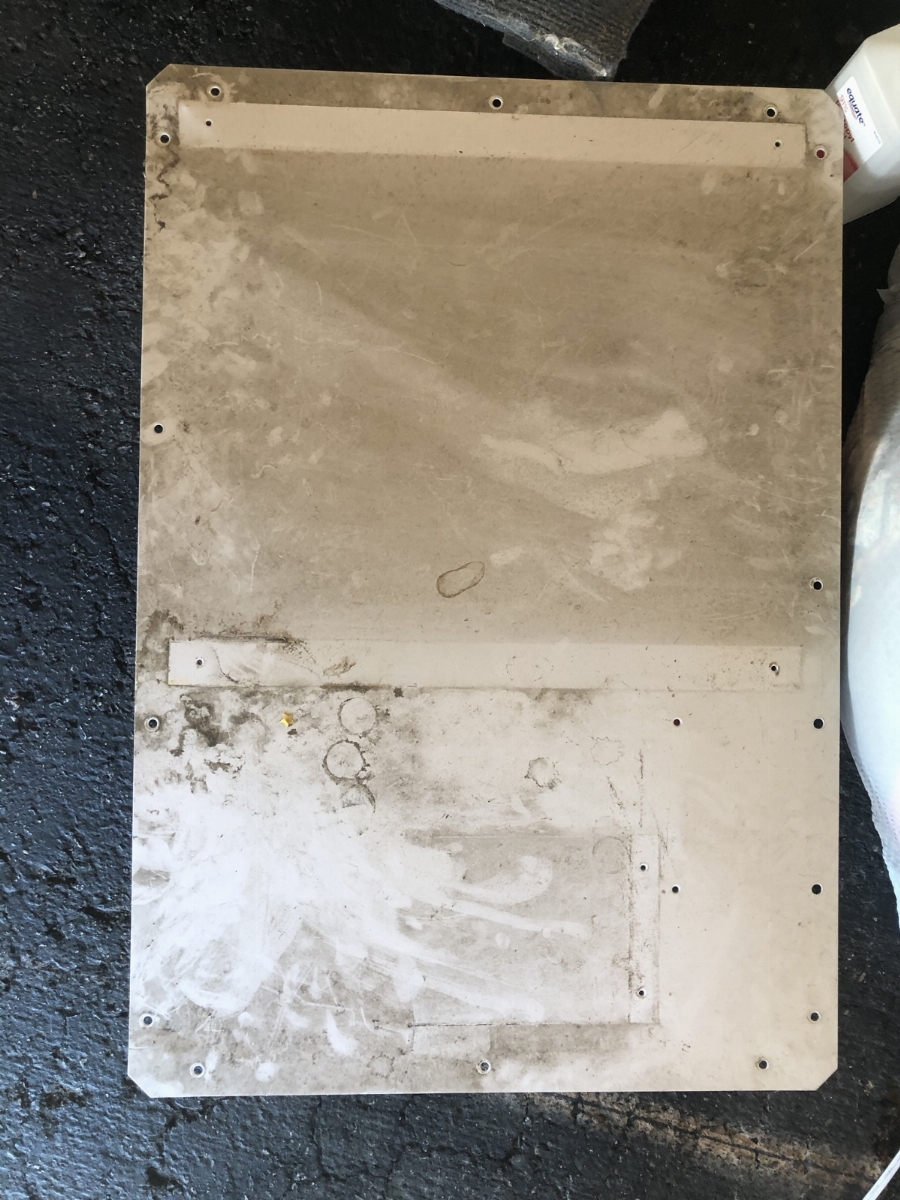

Floor pan removed, this is basically as far as I can strip the cab down outside of taking off the 2 wheels on the back.
I'll leave with a parting shot of the dirty floor pan

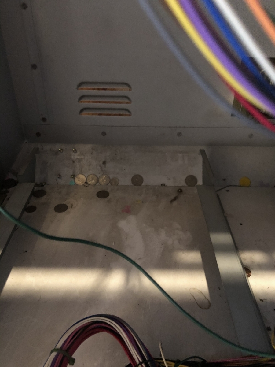

I am thinking of taking the ~$8 worth of quarters I pulled out of the cab and going to one of those manual car wash places and giving the cab and control panel bottom a good hose down. Seems somewhat fitting to use those quarter to clean this bad boy. Apartment life sucks without a backyard and a hose...
Decided to just use some spray cleaner and go to town on this cab, its not that dirty, just some dust for the most part. First, I cleaned the inside of the cab so that I could reinstall the bottom plate. The bottom plate seemed to add some rigidity so I didn't want to move it too much without the plate being installed.
Time to reinstall the bottom. Looking pretty good if I do say so myself.

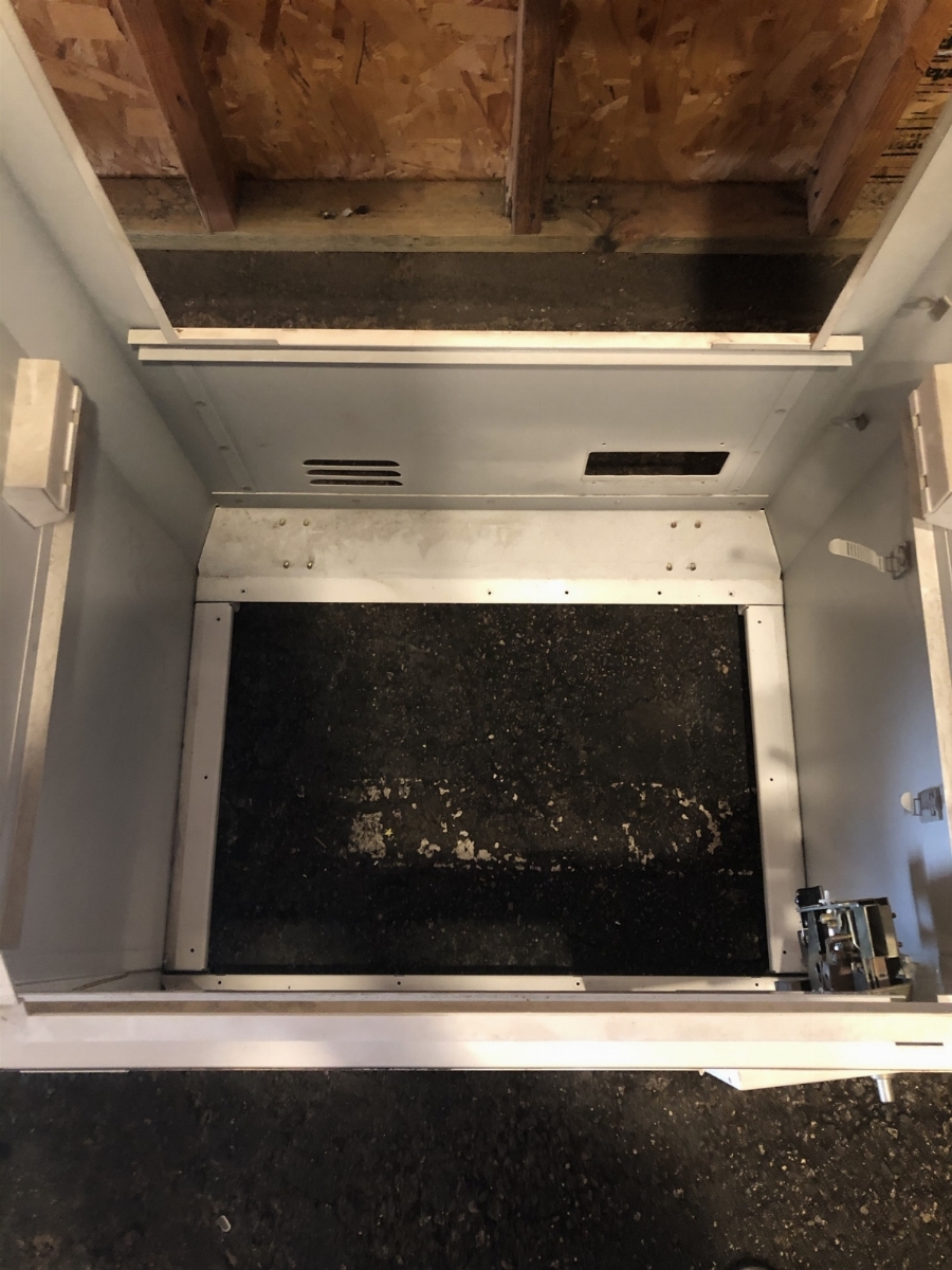

Installed the PCB mounting board railing and the PCB mounting board itself. Flipped the board over to show off the nice clean side.

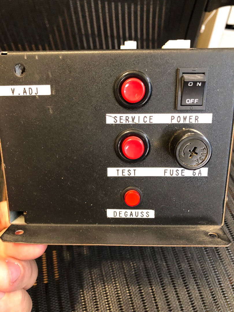

Power supply capacitor replacement complete. Here is the digikey cart that I used. That cart has some alternates included so you will get some extras if you don't zero out the duplicate ref des parts.
The before shot of the power supply, removed from the casing and given a dusting.
Blink and you miss it, new caps installed
And back in the case it goes
Screws in, I think they were all the same so not much to mix up at this point
All the connectors reattached and ready for the last side.
One happy power supply
