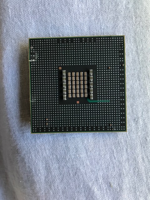

I will send a pic later but the whole GPU chip has been ripped from the board and cracked. looks like he was trying to remove the heatsink. I dont think its meant to removed. The processor has had its heatsink removed.
I will have a closer look when I get home. I think the PCB might be alright since most of the solder would've been pretty weak. That being said if enough force was used to pull the chip off the board it wouldn't surprise me if it has done some damage to PCB.

Here's Pics of the damage, looks like a few of the pads have been ripped out. I would assume this means its not repairable. I had a better look at the board and there are definitely a few small differences between the generic Super Slim PS3 and this. The main one seems to be the bluetooth module has been removed. So it I'm not sure if it would be possible just to flash a board with the custom bios. Also i don't have a copy of the bios.

If you look at the chip you can see that its definitely damaged beyond repair on the side. Also you can see the pads still attached to the chip.Are pads normally repairable on a board like this?
The PS3 CPU has some sort of one time programming memory which hold unique per console information. It's tied to the flashrom data in the mainboard and the system controller MCU. You can move these chips around to another motherboard if you move them together. But considering that your CELLBE chip is broken, that system is done for.
