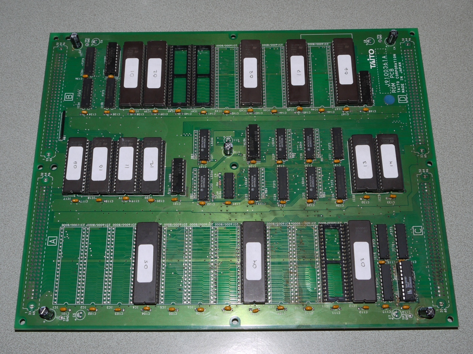

And used it I have, as here's my Darius Gaiden conversion:
It almost works. Unfortunately, I have the same the same two issues as I did with the Bubble Memories conversion. I was hoping they were ROM related, but no such luck.
I have absolutely no sound, just a loud buzz.
I have graphics anomalies. You can see a video of it here. They're not hard to miss at 0:03 and 0:32.
Anyone have any ideas for either issue?
As for the PLDs, I have a jammaarcade.net D77-09 burned to a GAL in IC14, and original D77-14 in IC21, D77-10 in IC28, D77-11 in IC37 & D77-12 in IC48.
On closer inspection I noticed the PCB has bubbled up in the upper left corner. That's where OBJ GFX roms are. I guess whoever removed the original roms used hot air to desolder them. I wouldn't be surprised if that's where my graphics issues come from. I checked continuity on the tracks, but didn't notice anything out of the normal.
Still puzzled by the lack of sound though. Is it possible it's a PLD related issue?

MIssed this topic and forgot about the mention.@'nem' all i have to show is a bubble memories conversion board with some Eproms on it, no wierd traces or jumper wires or anything odd. If i don't forget i can take a picture of it, it's in storage and i need to dig it out.
What's the GAL in the bottom right of your picture? I think i have the proper d77-15(?) in the center but no gals in the bottom right. Only stamped Taito PLD's, cept the -15.

The GAL in the bottom right of my picture is mentioned in my post:
I swapped all of my chips from my rayforce boot with no audio into my bubble bobble 2 boot and the audio works fine, the chip layout is identical.
The pal chips were all the same except IC21 was D77-11 on the bubble bobble 2, but I assume its been written over with d77-14.

@nem. I got one of my f3 board going. I had a bad/slow D77-11. I burn a new atf16v8 and got the sound working. Thinking I got something I moved on to the next board. Changed D77-11 and no sound ,but i also notice I don't have a D77-12. This revision board don't even have pinout in that location. I went back to the 1st board and pulled D77-12 and I got no sound. So it look like D77-11 and D77-12 control sound.
