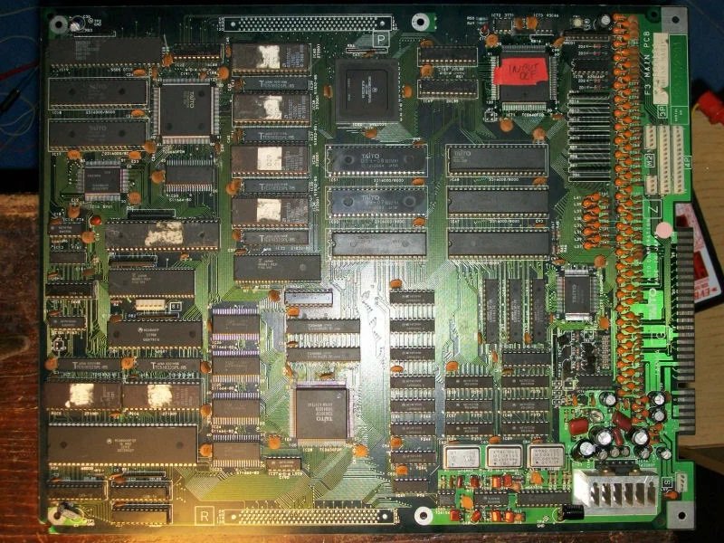

Taito F3 Orange (first revision of all)
- 2 x ENSONIQ 27c160 sound masks
- 2 x 27c160 Sprites maks
- 1 x 27c160 Sprites HIGH mask
- 2 x 27c160 Tiles masks
- 1 x 27c160 Tiles HIGH mask

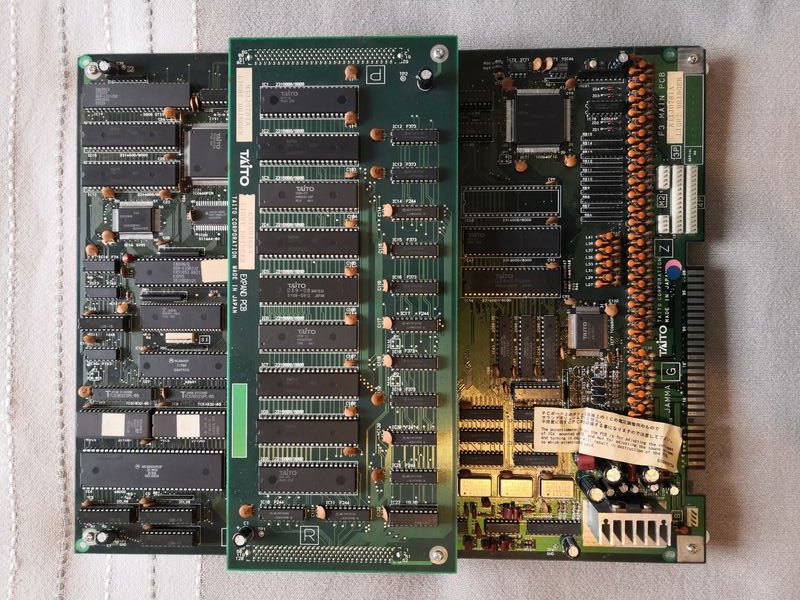

Taito F3 Orange + Expand (TAITO official conversions for using unsold previous games. The original game graphic masks are still soldered in the mainboard)
On mainboard:
On Expand board:
- 4 x 27c160 Sprites maks
- 2 x 27c160 Sprites HIGH mask

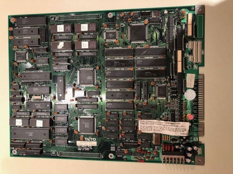

Taito F3 White (mainly Taito Cup / Super Cup Finals and Prime Time Fighters / Top Ranking Stars):

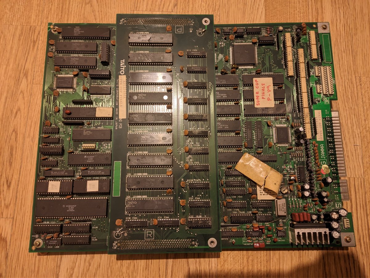

Taito F3 Super Cup Finals White + Expand (basically they are Prime Time Fighters / Top Ranking Stars on the motherboard, but Taito Super Cup Finals in the Expand board):
- Graphics are the same in both sections of the board (main board and Expand):

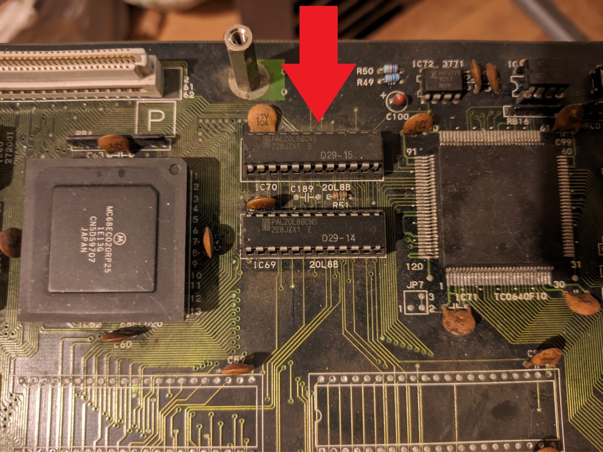

Depending on the game, is needed to change some PALs for MAIN CPU / SOUND CPU / ENSONIQ mode.

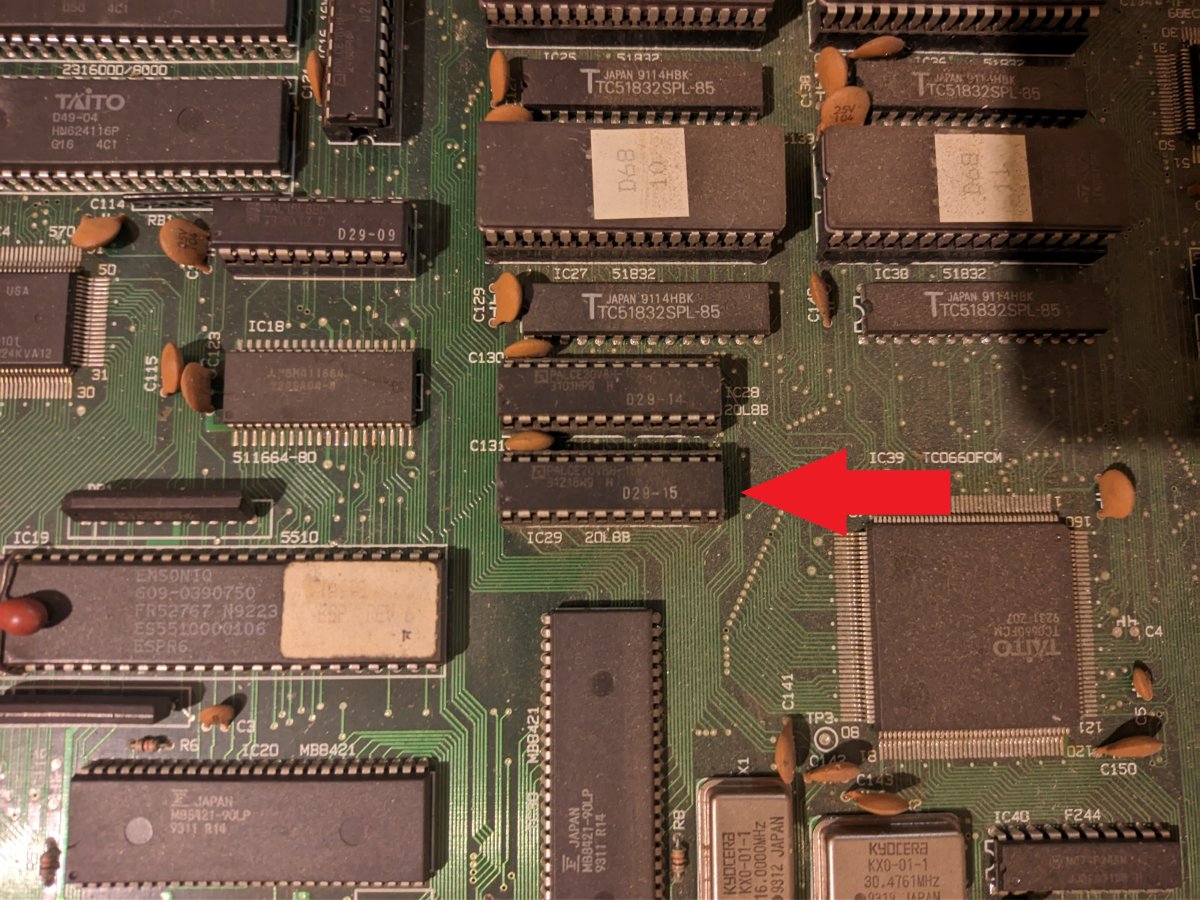

For 27c4001 Main CPU, D66-12:
- On White boards is IC29
- On Orange boards is IC70

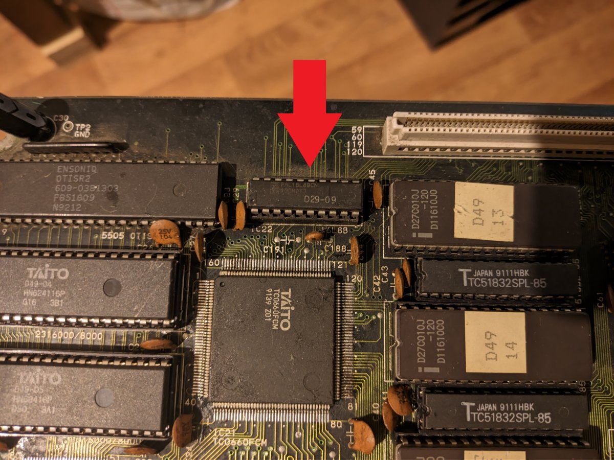

For 27c2001 Sound CPU, D66-09:
- On White boards is IC14
- On Orange boards is IC3

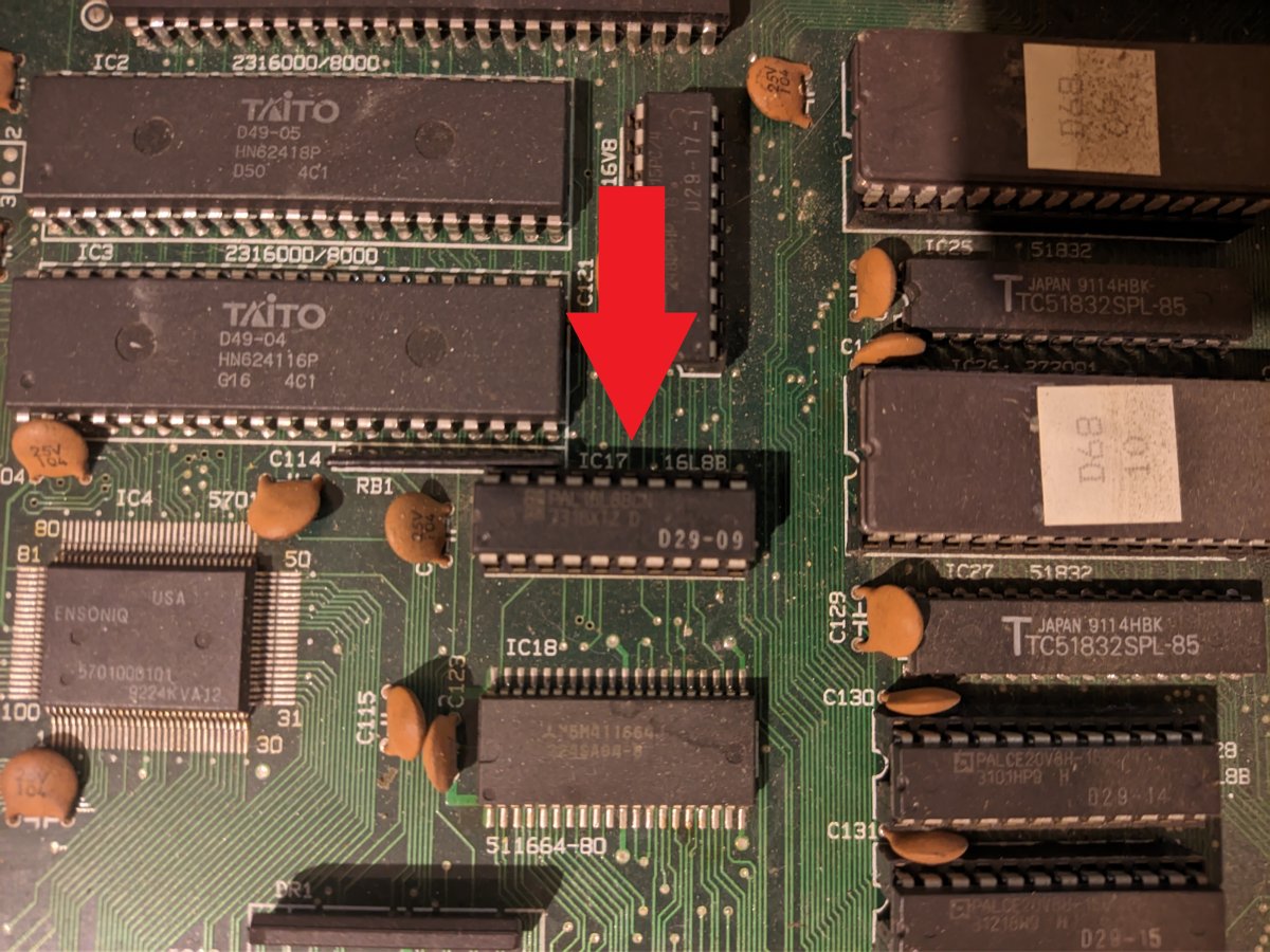

For ENSONIQ V2 mode, D53-12:
- On White boards is IC17
- On Orange boards is IC22

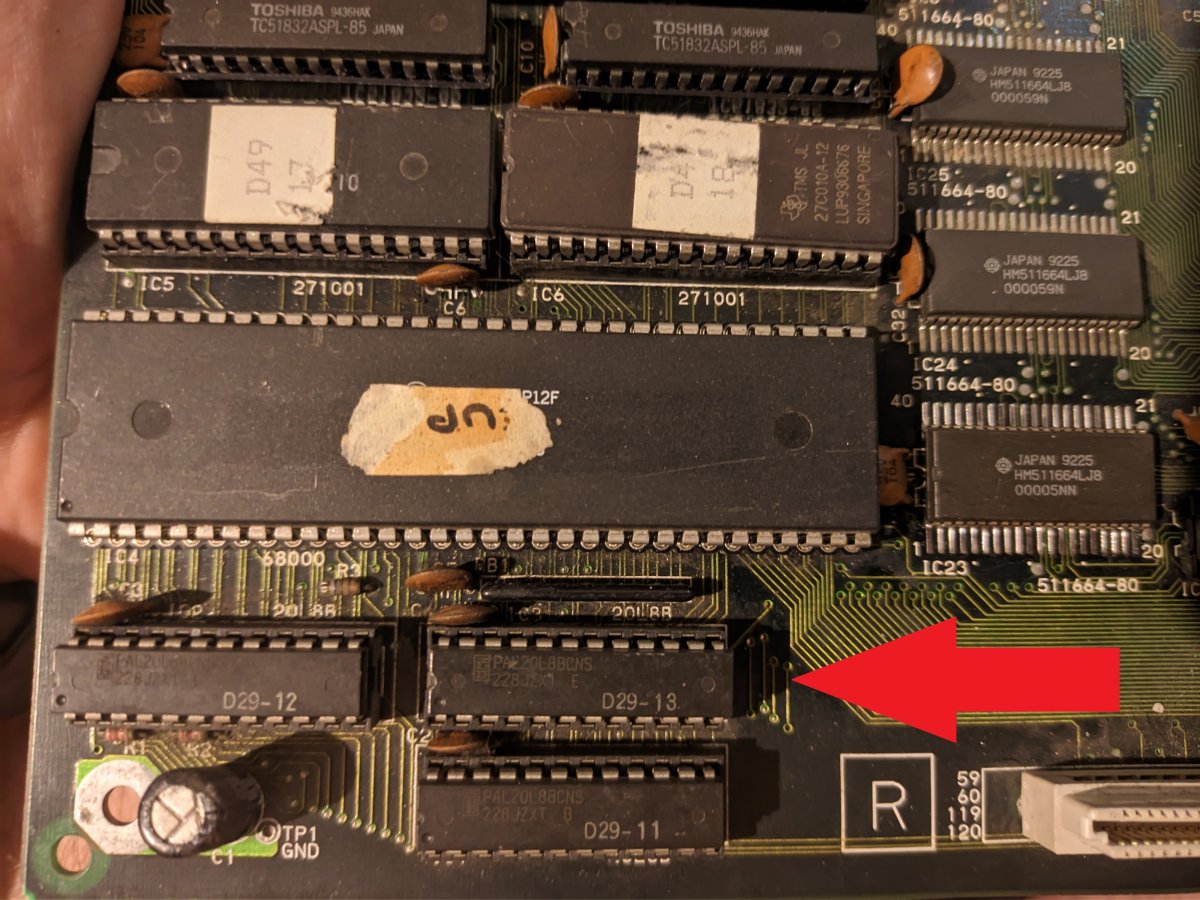

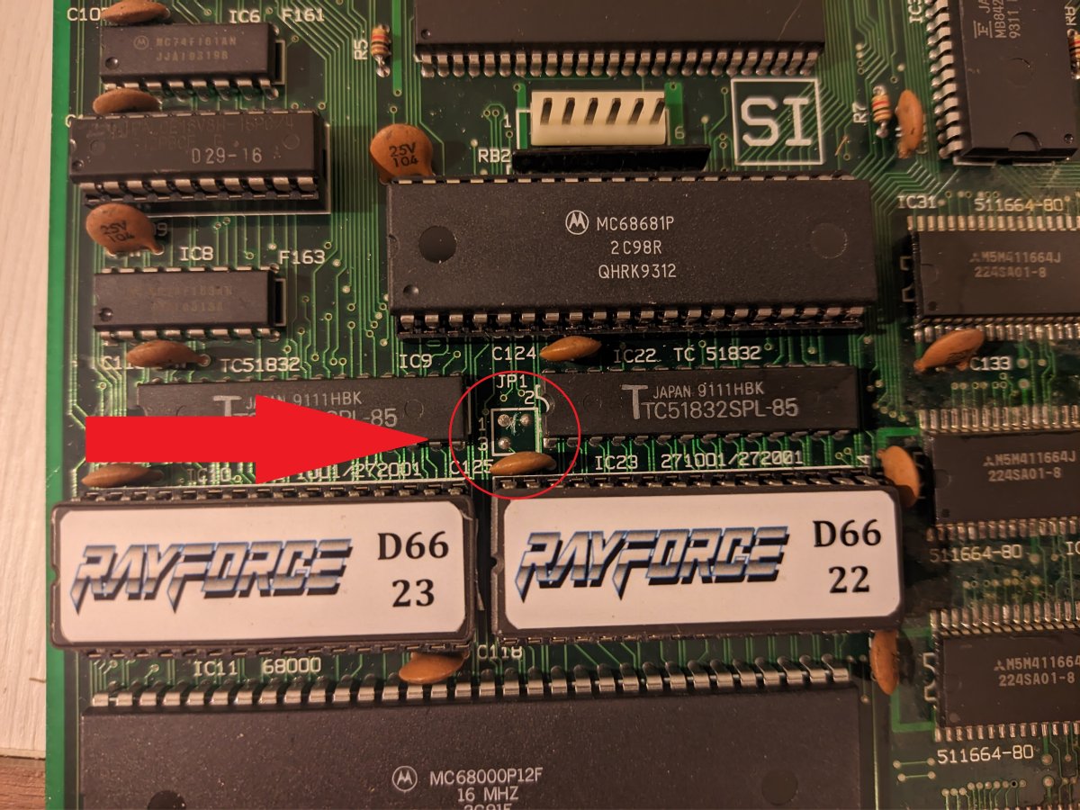

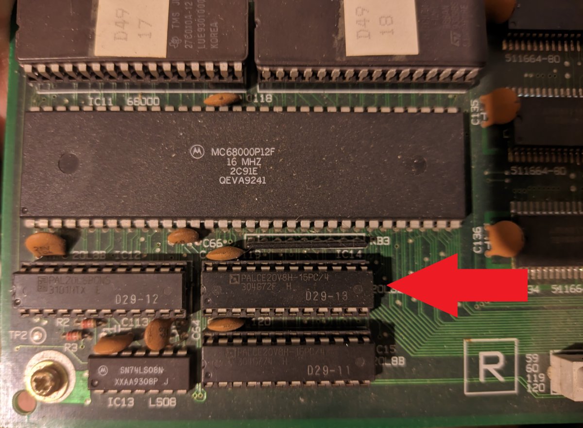

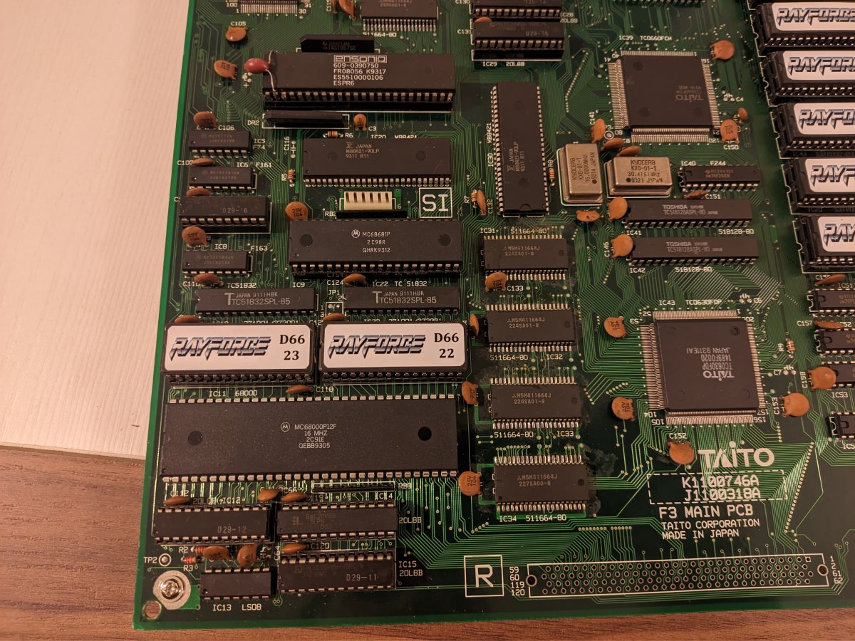

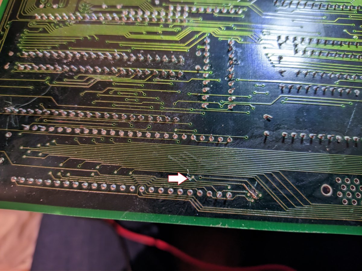

REQUIRED MOD FOR USING 27c2001 SOUND CPU EPROMS WITH MOTOROLA 68000:
Taito Super Cup Finals White + Expand / Prime Time Fighters / Top Ranking Stars:
Cut JP1 trace on top side
Make a new jumper on solder side
Taito Cup Finals / Super Cup Finals White:
Make this jumper on Motorola 68000 solder side
Taito Super Cup Finals Orange + Expand:

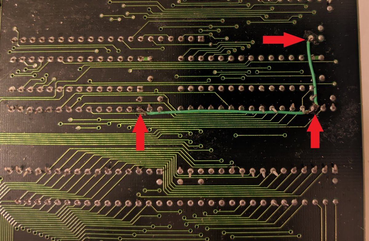

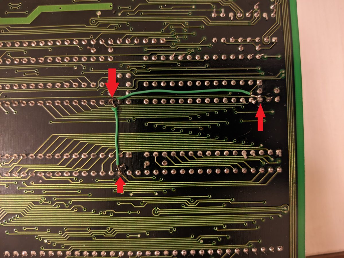

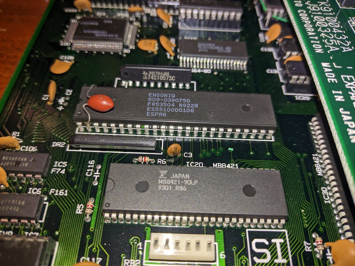

Now this is the real tasty improvement for making a Taito Cup Finals a full compatible board with ENSONIQ V2 games without sound bugs.
This discovery could be possible thanks to studying the pinouts of a Orange + Expand, Normal White and Top Ranking Stars board (V2 factory prepared). So let's see what is needed:

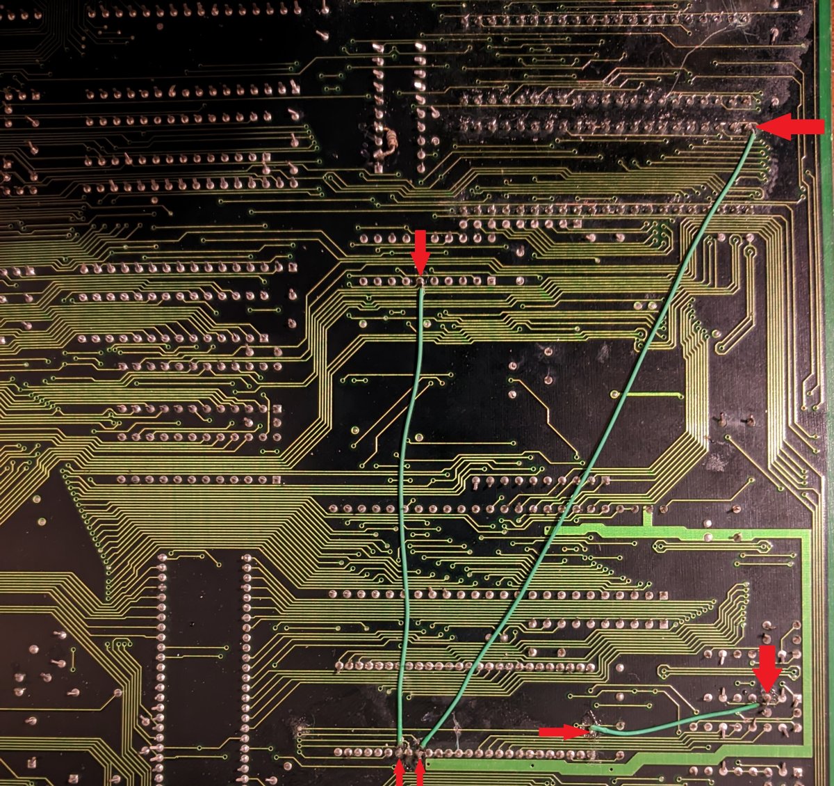

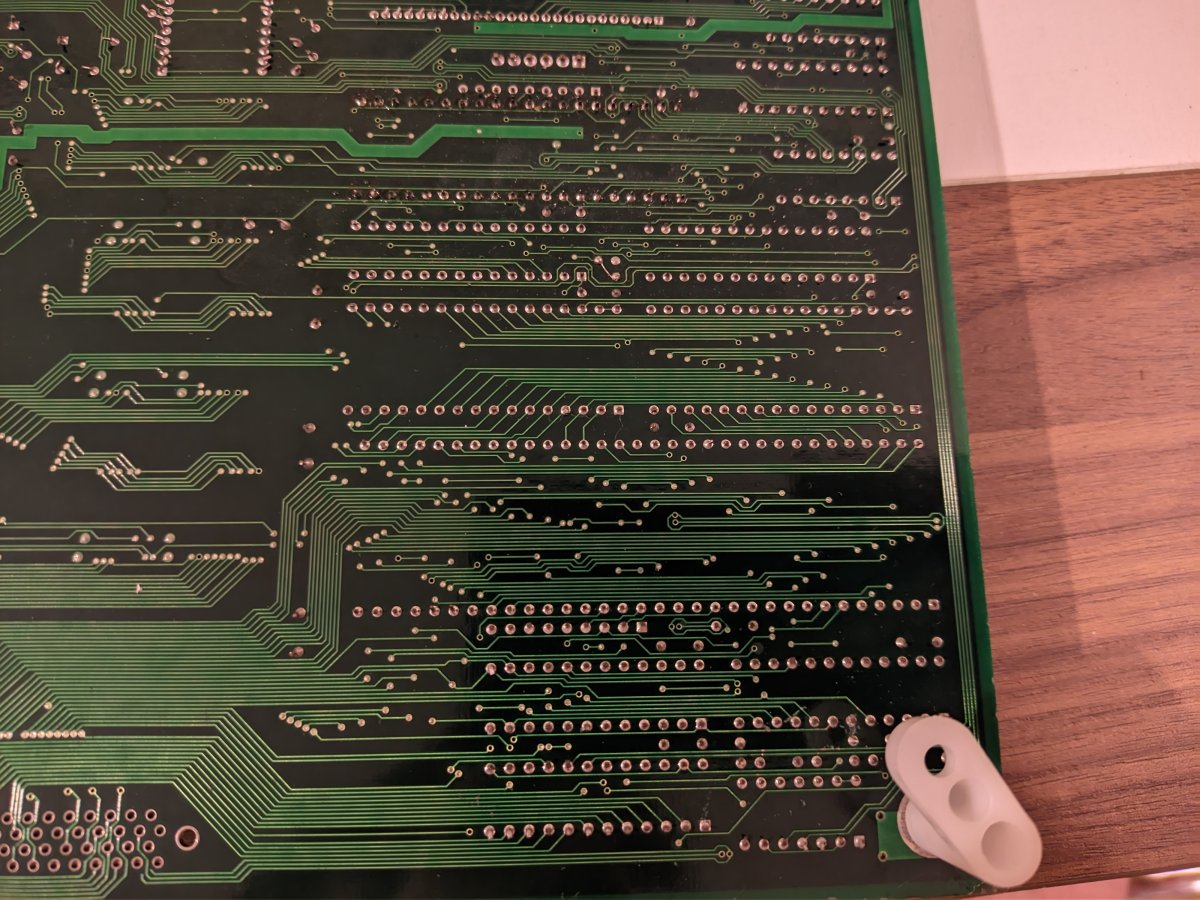

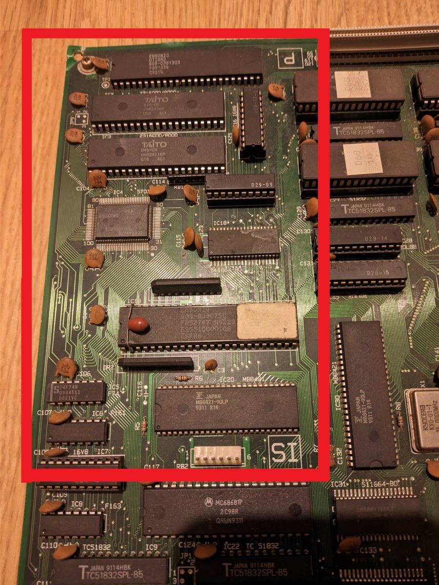

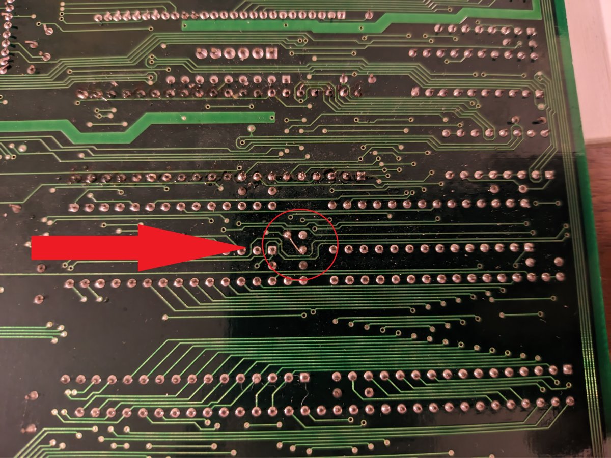

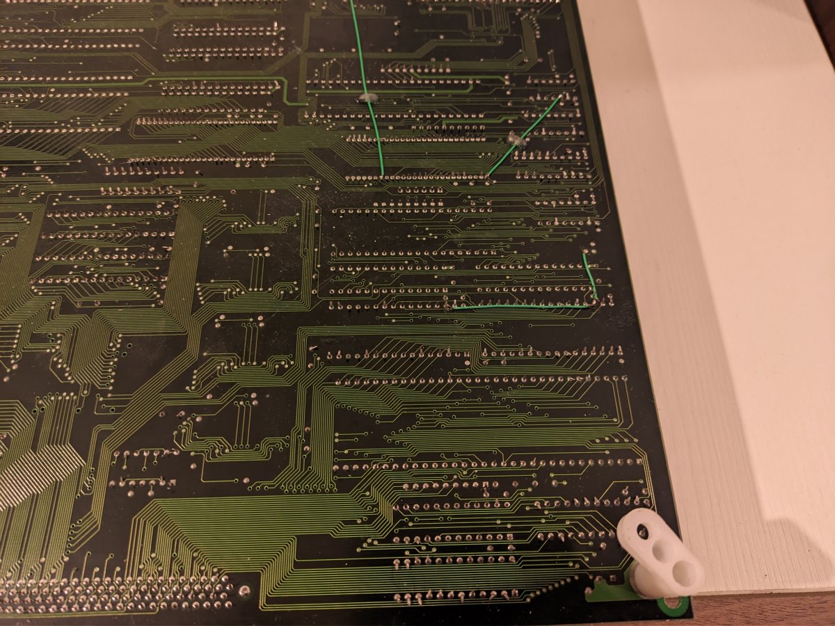

TESTED MOD OF FULLY CONVERTING A TAITO CUP FINALS WHITE BOARD ENSONIQ V1 TO ENSONIQ V2.

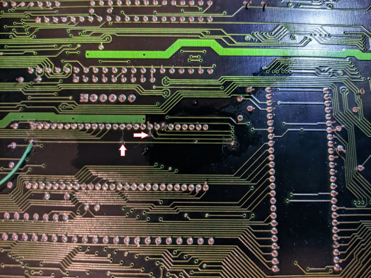

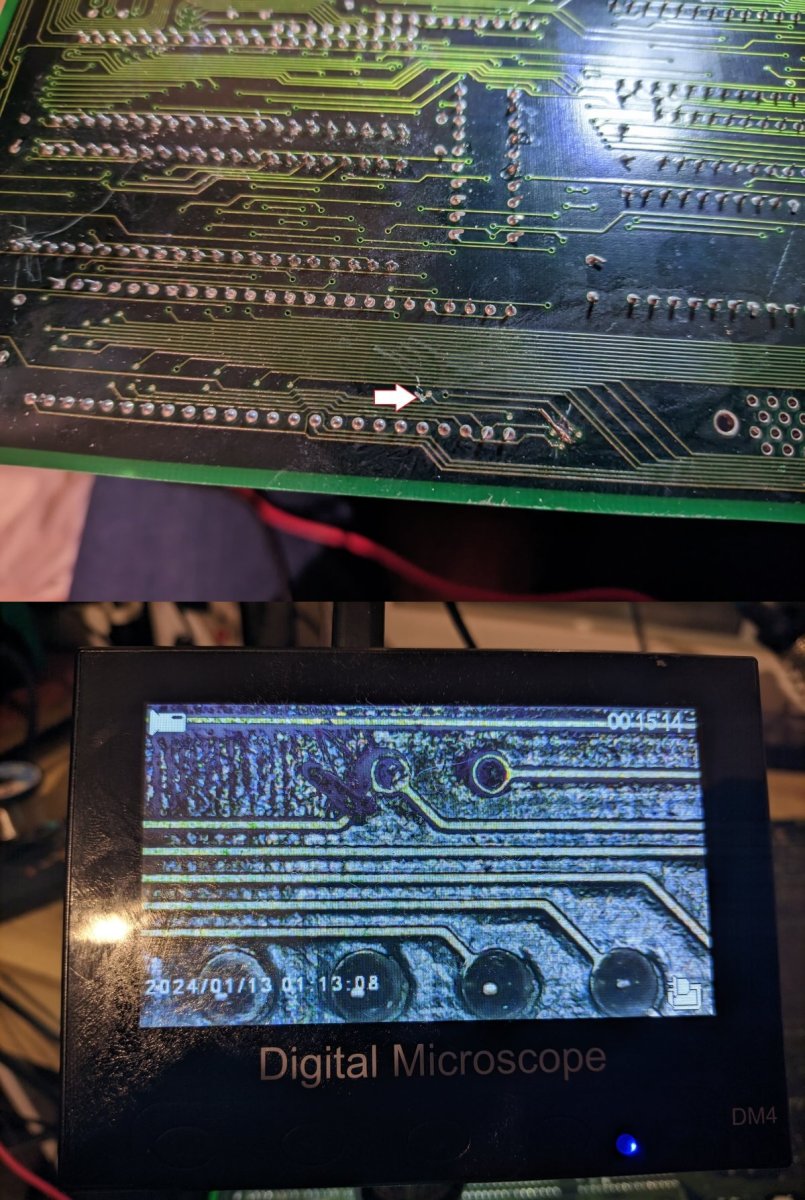

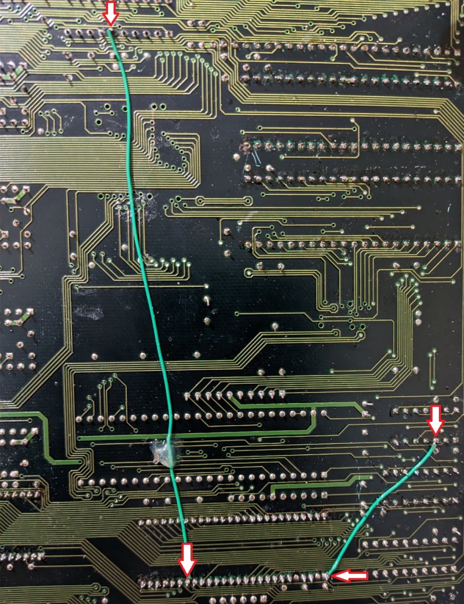

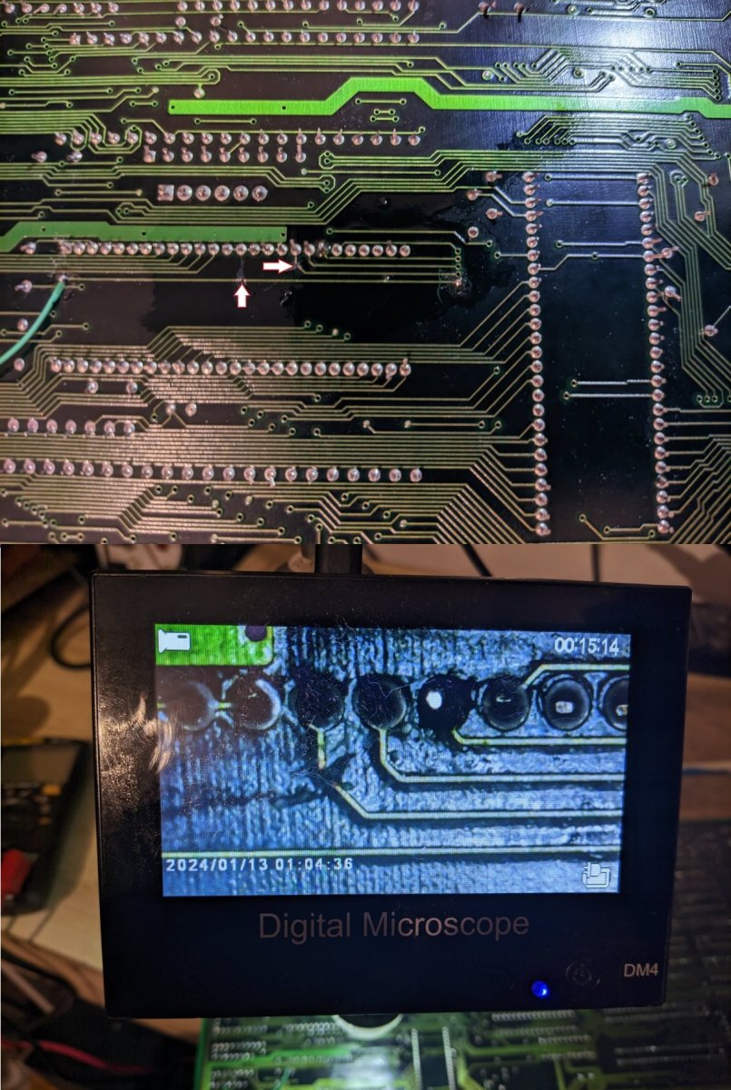

We need to focus on this zone, but its solder side
First we make 2 cuts under IC20 MB8421
Then we make one cut under IC1 OTISR2 chip
And one last thing is to make 3 join cables as seen in the photo

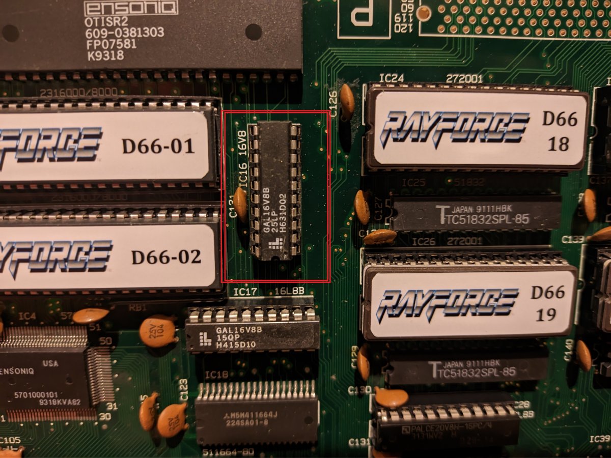

Optionally add a 221 capacitor on C3 position
Install D29-17-1 PAL on IC16:
And install the 750ohm fix resistor between pins 2 and 4.
WITH THIS, YOU WILL HAVE A FULL ENSONIQ V2 TAITO F3 MAINBOARD FOR CONVERTING ANY V2 GAME. IN THE NEXT POST, I'LL PUT WHAT YOU NEED FOR EVERY GAME TO BE DONE.

AUDIO CPU EPROMS SECTION
ORANGE IC5ORANGE IC6
GAMEWHITE IC10WHITE IC23MOTOROLA MOD +
GAL D66-09

Gunlock / Rayforce27c2001
D66-23
27c2001
D66-22
YES
