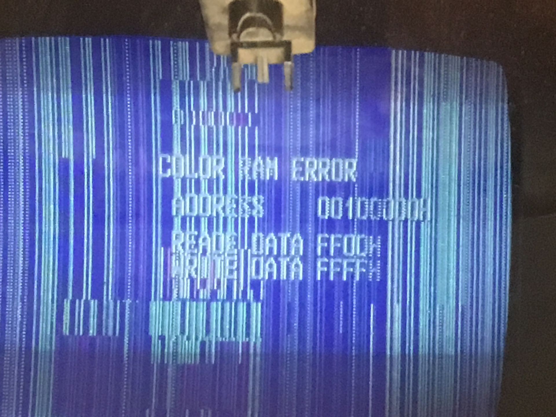

Recently purchased an Operation Thunderbolt cabinet cheap that was sold as, "It was working, but the monitor died".
Figured I would remove the CRT, put a modern display in it and move on.
Quickly realized I needed a converter board to get a display, so ordered a GBS-8220 and after a bit of messing around I got a picture.
Unfortunately the picture displays an error indicating a failure in the color ram (see attached image).
Looking at the board, it has 8x 2k static RAM chips (TMM-2018-35). I've ordered 8 replacements as they are cheap, but they are soldered to the PCB and I'm not looking forward to removing all 8.
Is there any way to tell from the memory address in the photo which chip is likely to be the culprit?
Or indeed if its likely to be the RAM at all?
PS. I know the colours are horrible on the screen, but until I can get it to boot that's way down on my list of priorities :)
Thanks.

Hmmm, the MAME source code here:
Mame Source Code
Seems to imply the color RAM is in fact the 2x 6264 chips at the other end of the board, not the 8x 6116 chips as I had originally suspected.
Can anyone confirm this?
Replacing 2 chips is a lot easier than 8...
I had a similar fault on my 1 slot NeoGeo board, some forum member where able to narrow the fault code down to which of the two 6264 failed.
But I decided to remove them both and install sockets + 2 new chips :)
The colours on the screen are messed up because your colour RAM is bad ;)
The screen is telling you which address is wrong, the MAME driver can tell you which region it is
It's either the RAM or the custom reading it, more likely the RAM. Especially if it's Sony or Toshiba.
The MAME driver has actually got all the RAM listed. That makes it easy. The colour RAM is a pair of 6264 that are right next to an RGB mixer custom.
I think Motorola calls their 8kx8 SRAM 6164, to confirm if it's compatible, Google the part code and find a datasheet with a pinout, compare it here:
http://www.citylan.it/wiki/index.php/SRAM_8k_x_8
This page also gives you a list with a lot of compatible part numbers so you can compare it there.

Ok so 0x100000:
Code:
AM_RANGE(0x100000, 0x100007) AM_DEVREADWRITE("tc0110pcr", tc0110pcr_device, word_r, step1_rbswap_word_w) /* palette */
If i'm reading it correctly, MAME seems to imply its the palette RAM.
Looks like the 6164 has the same pin out as the 6264, so I think i'll go that path.
Palette RAM is colour ram in this case so that's correct, as long as it's compatible RAM should work fine. Replace both with a matched pair

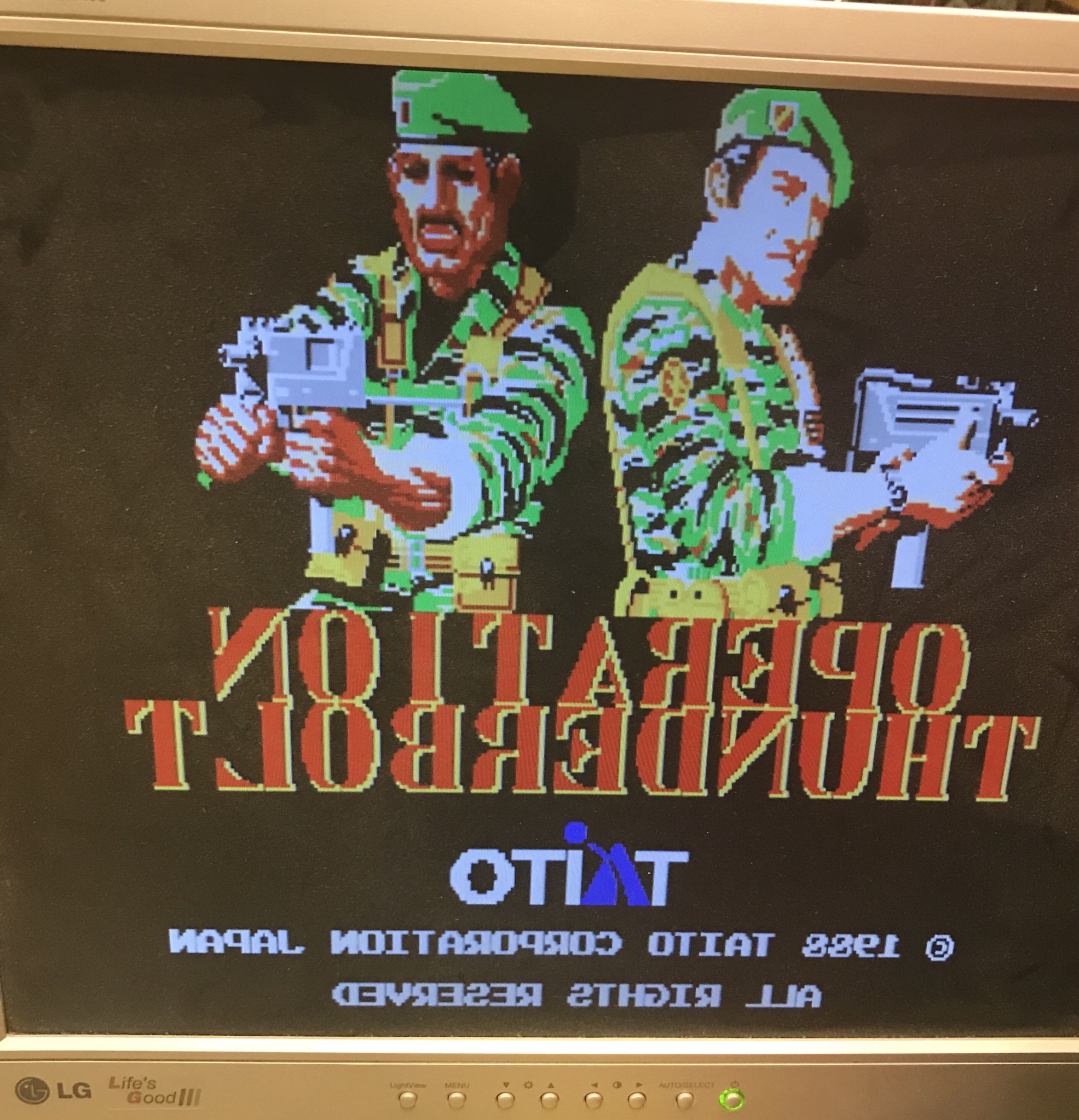

doozer brought this down today and I removed both RAM chips and replaced them with sockets he brought down with him - the board had a hefty ground plane, but we got there. I've put a pair of sockets on the board and installed a pair of Fujitsu MB8464 chips that I'm hoping are fast enough.
The board was super clean and in otherwise really great condition. Unfortunately the board doesn't use a JAMMA pinout and while the power connectors are in the correct places, the video pins are much further down the edge connector (pins 21/22 as opposed to 12/13)

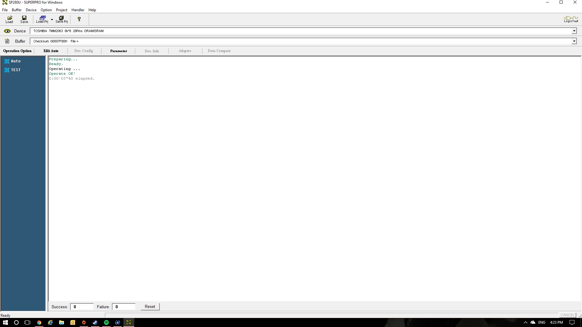

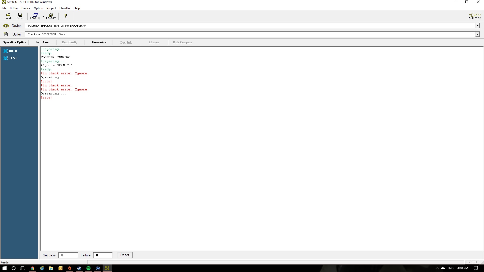

I tested the RAM I removed from the board (Toshiba TMM2063) and this was the result:
RAM IC 1: Pins 05, 07, 26 and 27 not registering
RAM IC 2: Pin 05 not registering
I ignored the errors on both to see if we could get any kind of testing done. IC1 failed miserably and just errored out, IC2 failed about 50% of the way through the RAM test:
This is the same test performed on the MB8464 ICs I replaced them with to show what should happen on working RAM chips:
doozer is on his way back home now (I'm about 45 mins south) - so hopefully when he connects it up it's all systems go, otherwise I will be up there next week and I have offered to try to fix any other issues that arise.

Paradox pulled the ram chips and tested them one at a time until we found the dead ones.
Most half decent programmers these days have a test function built in.
The colour RAM is a pair of 6264 (Toshiba TMM2063 in this case) which from memory was on the top right corner of the board.
They're easily available, you need 100ns or faster. I replaced these with a pair of Fujitsu branded chips - MB8464

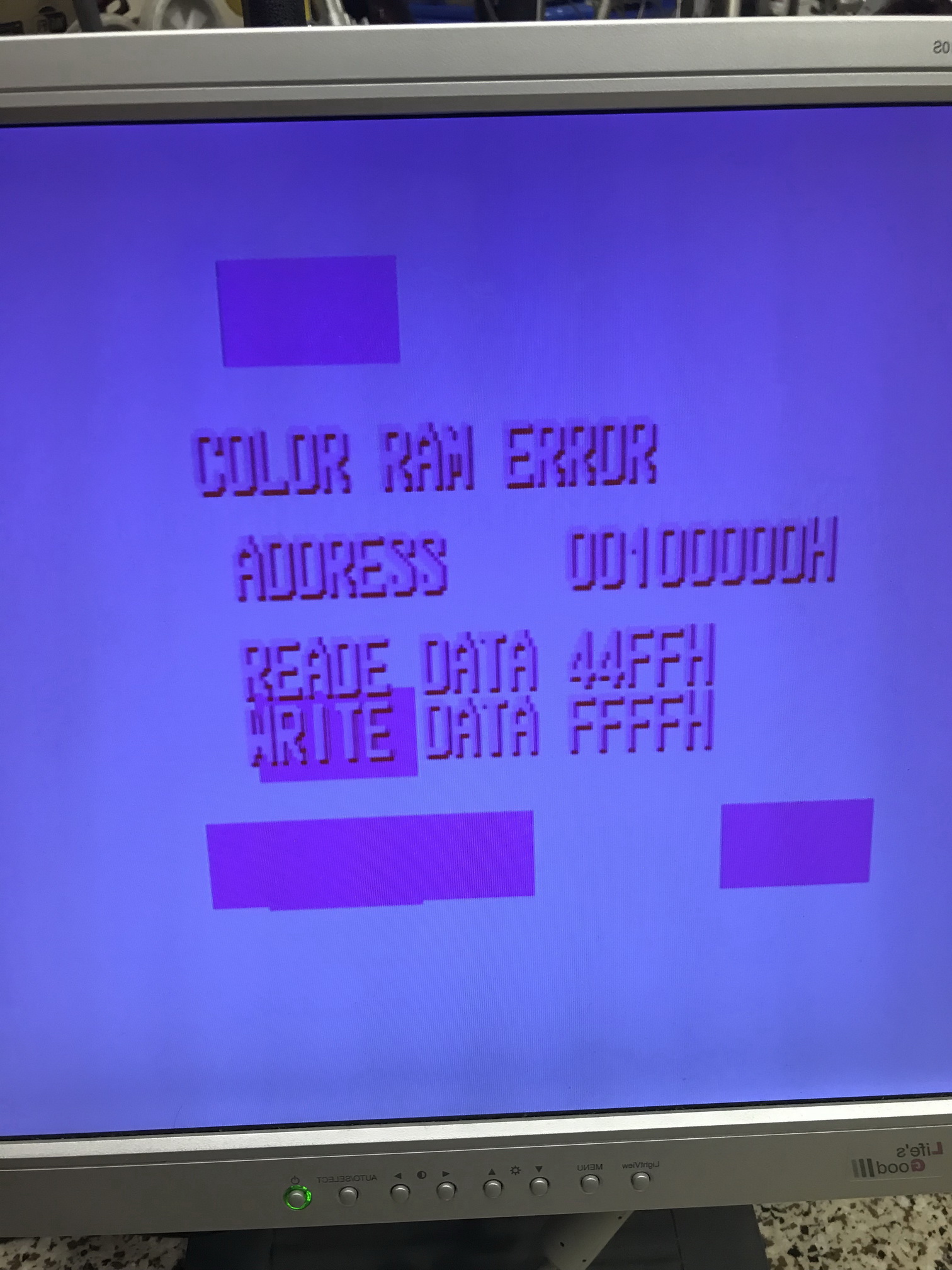

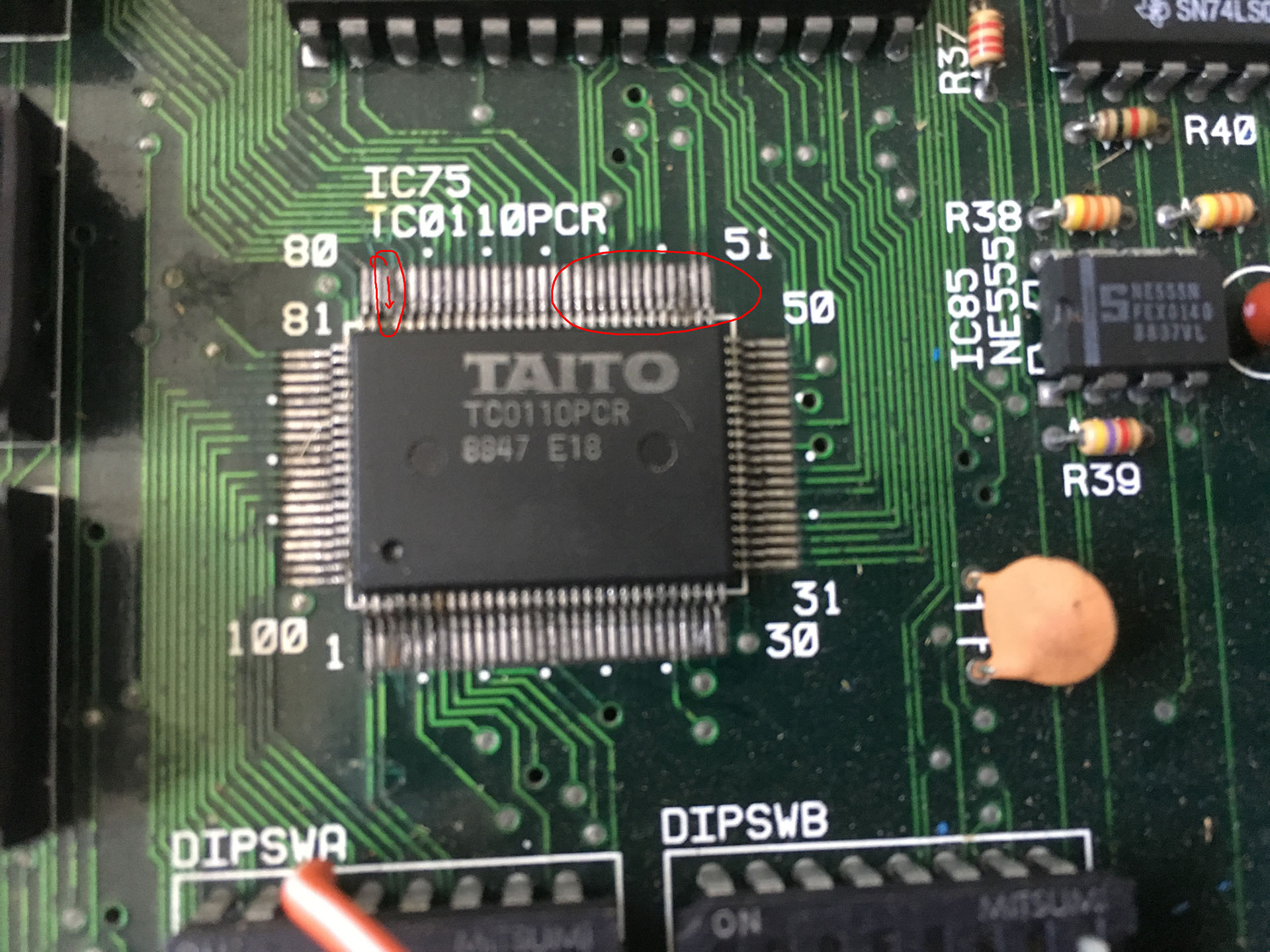

Secondly I have attached a screenshot of the error code and one of the Custom TC0110PCR IC.

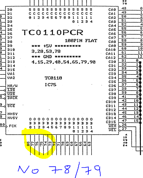

In the IC pic the red marking on the left, there appears to be a leg missing at pin 78, the "pad" is also showing continuity to pin 79, so Im assuming maybe someones had a crack already and stuffed it, that or it isnt needed to be connected to anything (doubtful of course) also the error message is quite garbled until I put pressure with a moistened figertip on the area marked to the right of the image.
I'm starting to think maybe this custom is what is stuffed, im happy to reflow and try but am I wasting my time here do you think, I assume you cant purchase these anymore, would need to salvage of another board.
Thanks again for getting back to me, I've gone from completly dead to this now, so progress is progress and I am enjoying it.

Finally found some schematics, looks like 78/79 arent is use so maybe some hope after all.
Checked continuity on that right side and most are fine, just cant find a spot to test 3 of the pins, so Im assuming it may be alright for now if I am reading this right.

Fairly sure that custom is a sprite generator custom, the RGB custom is a TC0070RGB right next to those colour RAMs
Those Fujitsu RAM are exactly what you need and exactly what I installed on doozer’s board. I recommend socketing them in case they die again in the future
