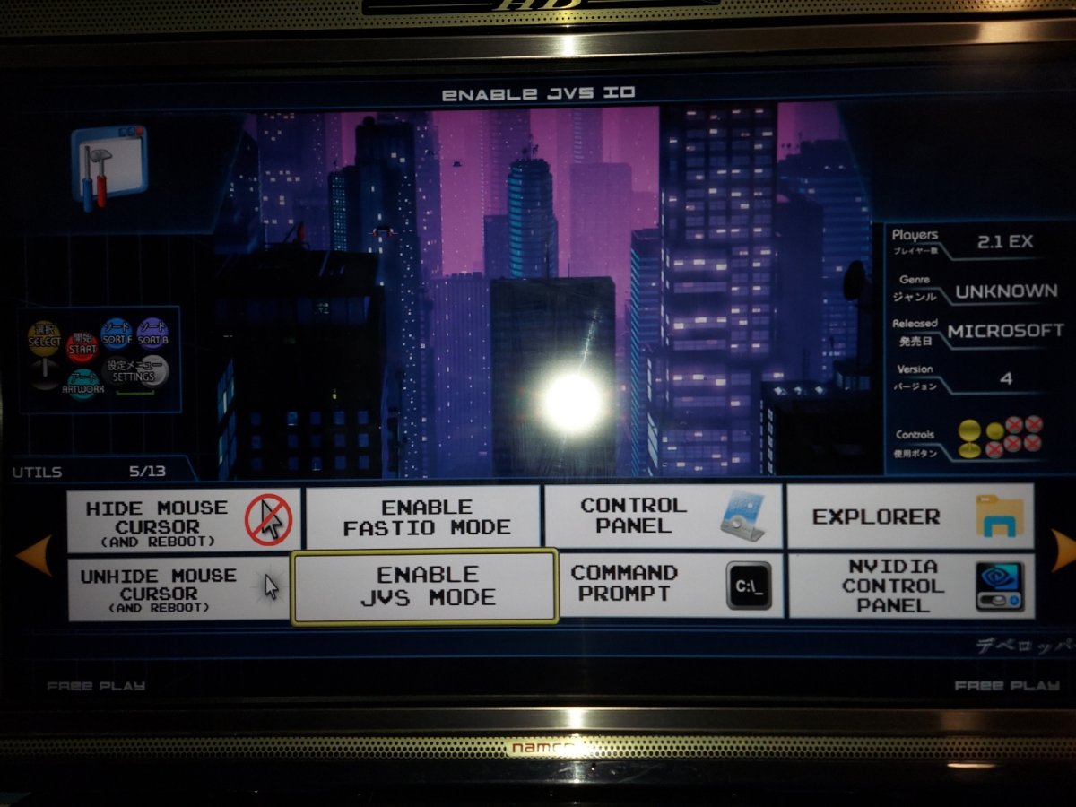

Hi yo players, I'm new to the namco nior blue and taito type x3, I got it in and hook up to what I think is correct, however the control panel is not responding, joystick dosent bring joy and buttons don't do anything not sure what I did wrong, I plug in the USB cable to the jvs output but nothing. Audio and video seems to be working fine, any tips or tricks to make it work
Thank you for your time

Ok so I talk to @davesarcades and he help me out, so you plug in a keyboard to one of the USB ports. Hit the E key to navigate to the settings menu and select enable JVS. Taito will reboot and start working with the namco i/o.
Thanks for all the help 🙏
