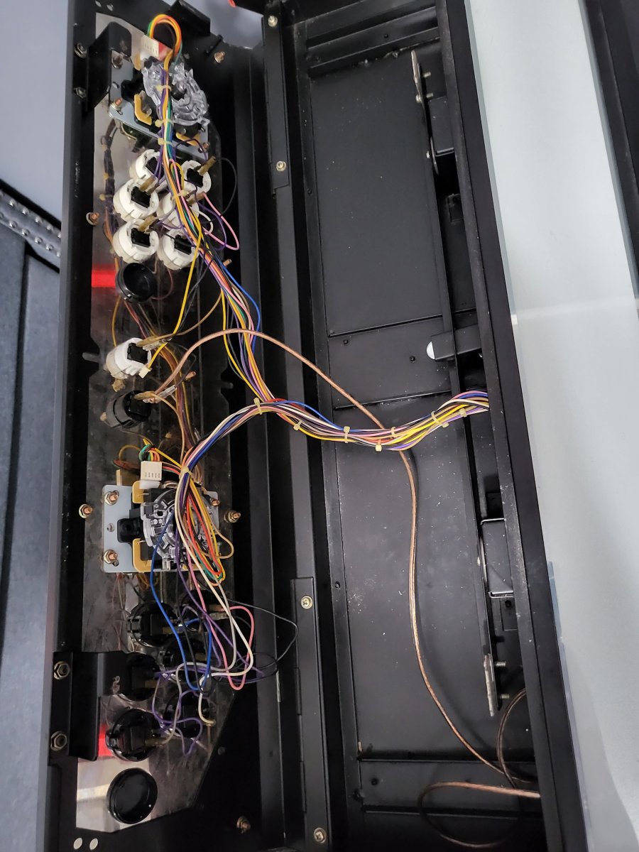

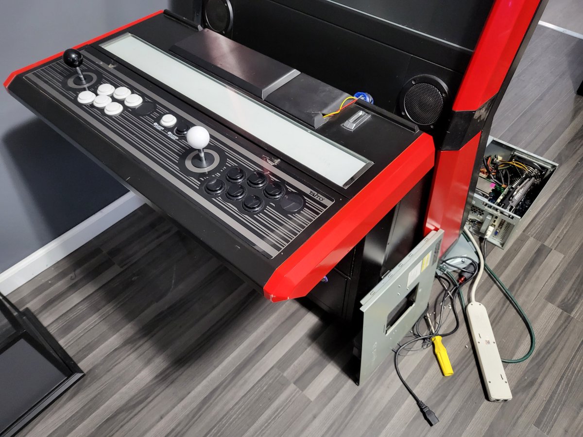

I need remplacement the pandora with the ttx3 i already own is because i need the fastio/jvs because i dont have any , with the iona can connect these sticks and buttons using a ps3 xbox etc etx adapter to usb? I dont wanna use the regular controllers ps3 xbox etc etc.

It looks like your cab is wired for JAMMA which then goes into a 60 pin JST harness adapter.

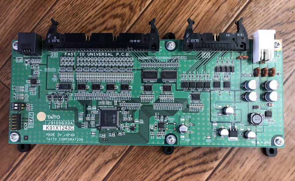

You should pick up a Fast I/O like the K91X1243C. It'll allow you to plug in your 60 pin harness easily, supports 6 buttons per player, and gives you the lowest latency on a TTX3. Just plug your 60 pin JST harness that's currently going into the Pandora into this instead, then run an Ethernet line from the Ethernet jack on the amp board to the Fast IO port on the TTX3.
