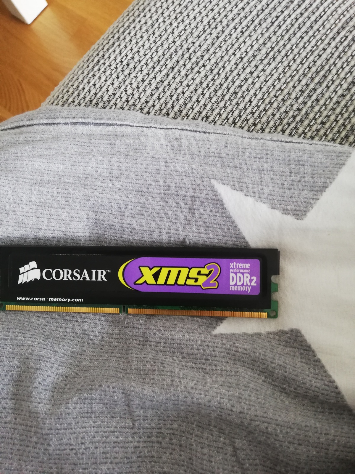

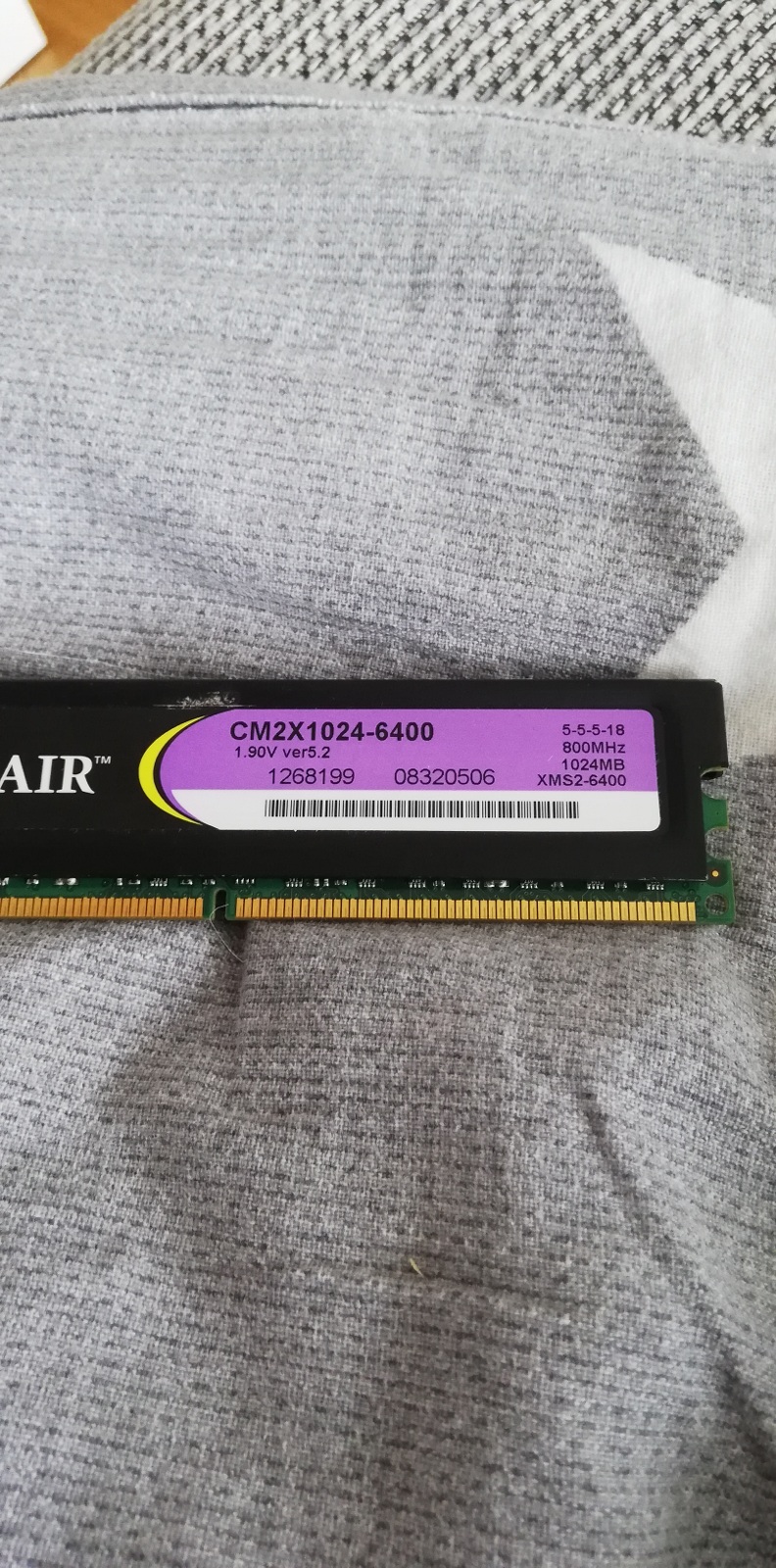

I want to upgrade my ram 512 mb
Tried 2 of those.
But not working. When starting x2 theres only "no signal"?

First time i started it up i heard some neeps actually. But not the second time i tried.
It works.
I had 4 of those.
And 1 was bad.
Thank you for your super fast help.
