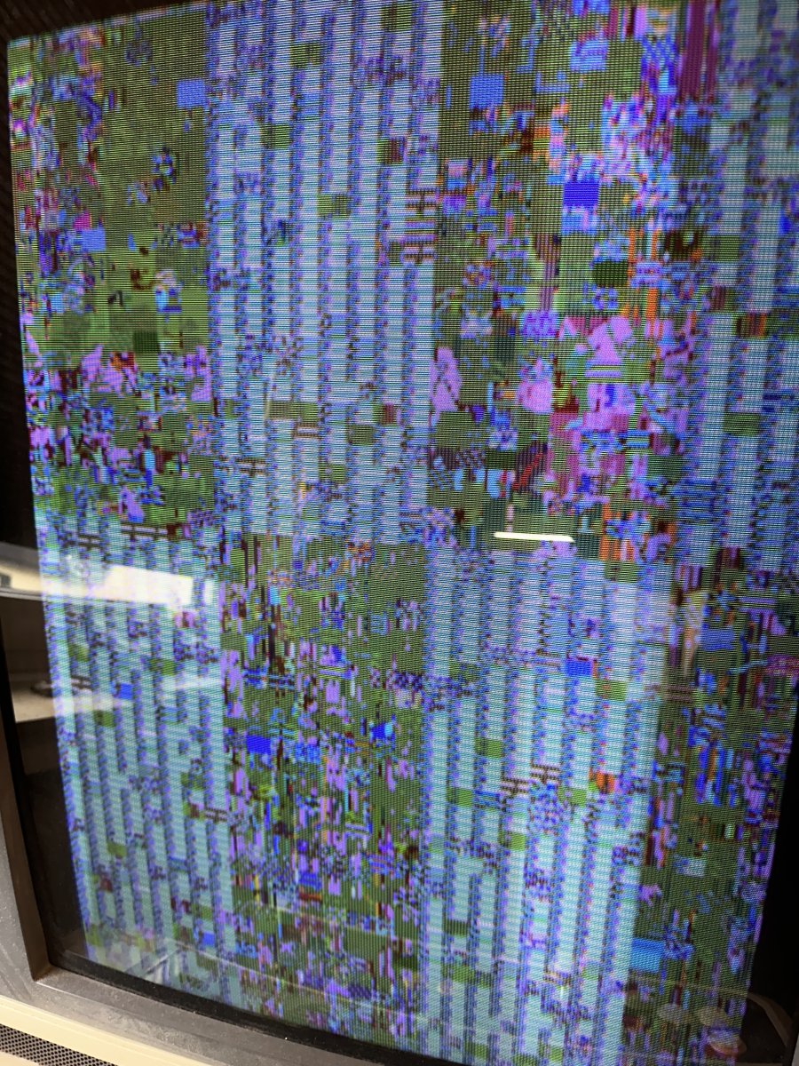

I have a Gladiator cart here which just shows the following output:

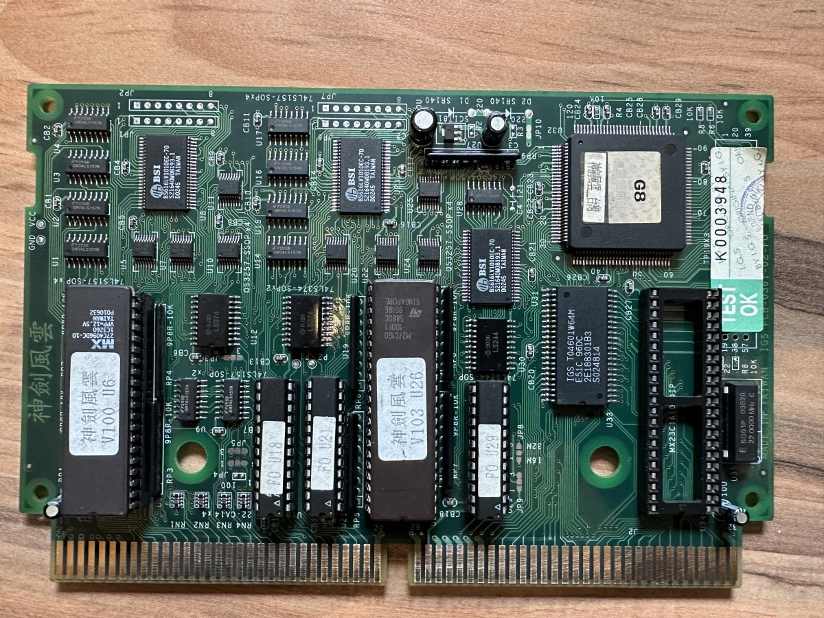

Pictures of the PCBs here:
Visually I don't see any components missing when comparing the photos to the PCB scans available.
I already removed and inserted the EPROMs but that did not change the video output.
Anything I can try to fix it?
I'd dump the program EPROM (U6 I guess?) and compare it with a version from MAME.

Looking at the "theglad.zip" my u26 version v103 EPROM seems to be missing from MAME.
Or is the u26 corrupt and I just dont see the file in the zip?
Anything I can try now? Should I update the EPROMs to their latest versions? U6 v101 and U26 v107?
If you have suitable EPROMs laying around I'd just try burning fresh ones. The other option is that one of the GAL is toast, but I don't think we have dumps of them.
