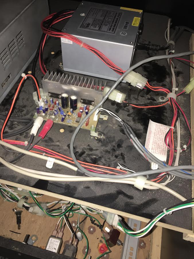

Ok. I went and bought a new set of bits and was able to get the back panel off and get some pictures.

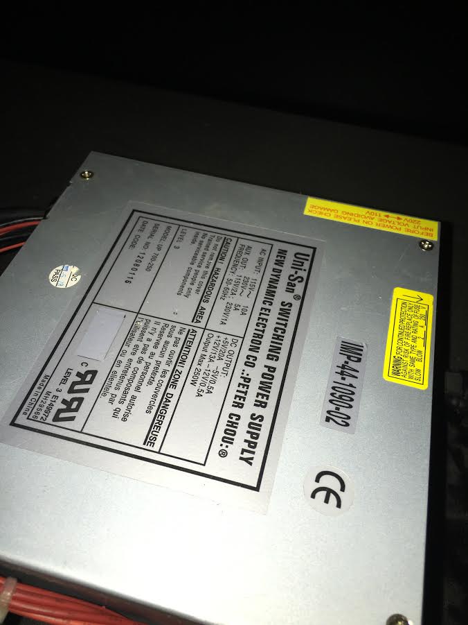

Thats the accurate PSU, and a normal 246 system with cdrom. Same thing that's been in EVERY TC3 i've ever worked on.
If thats the "weird one"...what's the one thats normal looking?
On that PSU, Red should be 5v, Orange 12v and Black is ground.
To measure voltage at board(6pin connector to main pcb)...put one lead on black , and the other on orange, and double check voltages...then do the same for black to red.
12v should be between 11.5-12.5, and 5v should be between 4.9 and 5.15/5.2 at the highest.
If its not that, or you still arent seeing a boot, report back.
Also, that little pcb is just the sound amp hence the Red and White RCA's and runs on the 12v rail.
Let us know what you find!

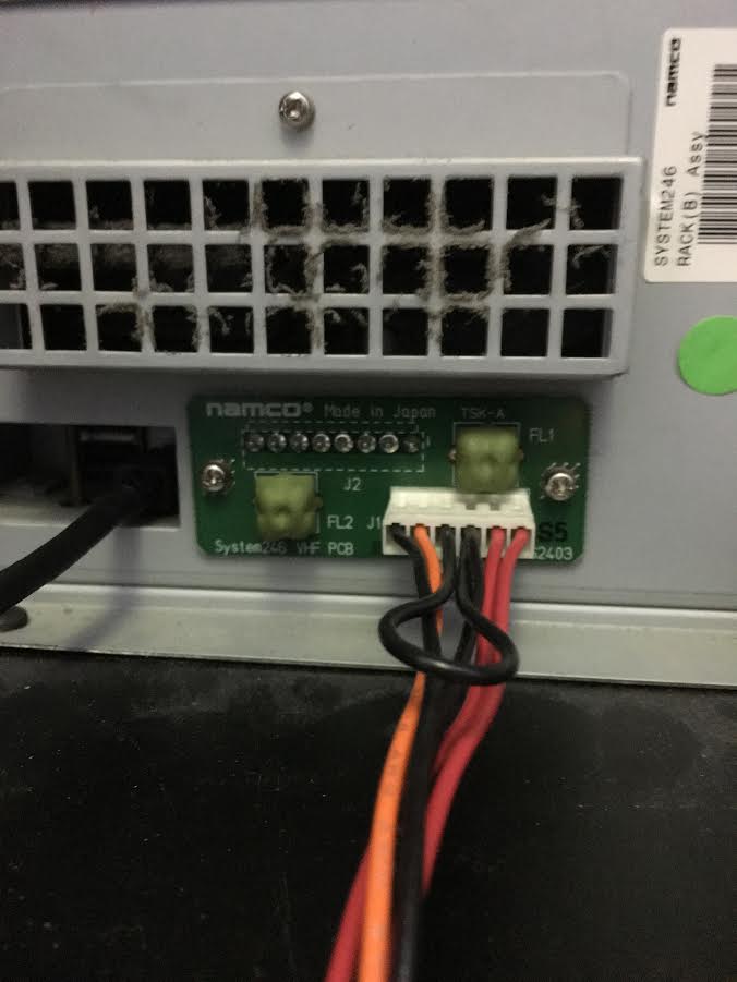

You never actually showed us photos of the board you said was different? I was still waiting on that for further directions.....
Also, on the PSU inside TC3, Its 5v RED, and 12v ORANGE, same as the power connector on the front of the 246....important distinction.

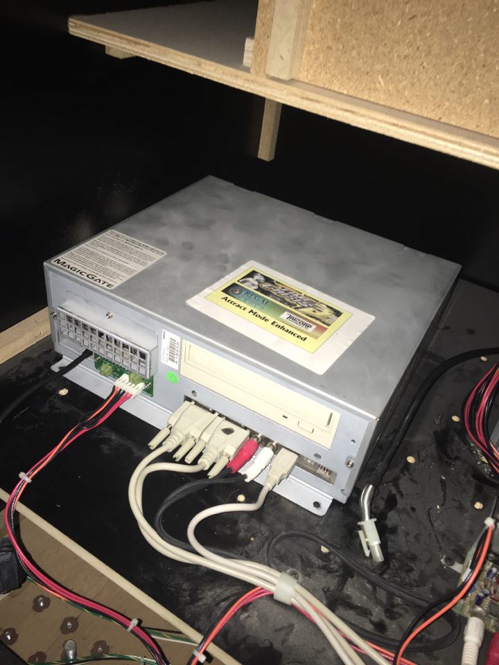

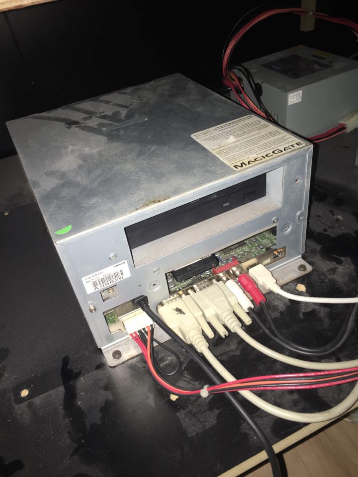

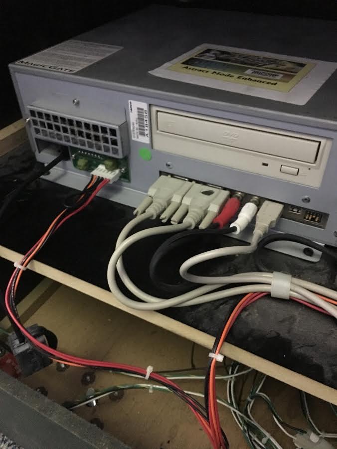

Ok, so here are the 2 boards side by side. I just noticed that I am retarded, and one is a 246 and the other is a different revision. Learning things all the time.
