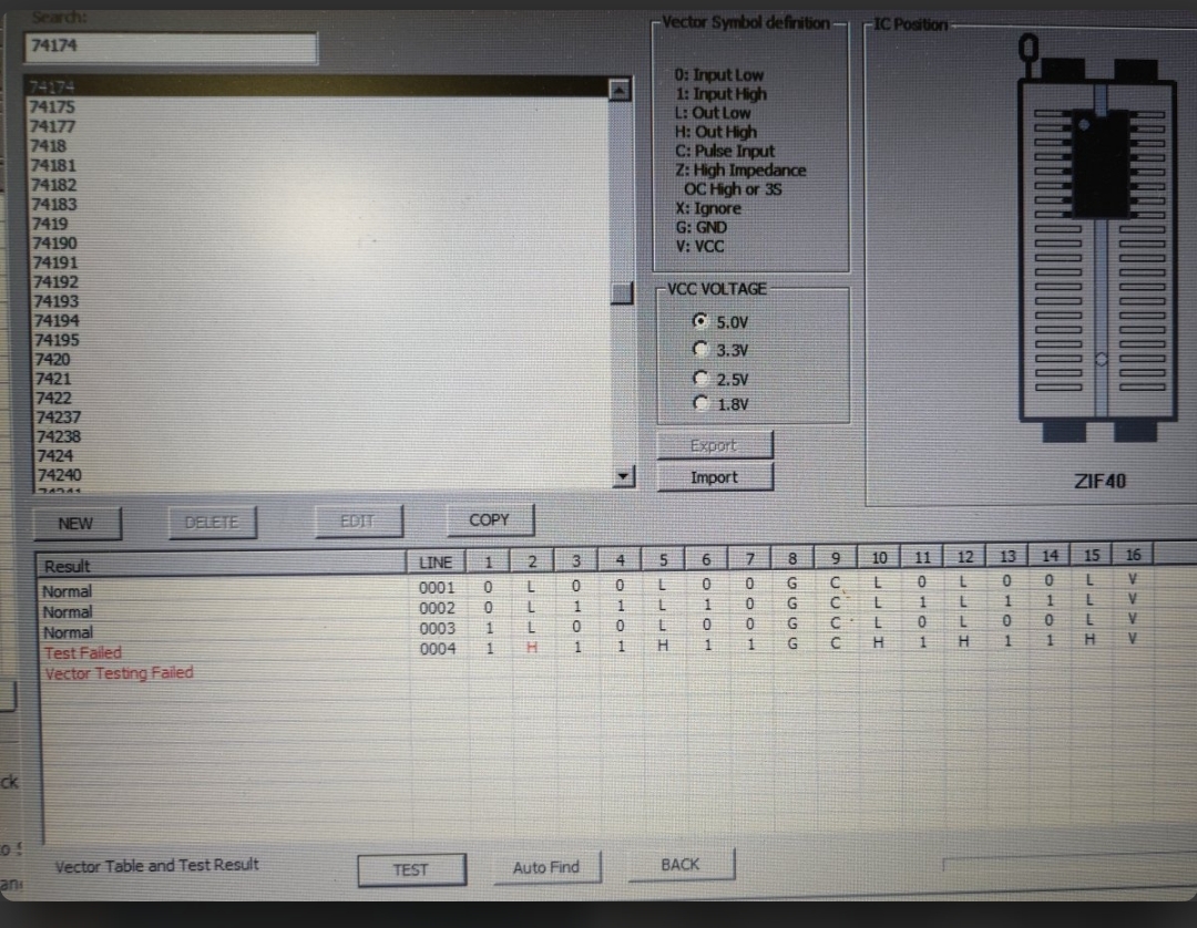

I checked all 6264 rams D0-D7 pins are connected to the FCB costum chip. I checked the 6264 rams A0-A12 pins are connected to several logic chips. I checked A17, 74ALS174 Ic which is faulty. I replaced it, but I only have 74ls174 ic at home. no changes were made, the error remained. I know that the ALS has a faster speed than the LS. I noticed in the schematic that pin 1 (CLR) is connected to vcc, which the pcb is not. I connected it but unfortunately nothing changed.

Well done finding the faulty 74ALS174. I would be very surprised if a 74LS174 wouldn't work in its place, as these boards generally do not run anywhere near the speed that an LS is capable of.
All I can suggest is to continue doing what your doing to find the remaining faults. Good luck!
