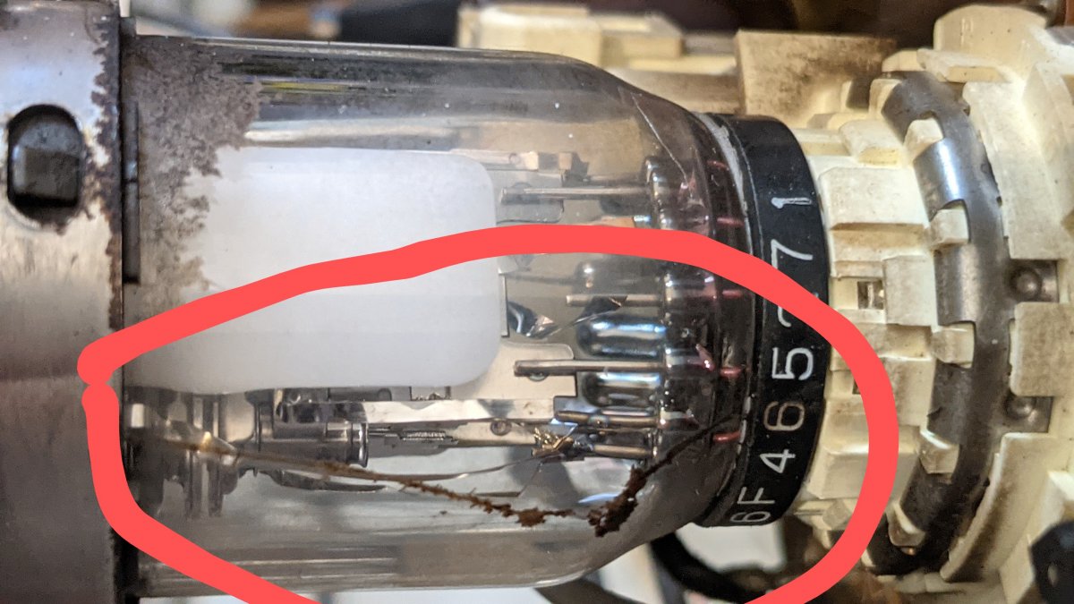

Recently I picked up a New Net City with Toshiba Pure Flat D29C051 monitor. I tested it and it worked fine but the contrast of red color is kind of more dominant than other colors. I guess it's a matter of adjusting red color contrast. After I opened the monitor case, I have these questions:
- The brown mark on tube area near the neck board (I red circled the area on 2nd picture). Can this cause issue to the monitor? I tried to wipe it off with isopropyl alcohol but it didn't go away. Not sure what it is.
Looks like glue. Don't worry about it.

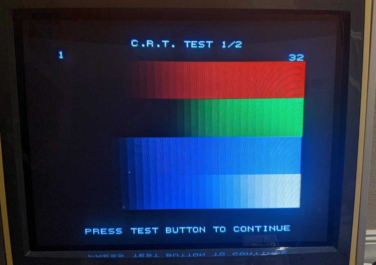

I finally got the machine assembled back after full cleaning. During cleaning I moved the magnet rings and the picture became kind of blurry or convergence needs to be adjusted. So I adjusted the rings, geometry, red cutoff and etc (I have no idea what I was doing. I need to learn more about magnet rings adjustment for this type of monitor). End result, what shown on pictures are the best result I can get. For geometry, I couldn't get the top to align well horizontally. For color, I think the character when I played Street Fighter Zero 3 like Ryu, the color skin was a bit red. Not sure if putting back the missing metal piece and adjust the magnet rings correctly will solve these issues.
Top left corner is due to the magnet you're missing. It does seem to affect geometry quite a lot. If you have any magnets around the house, you could see if you can replace it with something else. Alternatively, scavenge one from a CRT that's headed to the tip.
Your green cut off is off. Turn that up.
This is great if putting back the missing magnet will fix the geometry issue. I don't have any magnets with the same size at home but I'll try to find one. I'll also try to adjust the green cut off.
