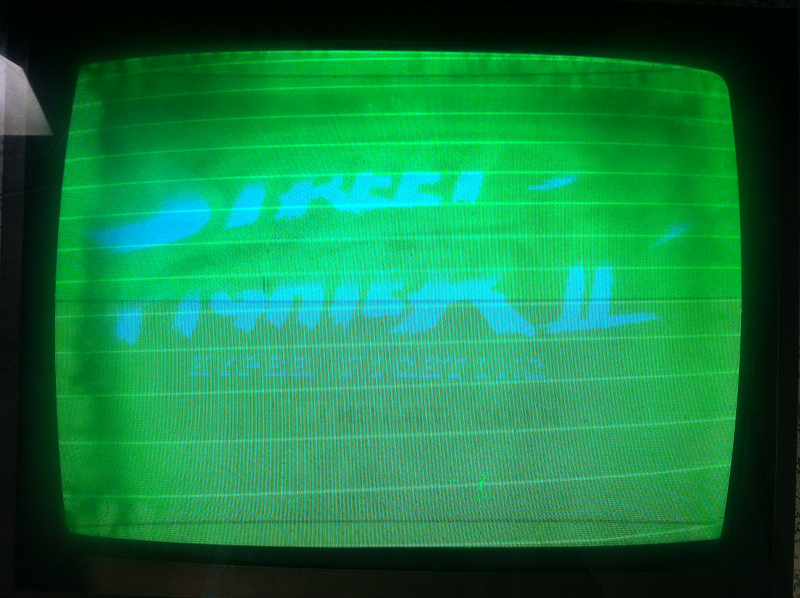

Thanks for the info. My monitor had the retrace lines like the photo. I fix that( turned the screen pot down a bit). Now it's a little blurry. Any info on that would be helpful. :thumbsup:
Sorry for the noob question I found it. It's the focus knob on the flyback right?
