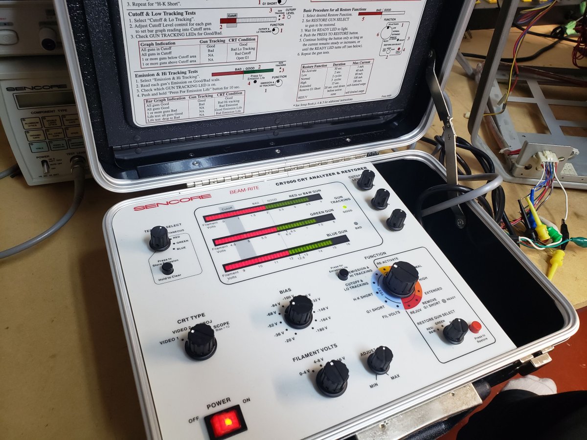

I have checked it out and the tube seems to get a "GOOD" test result for cutoff, low/high tracking, and emissions. Here are the settings I used for anyone curious.
Hello there you will want to glance through the cr7000 manual. Those emissions are in the "bad". You will want to look closer to this:

I went through all the test steps again, making sure to get the filament voltage right this time, and my green gun was the one that was in the "bad" region, for emissions. After performing a couple of "reactivate" functions, I did not see any improvement. Then I did the low repair option (again, only on the green gun). This made things significantly worse, unfortunately. It fixed the emissions on the green gun, but now my green gun fails the test for low cutoff, for gun tracking, and for G1 short. After going back to do the G1 short repair on the green gun, that seems to have fixed it somewhat (though not nearly as good as it was) and the low cutoff and gun tracking are still broken.

Hey y'all. I did some more work on it earlier with the Sencore and it actually is in a much better place. It did not work miracles--the gun tracking still checks "bad" on both Low and High cutoff tests. But the cutoff actually does work on the green gun, now, and emissions are in the "good" range for everything. Furthermore, the monitor is most definitely brighter in-game, and looks better than it did when I started. So things are much improved. I am actually interested to recap, too, at this point.
With bad emissions youre on life support. Sometimes you can recover it. But might last 3-6 months. Less or more. Caps wont help at this point as you know.
