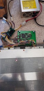

I took the gamble, made a cable and plugged it in to the monitor. Nothing went up in smoke but the screen kept displaying "no input detected" (other than a flicker when I powered up THOTD). I guess it's not surprising as when I looked at the sync signal with an oscilloscope it just showed a constant voltage, no signal.

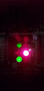

When I turn it on there are 8 LEDs next to each other that light up momentarily, then the 4 red ones on the right are lit, then just one up from bottom right stays lit. There's a green one bottom left which seems to vary in brightness. I can't find anything in the manual that say what these mean.
Can anyone shed some light on what I haven't done correctly? Should CN3 and CN4 on the little board (third picture bottom right) be connected to anything?

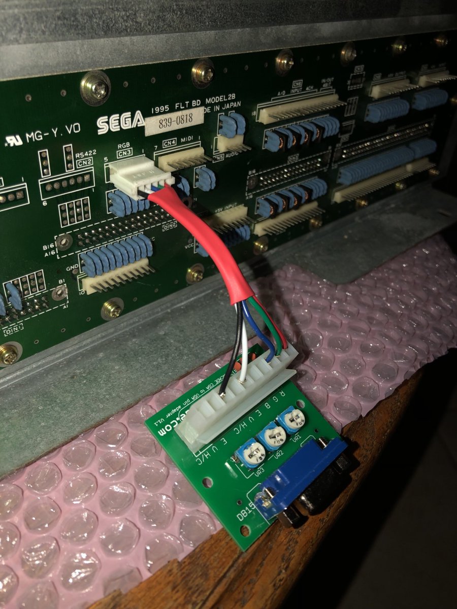

The TTL here looks like a Molex Series KK 10 pin. I should know because I recently built one of these for a CGA to VGA adapter (not converter) for my Model2b, which uses the same filter board:
I could probably build you one of these cables if you wanted at whatever length you specify unless you think you could do it yourself.
EDIT: Ah, you've got a special cable with a ferrite ring I see. I can't see what's at the end of your cable, but you could always chop off whatever connector you have and add these pins into the housing I linked in the same configuration I've got in my example and you should be golden.

Out of interest on your picture- are you using variable resistors to take the ~5V down to a vga friendly 0.7V?
I use this Mikesarcade adapter and feed the VGA to an Extron DVS 304 or an Extron RGB-HDMI 300 A scaler, which I'm assuming does the heavy lifting.
The variable resistors I believe are just color adjustment pots. The first time I made an adapter I used a straight DB15 adapter which caused color issues in the picture, so I can't assume voltage conversion is done by this. Though there are tiny ceramic caps on the R,G,B traces which tie to gnd on the Mike adapter.

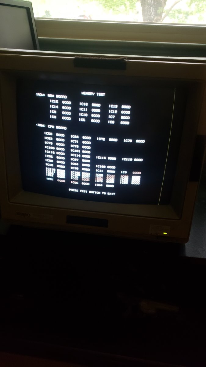

I did a further test of my HotD ROM Board and it passes all the ROM tests which surprised me considering the whole board was gross when I got it. Sound works fantastic also, as this game in its current emulation suffers from poor SCSP emulation of the Model 2A/B/C (Side story: I ported MAME's SCSP code to Supermodel and fixed quite a few problems).

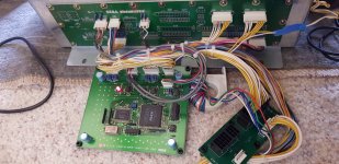

Also finding out if there are any console light guns that could be modified to play the game. I couldn't get my Master System Light Phaser to track or calibrate in the test menu, but it's possibly a multitude of things -- either I have a broken gun or I'd need to modify it further to get them to actually track by putting the original gun sense board. I've heard of other Model 2 users converting the Saturn Stunner to play it. I reckon it's just a matter of connecting VCC, Trigger, Sensor and GND, modifying the cable slightly, and wiring them to the gun IO and filter board with the appropriate NH connectors. Has anybody tried that?

Yeah the memory test shows the last scene that was loaded before the operator entered the test menu.
