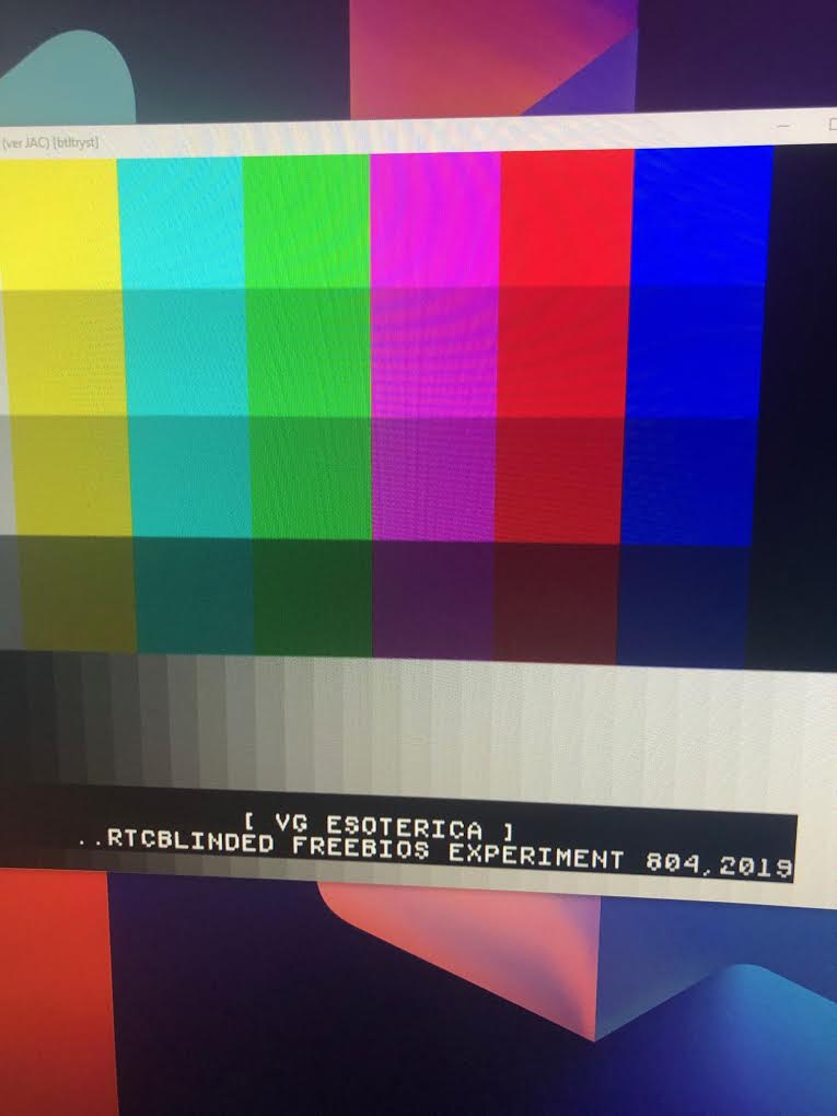

Luckily testing through MAME is a pretty rapid solution to prototyping a new bios. Unfortunately it tells me more when I broke things and caused a hardware failure than a success! So much of the code is obfuscated. I need to try to decompile things in a PowerPC decompiler to see if I can identify more of the underlying code.
In the meantime it's running a "hello world" esque splash screen lol
