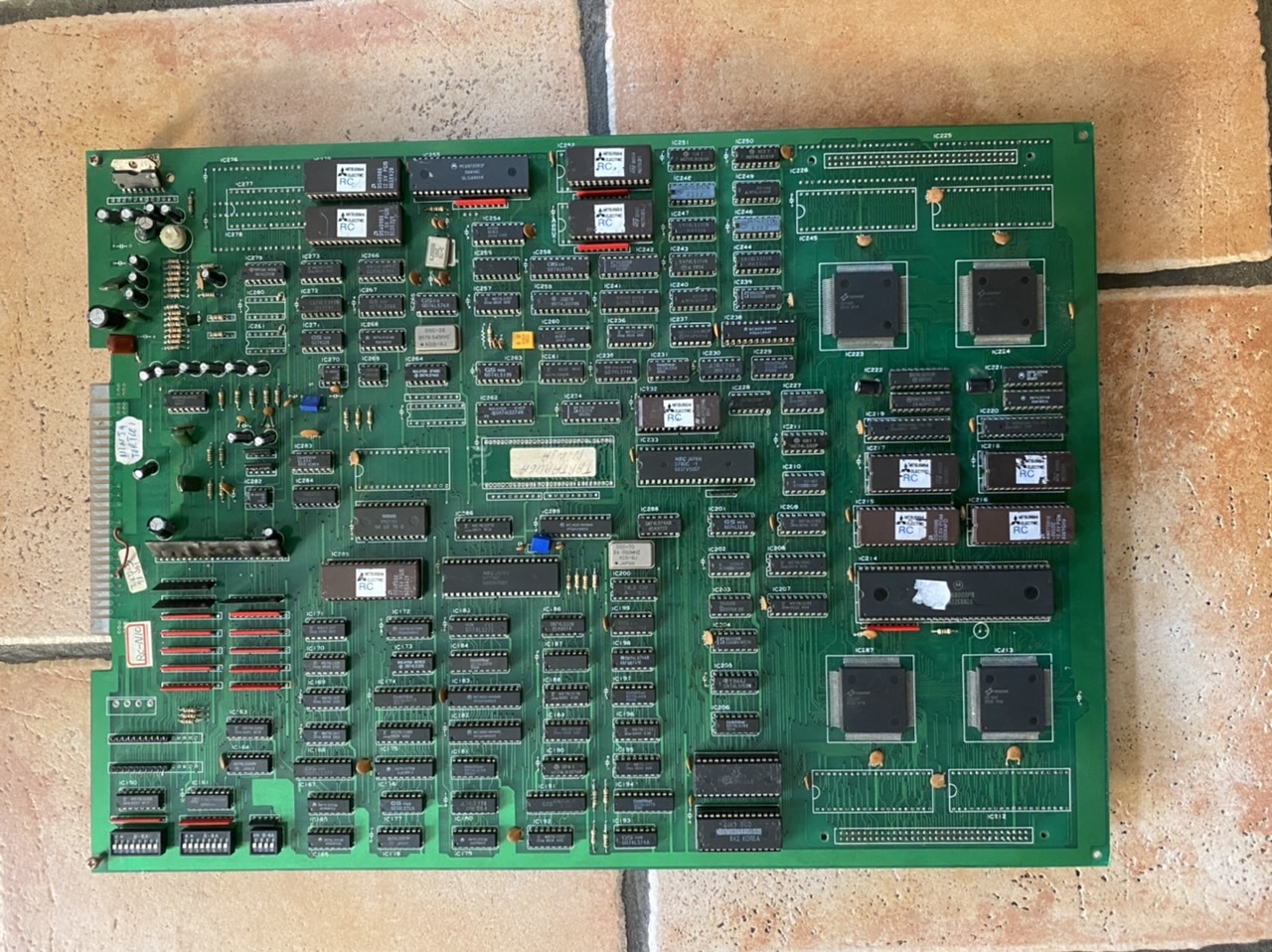

Hi Everyone,
I'm a bit of a newbie when it comes to repair, I'm going to try and get one working board out of two duds anyway (I managed to bring an Amiga A2000 back using this method), I have plenty of time at the moment.

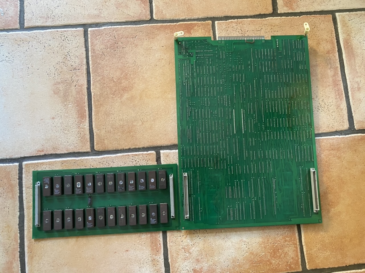

These bootlegs are using Konami customs and have an another PCB underneath with lots of ROMs on them. Has anyone seen a schematic for these bootlegs? I'm thinking that because these have the Konami customs maybe the schematics are similar, I'm just comparing an image of a genuine, and in some ways the genuine looks like a much more compact version of the bootleg?
The "first" board has nearly all the IC's and looks the best so I will give that a clean with IPA and then I will move all the missing IC's to this one and making a list of what I need to buy to fully populate the board.
Once I get the parts it's on to phase 2.
Any info on the origins of these boards or relevant repair tips will be much appreciated.
Cheers
Richard

Missing bits may not actually be missing bits. Pretty common for boots to be reworked to use minimal components as a cost saving measure.
Both boards seem to be the same, definitely bits missing on both, for example the better board is missing a big DIP IC in the centre and a resistor ladder next to it, the the other board has those. It seems highly likely both boards have been used for spares.

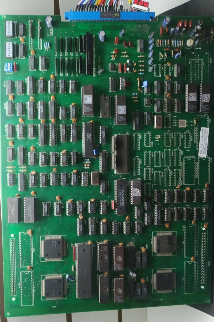

The attached photo is a working one for sale on Ebay.
@Frank_fjs the worse board is pretty similar to this one, maybe as you say there is a rework in the centre right of the board that removes nearly 20 IC's that doesn't sound right though, maybe all those IC's are multiplexors for the player 3 & 4 inputs...
