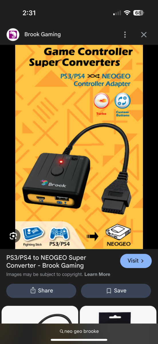

Yea I did. You need the 2 products shown below.
So you basically need to add an extra wire into your cabinet buttons then send it to the db15 breakaway connector into the correct spot. You then connect the brook neo geo converter into it and the usb port works with your arcade sticks. You do need to update the firmware on the converter to support more than 4 buttons but it works on my end.
