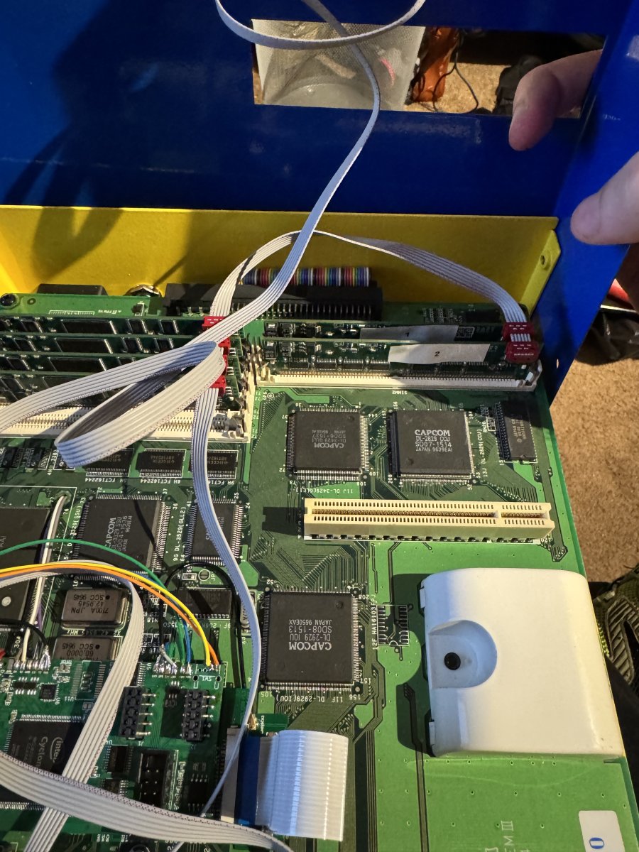

I itman312 Student Joined Jul 29, 2020 Messages 55 Reaction score 17 Location USA Jan 14, 2025 #1 I had a working Darksoft setup for my CPS3 but I recently decided to upgrade to the UltraSIMM setup. All the memory units appear to be correctly seated and in the right locations, but it's saying I don't have enough memory. What could the issue be? Attachments IMG_5447.jpeg 239.6 KB · Views: 51 IMG_5446.jpeg 145.3 KB · Views: 53

nem Immortal Joined May 29, 2016 Messages 7,701 Reaction score 8,413 Location Finland Jan 14, 2025 #2 Is your cart on UltraBIOS? SuperBIOS was the one before. It does not support Ultrasimms.
I itman312 Student Joined Jul 29, 2020 Messages 55 Reaction score 17 Location USA Jan 14, 2025 #3 nem said: Is your cart on UltraBIOS? SuperBIOS was the one before. It does not support Ultrasimms. Click to expand... I have no idea. How can I determine that?
Darksoft Staff member Immortal Joined Jun 12, 2015 Messages 12,430 Reaction score 18,754 Location Poland Jan 14, 2025 #4 Probably you have the old SuperBIOS. You can find the new version that supports Ultrasimms here: https://www.arcade-projects.com/threads/cps-iii-bios-and-cd-releases.36/ or you can contact @Mitsurugi-w and he can update it for you.
Mitsurugi-w Arcade Admini-Moderator Staff member Immortal Joined Jun 12, 2015 Messages 8,233 Reaction score 11,087 Location New Bern, NC USA Jan 15, 2025 #5 Stupid question but you did program the simms?
