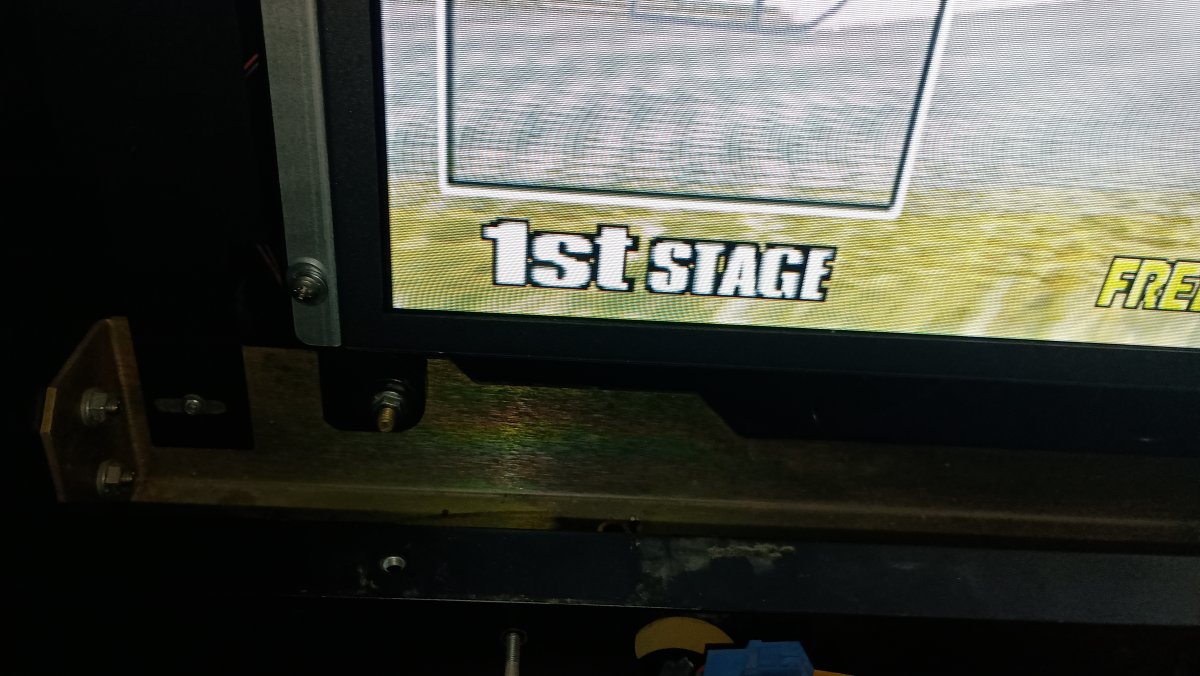

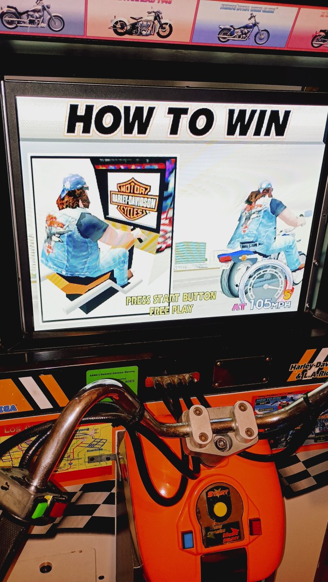

I can confirm these fit a Nanao MS9 frame.
I got the brackets 3D printed using prototyping PLA filament, and while a couple of the mounting holes were not perfectly printed, the Unico still mounted in there nice and snug using the 8 M4 bolts with washers and nuts.
Here is the ULM26 installed in my Harley Davidson machine with them in the attached pictures. I even used one original nut and one original washer from the Nanao tube, on each of the 4 corners, so the screen doesn't fall. Next I need to fill the voids of the bezel so no exposed monitor parts stick out.
You literally saved my thumb from being potentially sliced using power tools. Thank you Mattsoft!
If I were operating this on location, I would make sure to layer in a sheet of glass or a screen protector to prevent kids from banging on the Unico. But for home use this is more than sturdy and I can't thank you enough for your hard work. ;)
While the refresh rate of the Unico is not quite as buttery as the CRT, I have to appreciate what it delivers in bringing the proper aspect ratio and vibrant colors.
