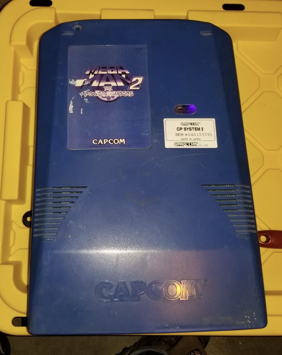

Hi :)
Three days ago I received this MegaMan 2 The Power Fighters I purchased from a seller on KLOV. I still don’t have a lot of experience with cleaning arcade boards so I want to know how I cleaning it. The board still has original seals on the back and the seller sold it working. I haven’t tested it myself yet but I am going to a friends soon to test the board. I’m sure it has a battery in it so I’m thinking I’ll put an Infinikey in instead, once I can find one.

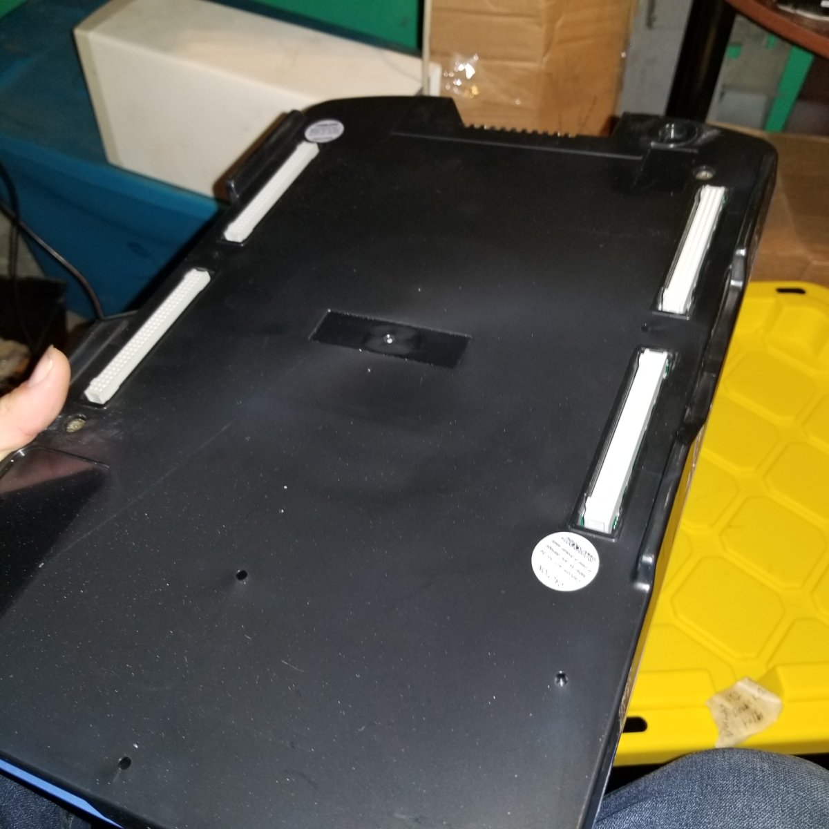

How should I clean the case? Also, I’m going to need to take the seals off the back to look inside. I will do this after I test it, just in case there are any issues with the board, I can contact the seller again and show him that I haven’t touched anything yet.

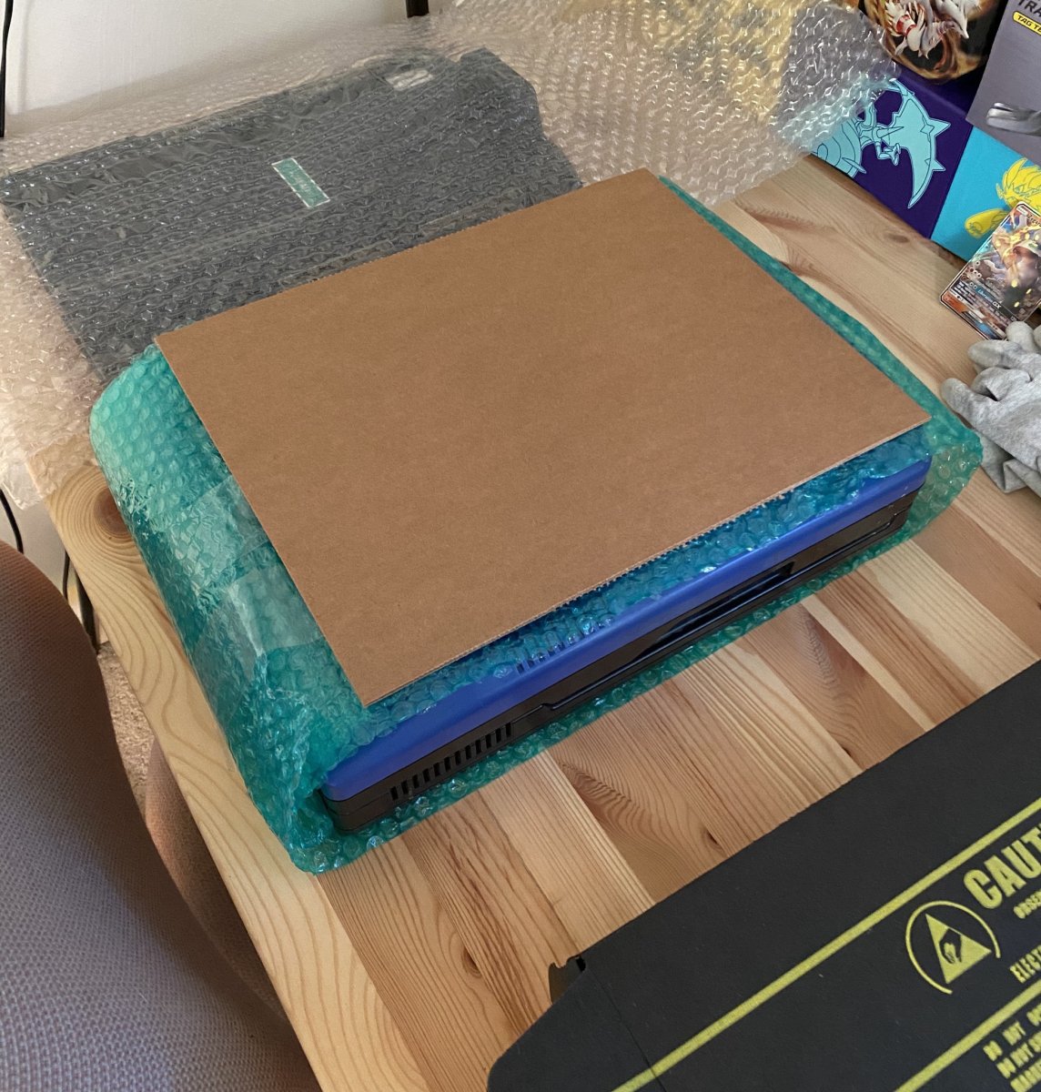

Finally, how should I store the board set? I am eventually going to get a cabinet and some repro artwork but for now after I clean it I will put it in storage. It’s been sitting on my desk wrapped in bubble wrap with a piece of cardboard covering 90% of the board. A little bit of direct sunlight comes through my window and slowly moves across the board for about three hours and I don’t want it discoloring the plastic.
Thanks for any advice! Here’s some pictures.

You can clean the case with simple green. Or just water. Or take it apart and wash it in soapy water.
Don’t worry about sunlight discoloring the shell. I store my CPS-2 upright or lying on the side. It doesn’t really matter, they’re pretty sturdy.
re: Inside, just take it apart. Clean the PCBs clean the fan area.
I bought some 99% isopropyl alcohol, I’m not going to go anywhere near the labels, they are original. Could I use that and a microfiber cloth to scrub the outside and the inside and get a lot of the loose crap off? Also thanks for bringing up the sunlight, I really don’t want to damage anything since there were only 22 ever made. I thought I had it covered pretty good.
Be careful with isopropyl. It can sometimes be harsh and destroy certain plastics. A light clean will be fine, but if you start rubbing the case or the marks a lot you’ll definitely notice discoloration / melting. You could gently use a magic eraser to get rid of small marks.
Ok thanks a lot! I’ve watched a lot of restoration videos where people scrub the heck out of stuff with alcohol. I’m really glad you told me this, I would have been using it a lot. I’ll pick up some simple green.

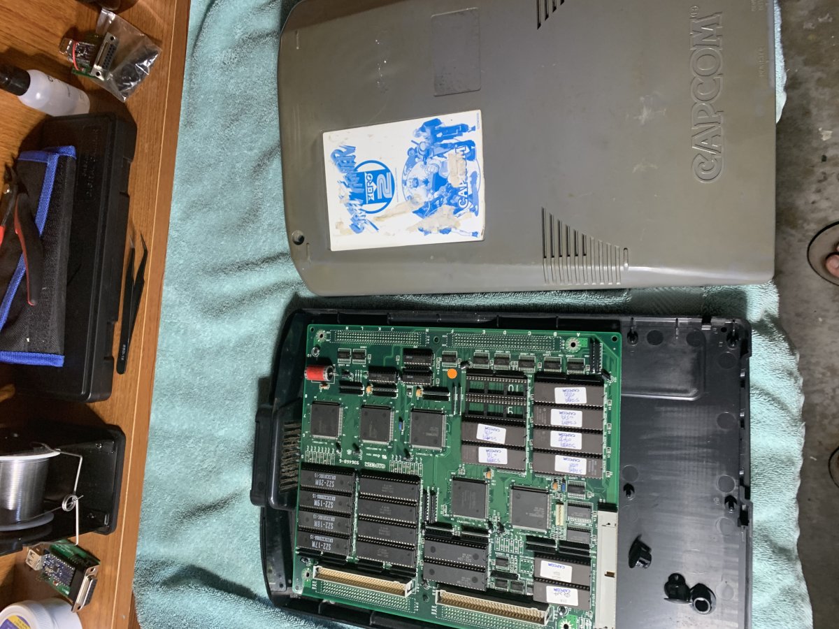

I’m doing a similar project right now :-) mine is covered in brown discolouration, suspect tar(?) from 10 years in a Smokey arcade.
I’m absolutely hopeless at vs fighters, so the Alpha/Zero series with it’s shifted difficulty curve is perfect for me :-)
Normally I wash the black shells in warm soapy water to get the worst of the filth off.
Top coloured shell is a bit harder, don’t want to damage the stickers. So I normally do that with cotton swabs.
If it still has the factory seals then the battery is going to be 30? Years old. CPS2 batteries are notorious for leaking and destroying the board. Getting rid of the battery promptly is normally the 1st thing I do. Of course slightly harder now that the global component shortage is biting into infinikey supplies.
Good luck with the restoration, following with interest

I’m doing a similar project right now :) mine is covered in brown discolouration, suspect tar(?) from 10 years in a Smokey arcade.
I’m absolutely hopeless at vs fighters, so the Alpha/Zero series with it’s shifted difficulty curve is perfect for me :)

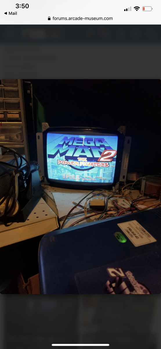

Cool Asian Street Fighter! Has hand written rom labels and an original maxwell battery. I’ll keep you updated once I test it. After I test it I’ll get some simple green and clean up the outside and have a look inside the B board. I have a Rockman 2 that still has a red maxwell battery that needs replaced, I’m keeping a close eye on it in case it decides to leak, which hopefully it doesn’t.

Cut out a piece of wax paper a little larger than the label. Tape it down with packing tape over the label so that it's completely covered. You can even lay down the wax paper on top of a bed of tape so that you can trim the wax paper with precision so that it's just a bit bigger than the wax paper. Use your nail to ensure a tight bond around the edge so no liquid can get in. Blast that thing with Simply Green. Save hours of your life.
