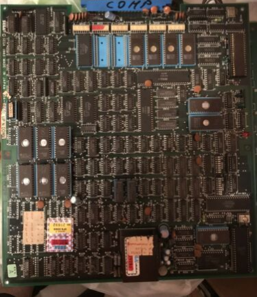

Board on left is REV.A Up N' Down Board converted to Flicky looks like a normal Z80 as the Sega protection chips have very distinctive gold pins with a black Sega sticker. My board is the REV. B board in the middle and pic on right is a close up of the REV. A Up n' down board, notice where the Sega encryption chip should be, can't see the chip writing but looks like a normal Z80 to me.

No markings on the chip (from the eBay photo).
Looks like the pins are gold to me (comparing to the chip to the left of it).
Here's what an original looks like.
My money is on it being an original, that's missing the label.
Looking again it does look like it is an original chip, the pins were so dirty on the chip in that pic it just looked like a normal Z80 with a faded chip id. My Sega chip is a lot cleaner so the gold pins are clearly visible to see.

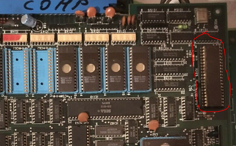

Are these the Sega protection chips you are referring to?
**EDIT** I think the black resin are for System 16 games/Space harrier and the green one was extra protection for System 16 boards. The 8751 MCU not shown was for Sega Space Harrier & Enduro Racer (character control lockout)
I thought the Z80 with the black Sega sticker were only for System 1 PCB's?

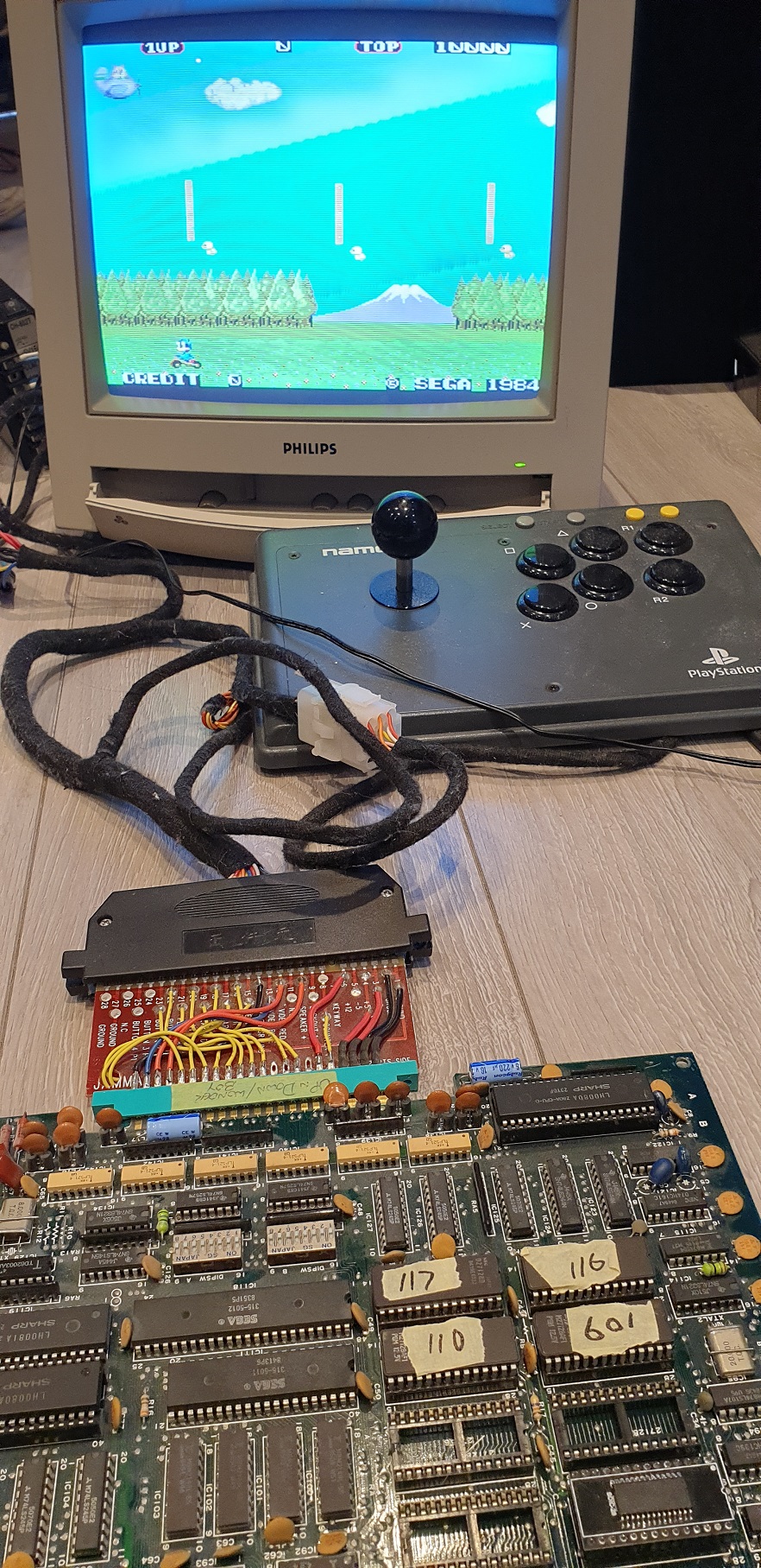

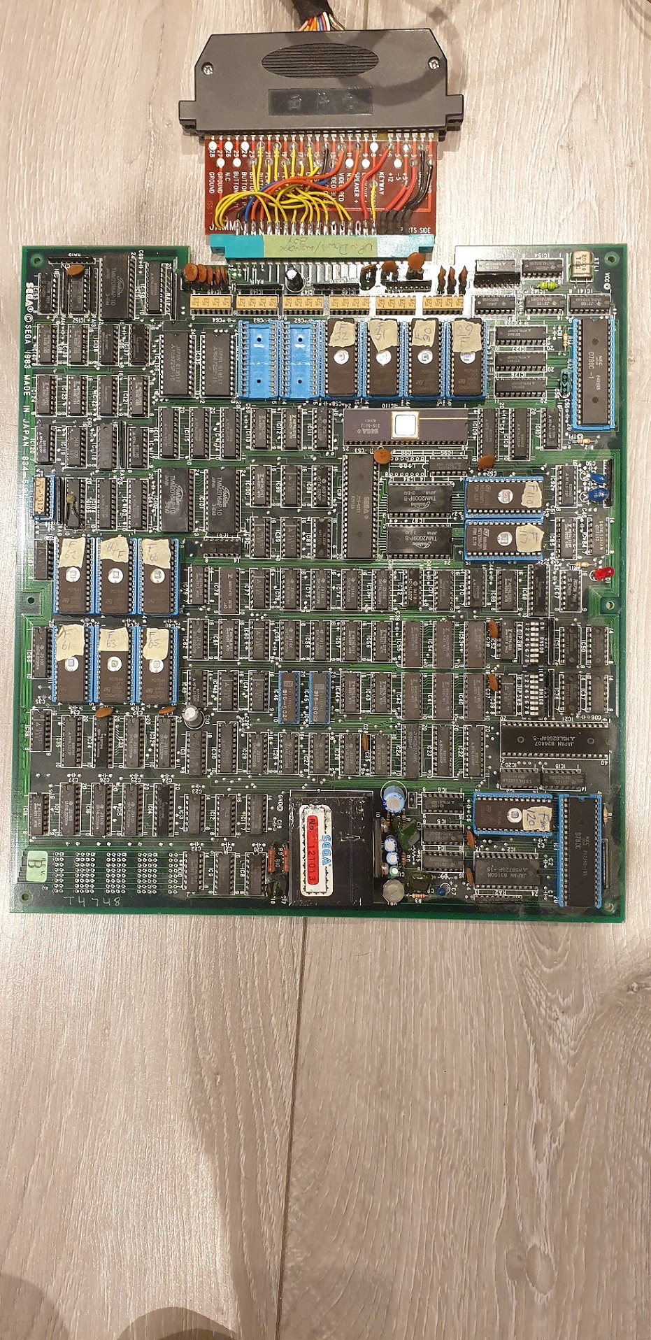

Didn't realise it was for PIO board. I have a converted Wonderboy board here using the PIO chip so you think this would be possible to convert this board to Flicky and convert the Up n' Down board to Wonderboy?
Below is a pic of my Wonderboy board. It uses a patched version of the unencrypted wonderboy set `[the end of level interval tunes play as they should do]. I noticed unencrypted set from mame was missing this.

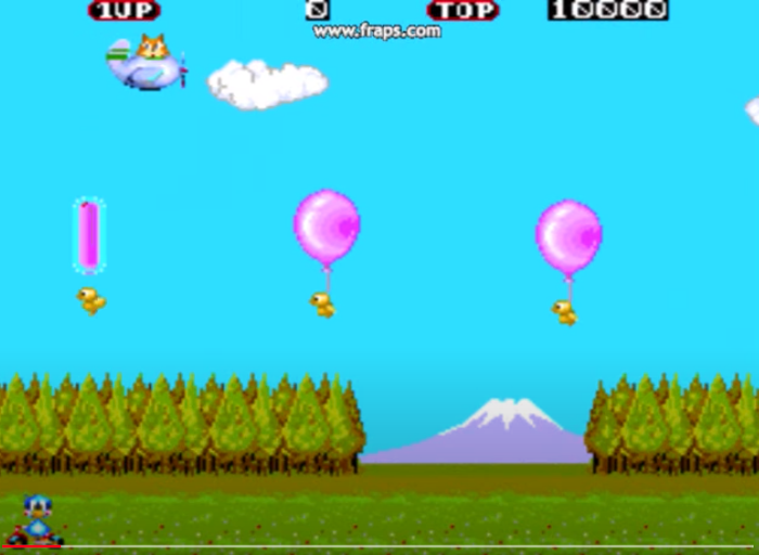

Well made some progress you were correct about which type of board to use, it must be the PIO version of the board to run the non-encrypted set. In game graphics works fine but I have an issue with the title screen, the balloons carried by the birds which eventually spell the word 'FLICKY' appear corrupt for some reason. Pic on the right is what the title screen should look like.
Roms check out ok, however I think I have an issue with one of the sprite roms.
