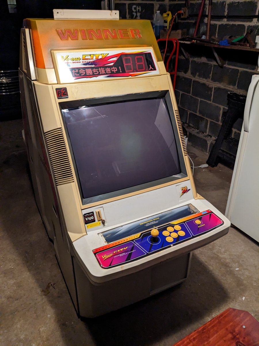

I've been posting small updates about this cab to my website but it's just been baby steps. I'll post a quick summary of where the cab is at currently and continue to post updates in this thread as they happen.
First thing I did was wipe it down and blow out the fans. Nothing super interesting.
The P1 side has Tetris burn in but when the monitor is actually on the burn in isn't really visible. I was expecting it to look awful.

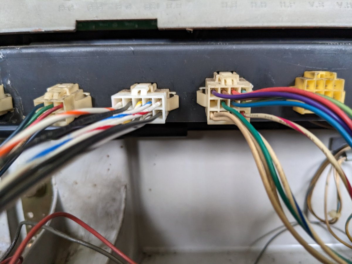

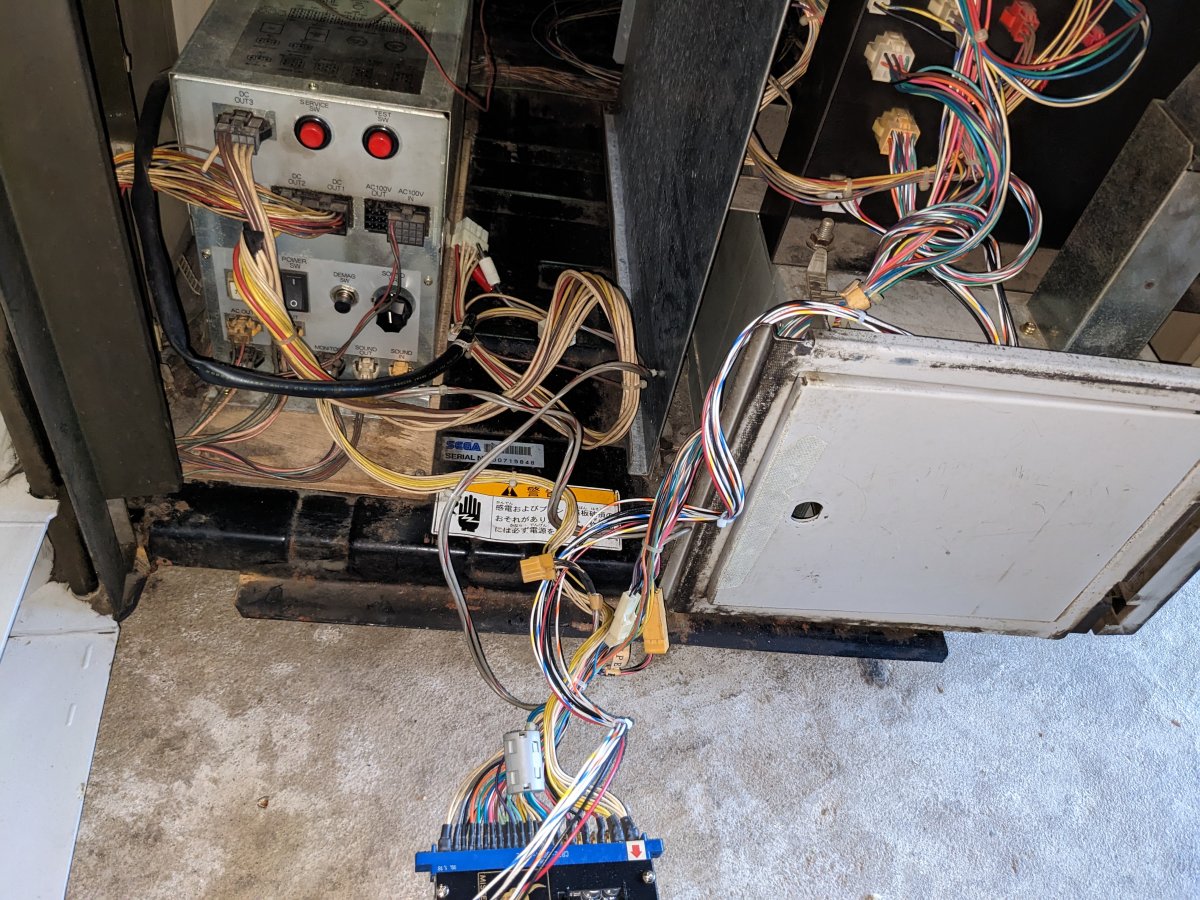

I can't believe it's already been 2 months since the last update. The buttons not working really threw me for a loop. I thought I just needed the CHAMMA to JAMMA adapter, but actually all the buttons on the P1 side were broken and the P2 harness was plugged in the wrong spot. All the buttons work as of yesterday and my friend and I were finally able to play some games. There are some other things worth mentioning:

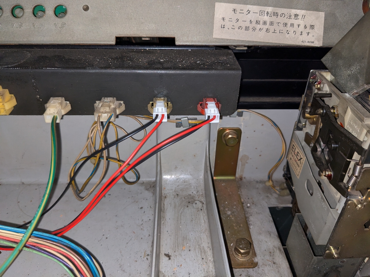

I got 6 button panels installed along with a MiSTercade. After some trouble hooking up the kick harnesses, pretty much everything is good to go. For some reason neither side had a wire in pin 8.
I just moved a wire from the main harness that I didn't need anymore and put it in pin 8. I think it was the wire for button 5. I don't need it anymore because the kick harness handles button 5 now.

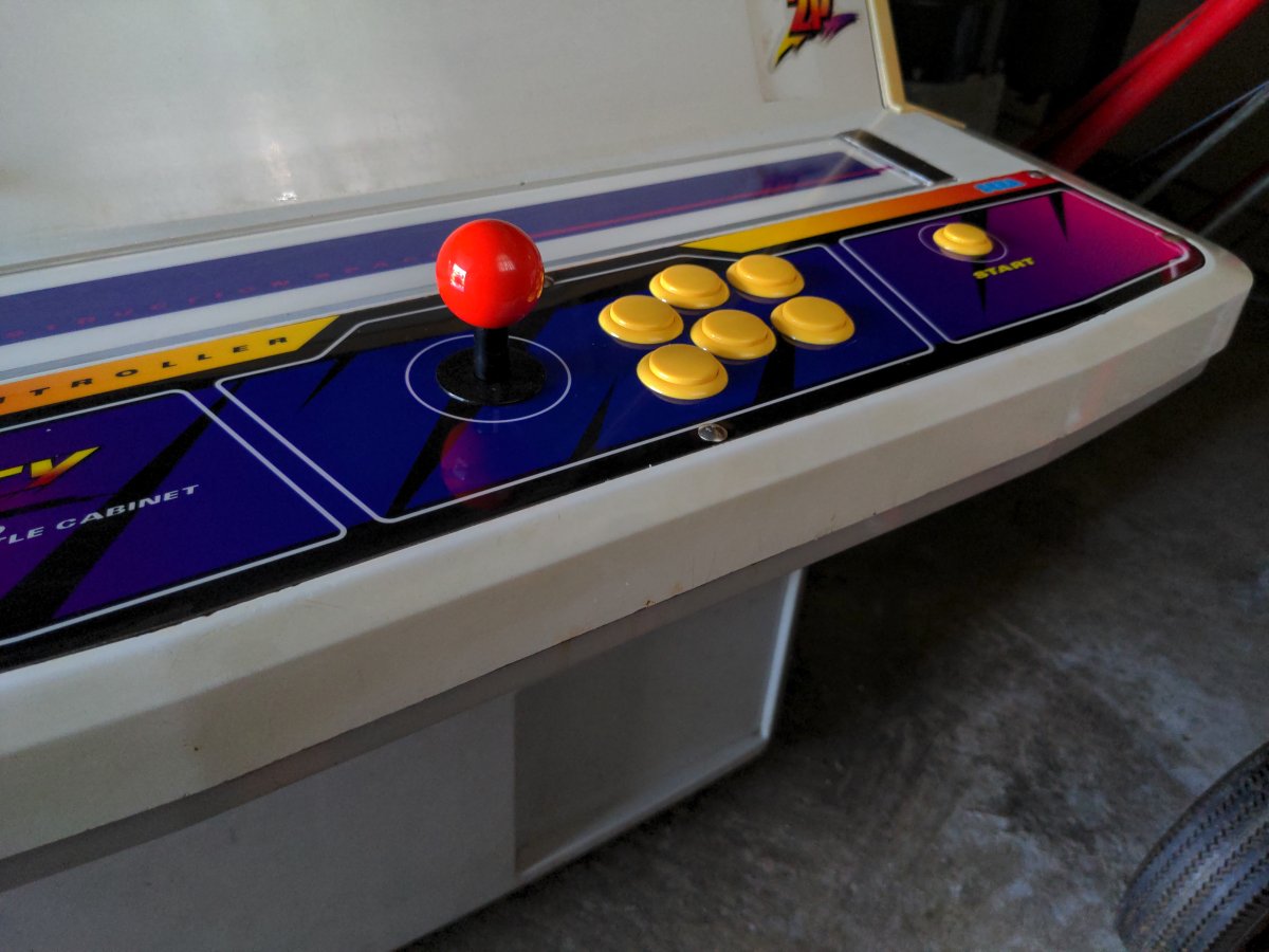

The mounting holes on these 6 button panels is different than my old Tekken panels. I think I just need mounting plates for the sticks, but in the meantime I harvested the Hayabusa levers from my two RAP4s just so I can actually use this thing.

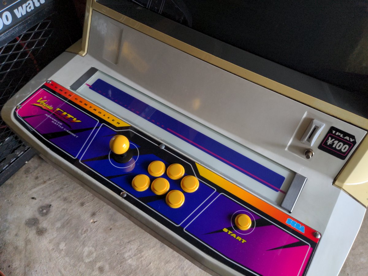

Small update. In the above post I mentioned the one monitor is distorted for a while every time I turn it on, but all I needed to do was adjust the horizontal hold. I don't know why that took me so long. I got yellow Sanwa parts and ripped off the Tekken art. Getting 2 layers of stickers off ended up being way more annoying than I was expecting. It's still not perfect but it's getting there. I've been spraying it with Simple Green and then chipping away at the glue with a razor. If anyone knows of a better way to do it, let me know.

My P2 side MP button is still killing me. I swapped the player controls and the problem switched over to the P1 side which tells me it's not an issue with the wiring under the panel, but an issue with the wiring on the JAMMA harness side. I dont really know where to begin there because it's a rat's nest.

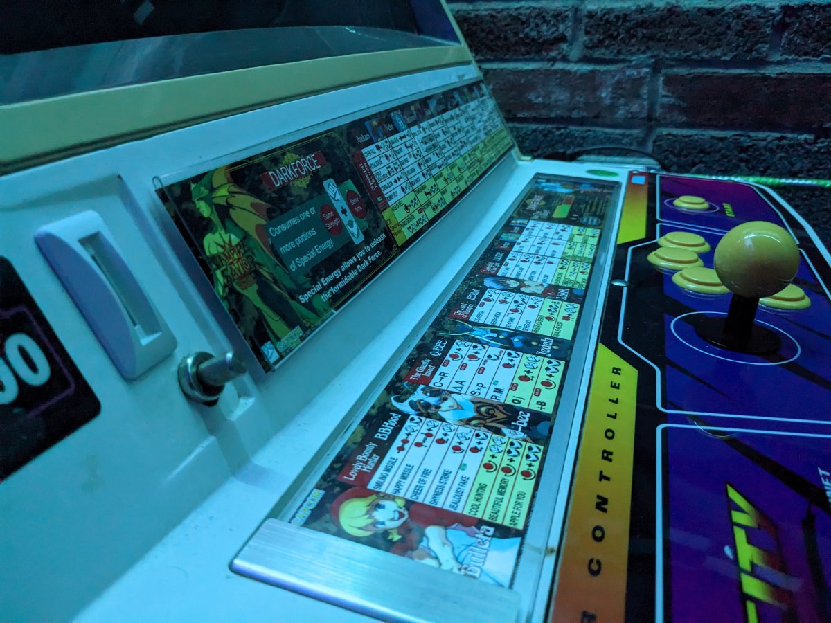

I got the new coin slots and instruction space stuff. It's looking clean as hell now.

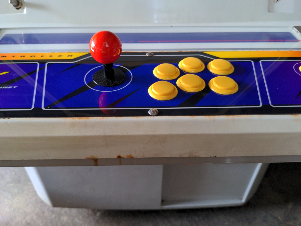

The other side has some rust and I'm not sure what to do about it. I could bead blast it but that might be overkill. If anyone knows of a simpler way to get it off, let me know. One of these days I'll buy another yellow balltop...

I did clean off the rust from the previous post with a magic eraser. It made quick work of the rust as well as most of the dirt and scuffs all over the cab. I can't believe how much time was spent slowly scraping off sticker goop with Simple Green and a razor blade when I could've just used a magic eraser first. This photo is old but whatever:

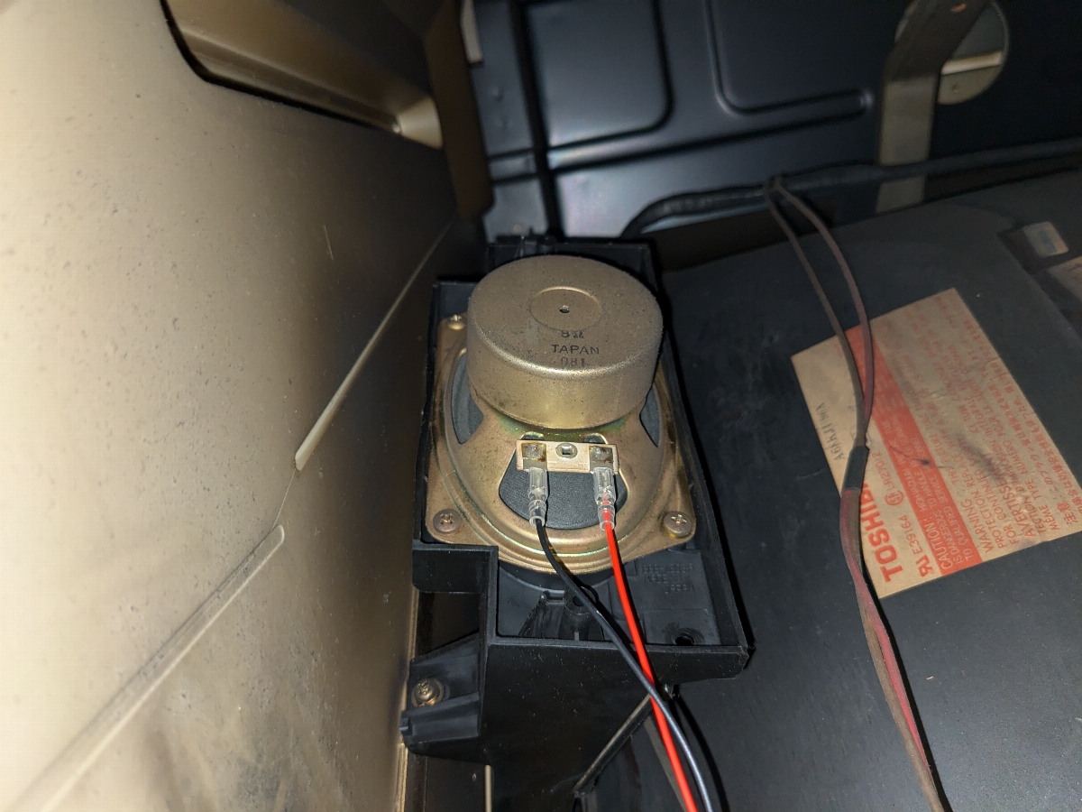

I finally got around to fixing the right P2 speaker that hasn't worked since getting the cab. I had other things to worry about so I never bothered checking it out even though it was a pretty simple fix. The internal speaker wiring was really jank. Sorry for the terrible picture.
One of the wires for the right P2 speaker was not wrapped up with the others. I wrapped it up with fresh electrical tape and it worked, but I wanted to wire the speakers up correctly. Shout out to notsonic for walking me through everything.
So not only do all my speakers work, but they also work in stereo. I'm not sure how common it is for Versus Cities (not New) to have RCA cables. Even after all this effort to fix the speakers, I still keep the volume pretty low and play my own music. It just feels better knowing it's wired right. I recently have felt inspired to clean up all the little things that I considered low priority before. Are Versus Cities normally loud as hell? I think it's the two fans up top by the winner lamps making all the noise. I cleaned them when I first got the cab, but didn't notice any difference. If anyone can point me in the direction of replacements it would be appreciated. Or let me know if I'm way off.
