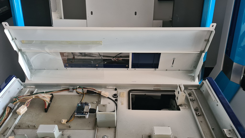

Here are pictures of the inside of one of my Blues. Can someone take similar photos of a Black and/or Orange?
Apologies for the mess. Just for a change my cabs are in pieces whilst I'm working on things, one day I might get to actually play some games ^^
@fuzzbuddy - thanks man. I'll get you to grab a couple more pics for me.

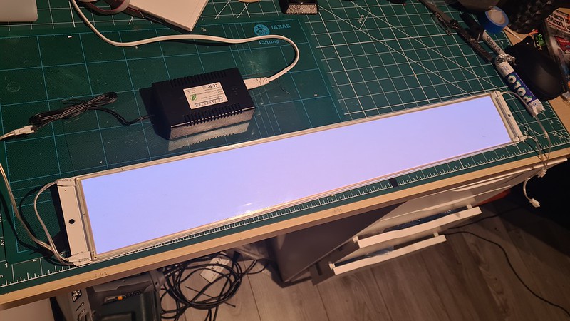

I'd be willing to try buying from that supplier. I've had EL wire in the past that's made that sound, so I know exactly how annoying it can be. Is West saying the supplier's light at Technolight didn't whine?
@Ignignxkt Yup, the panel I got from technolight doesn’t whine or does so so quietly I don’t notice. I used that one for the instruction space light so I’d hear it and I’m pretty sensitive to sound.
The panel I got from glowhut for the marquee does audibly whine by comparison and I mostly keep it turned off.
Thank you. I didn’t really want a marquee light so that works. And yeah that whine penetrates you. At least the one I used to have did. It’s quite but the frequency drove me nuts.

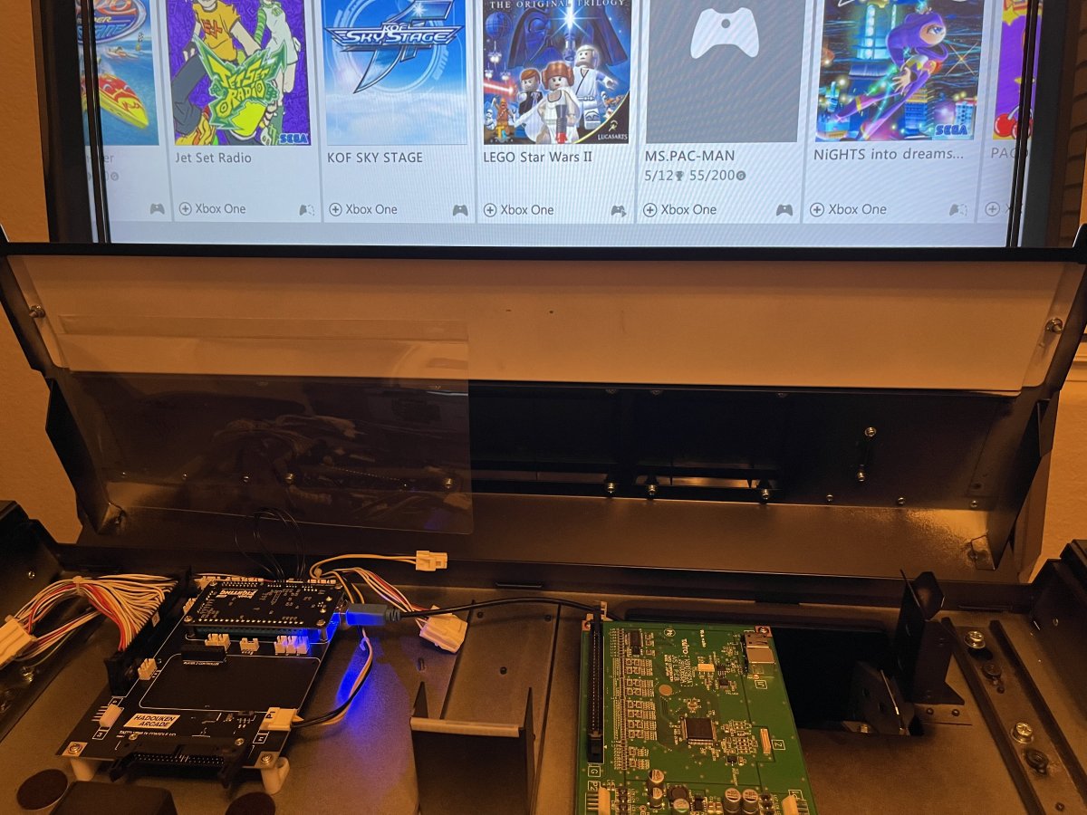

which Vewlix model did you fit your light into? I have a diamond black and wasn’t sure if I’d have to drill for the power cable to escape from or something. If you have any pics of your setup that would really help.
Did you just sandwich you’re art against the el panel?
I’ll keep it in mind for the future. In the meantime I have bigger issues to figure out just in terms of setup atm.
Seems you lucked out. I don’t have such a space for the wires to squeak through.
