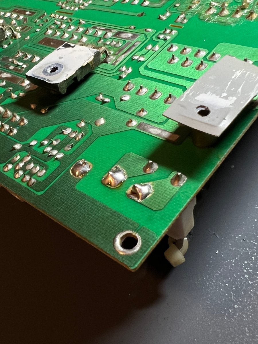

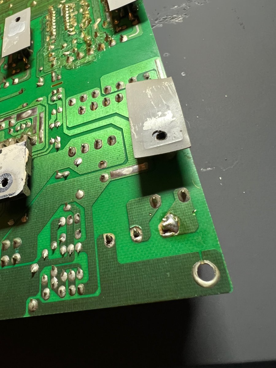

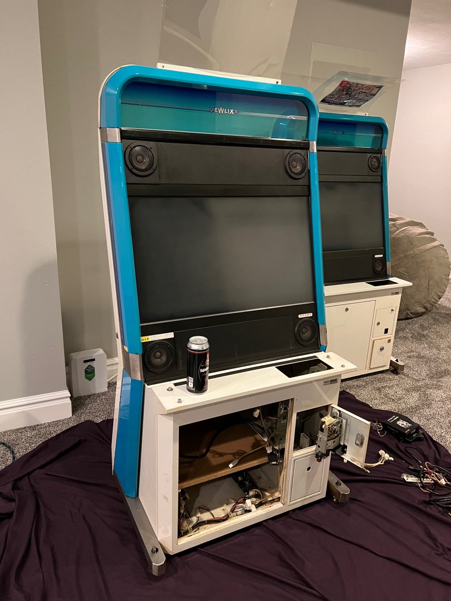

All in all, not bad! They had the usual signs of use but no abuse or anything. Just lots of soda spills and tar. As far as repairs went, the two biggest things were a non-functioning LCD (turned out to be a fan connected to the wrong connector) and some broken traces from mechanical failure on the Wei Ya PSU. Removing a bit of solder-mask and soldering a big glob fixed that.

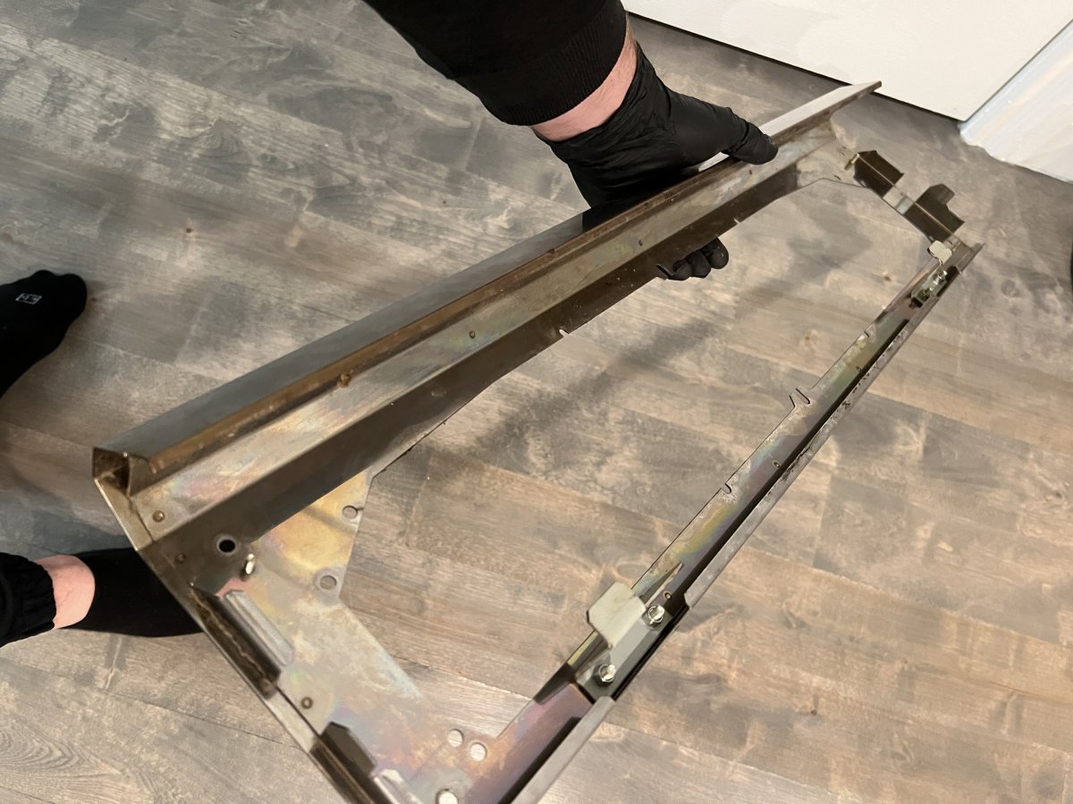

Control Panels:

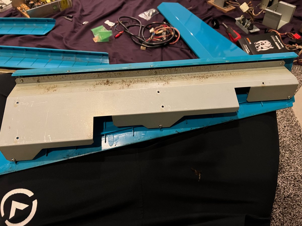

Lots of buildup on these guys. I used a lot of simple green; but the real hero was this all-purpose cleaner from target:
https://www.target.com/p/method-fre...pray-bottle-28-fl-oz/-/A-13531143#lnk=sametab.
I was shocked how well that stuff worked. I sprayed it on, let it sit for a minute or two, and the tar would slide right off.

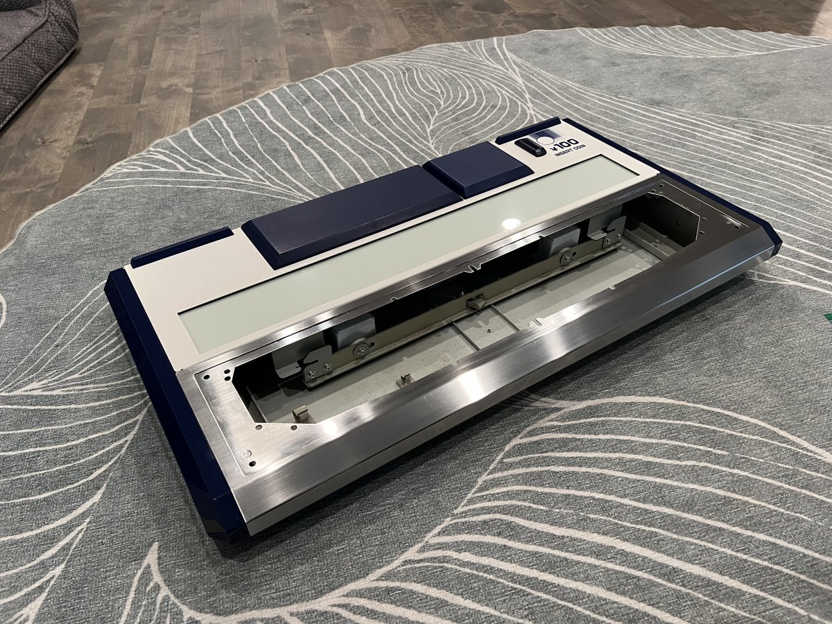

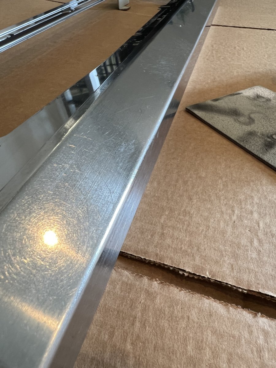

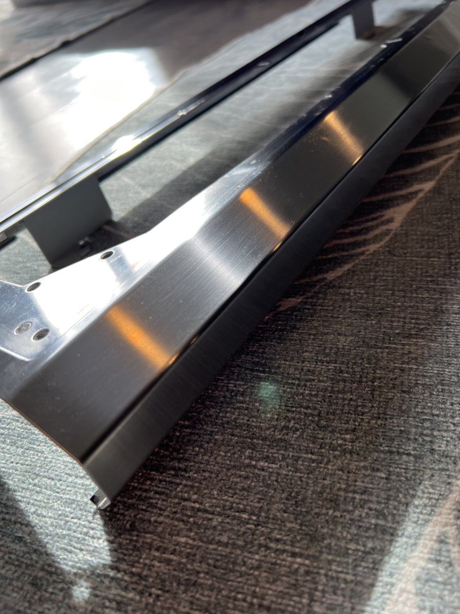

For scratches in the CP I started around 400 grit, then 600, then 1000 grit. Once I had a nice shine with few to no visible scratches, I re-applied the brushed look with a scotch pad. To get them as straight as I could I leaned it up against a cardboard box.
Came out pretty nice.

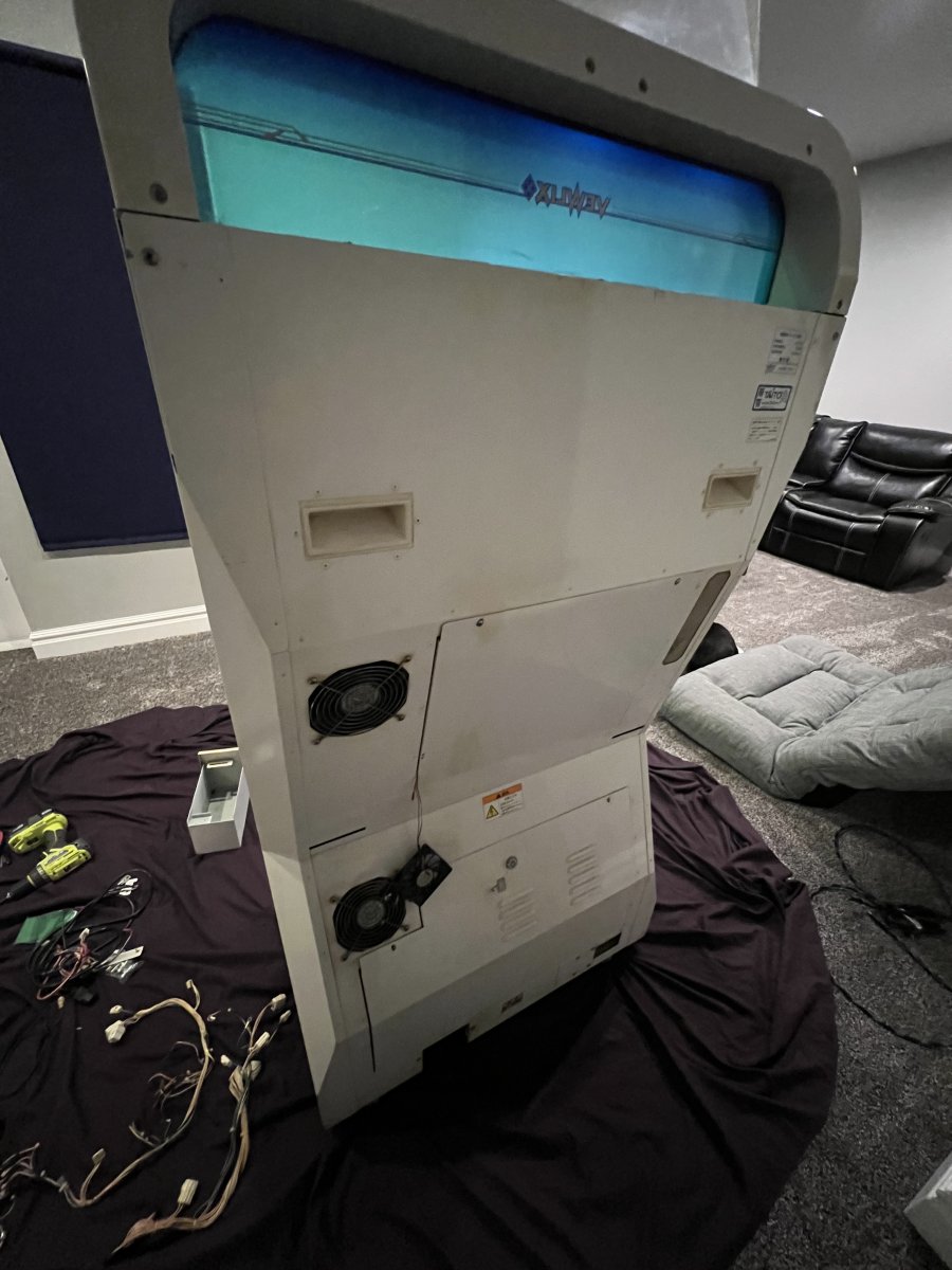

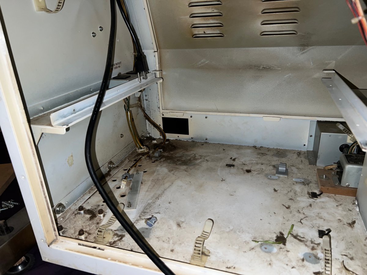

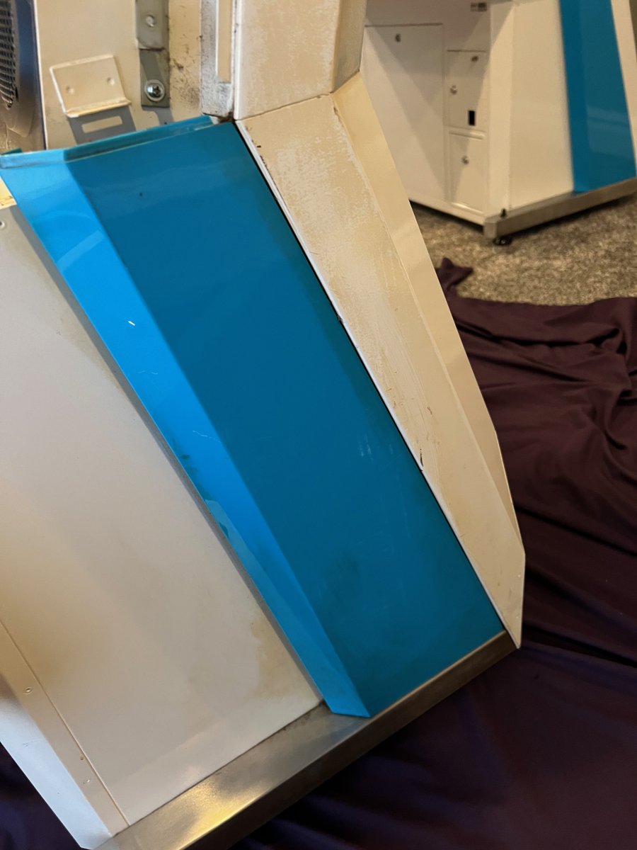

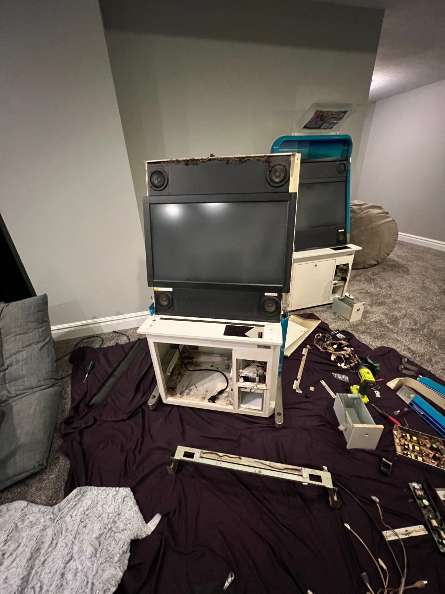

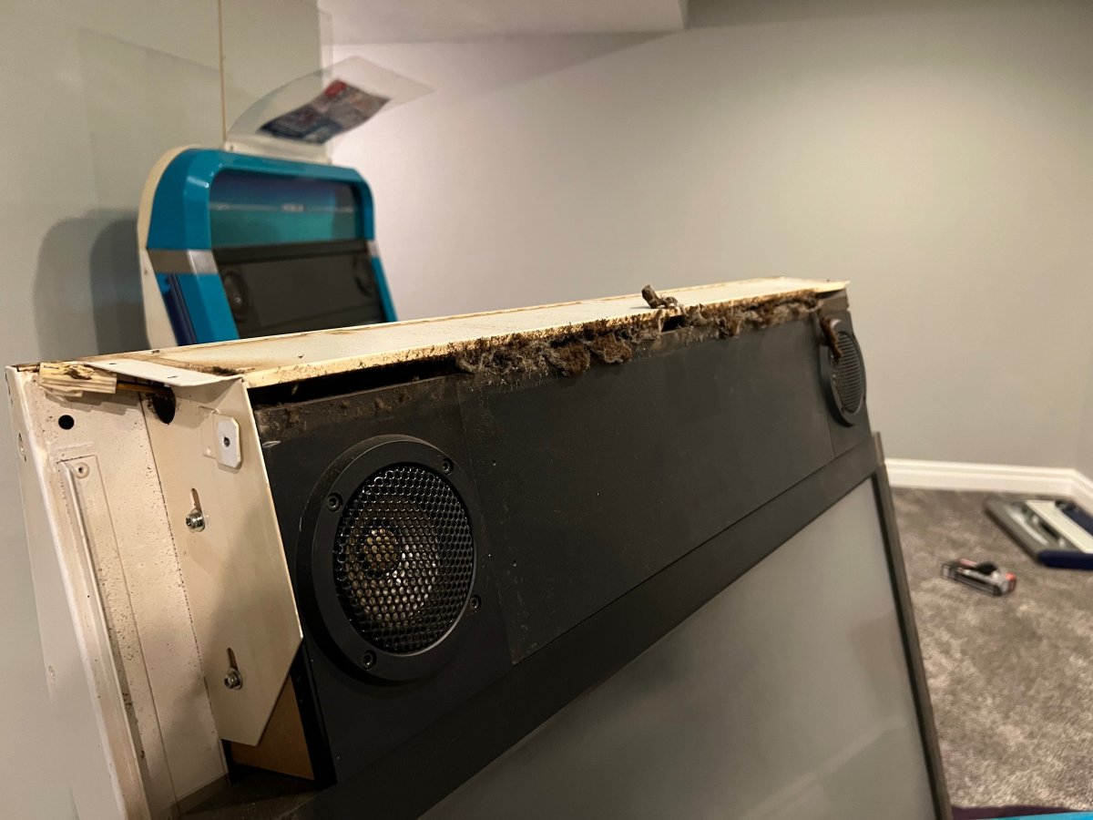

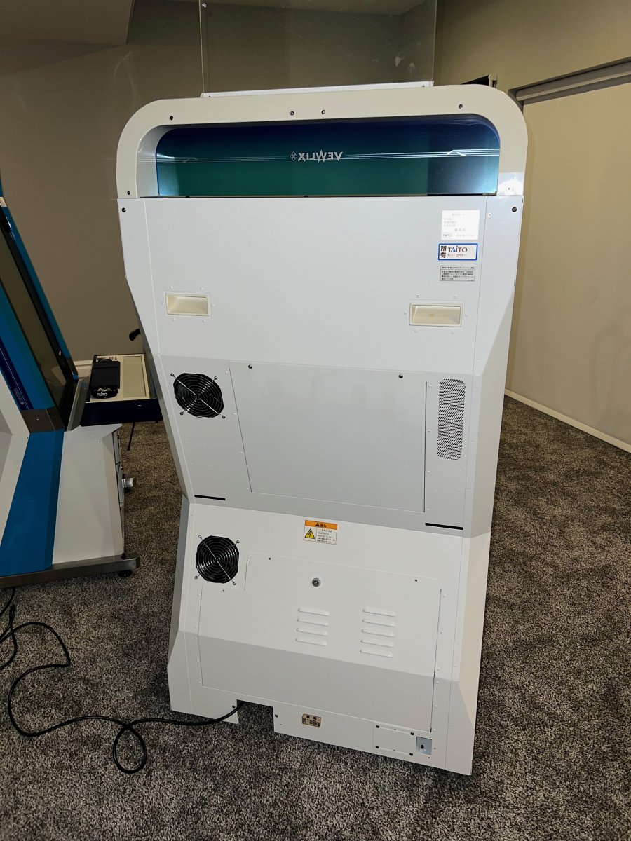

The first thing I noticed was how cloudy the displays were. I used to do repairs at an Apple Store and it reminded me of the old iMacs that didn't have the lcd adhered to the glass. Those used to get so gnarly! Here are a few more "before" photos:

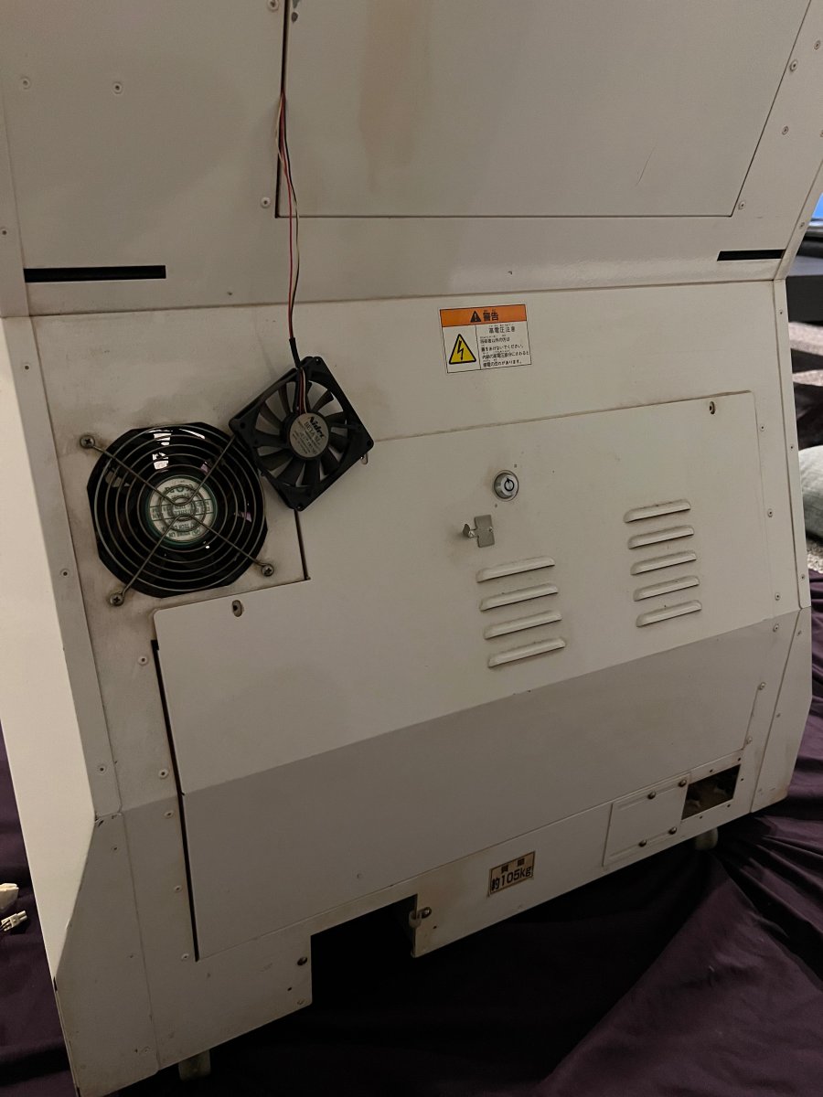

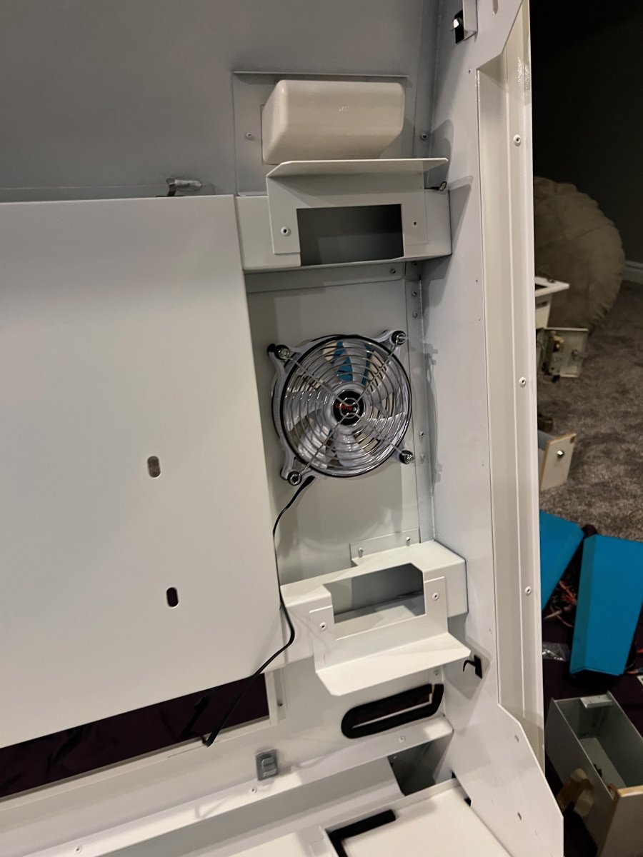

Curiously, both of these had their fans just kinda hanging around out the back. I have no idea why they did this. Any thoughts on that?

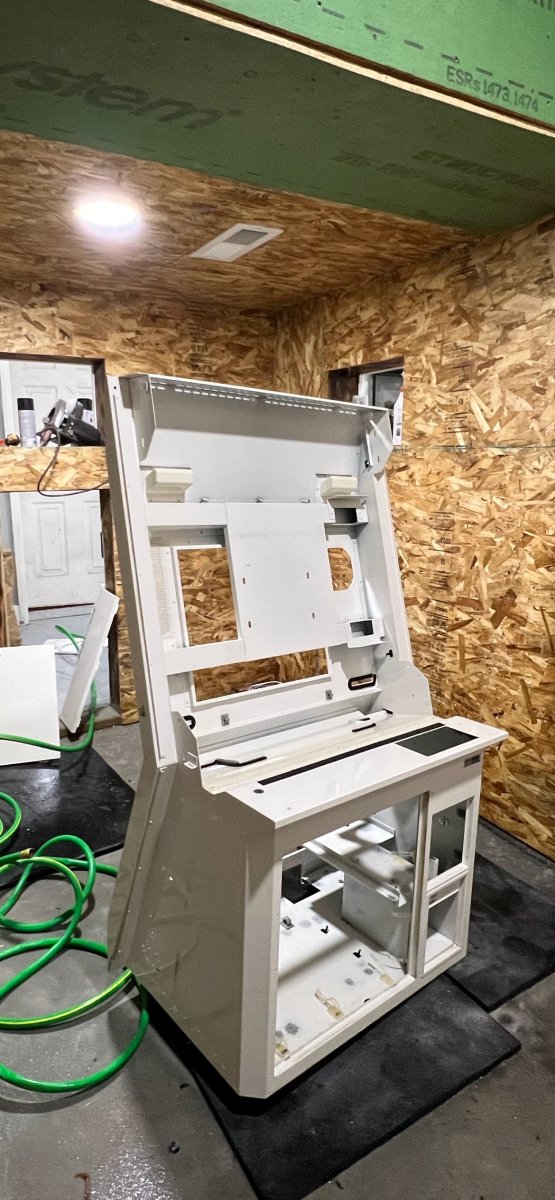

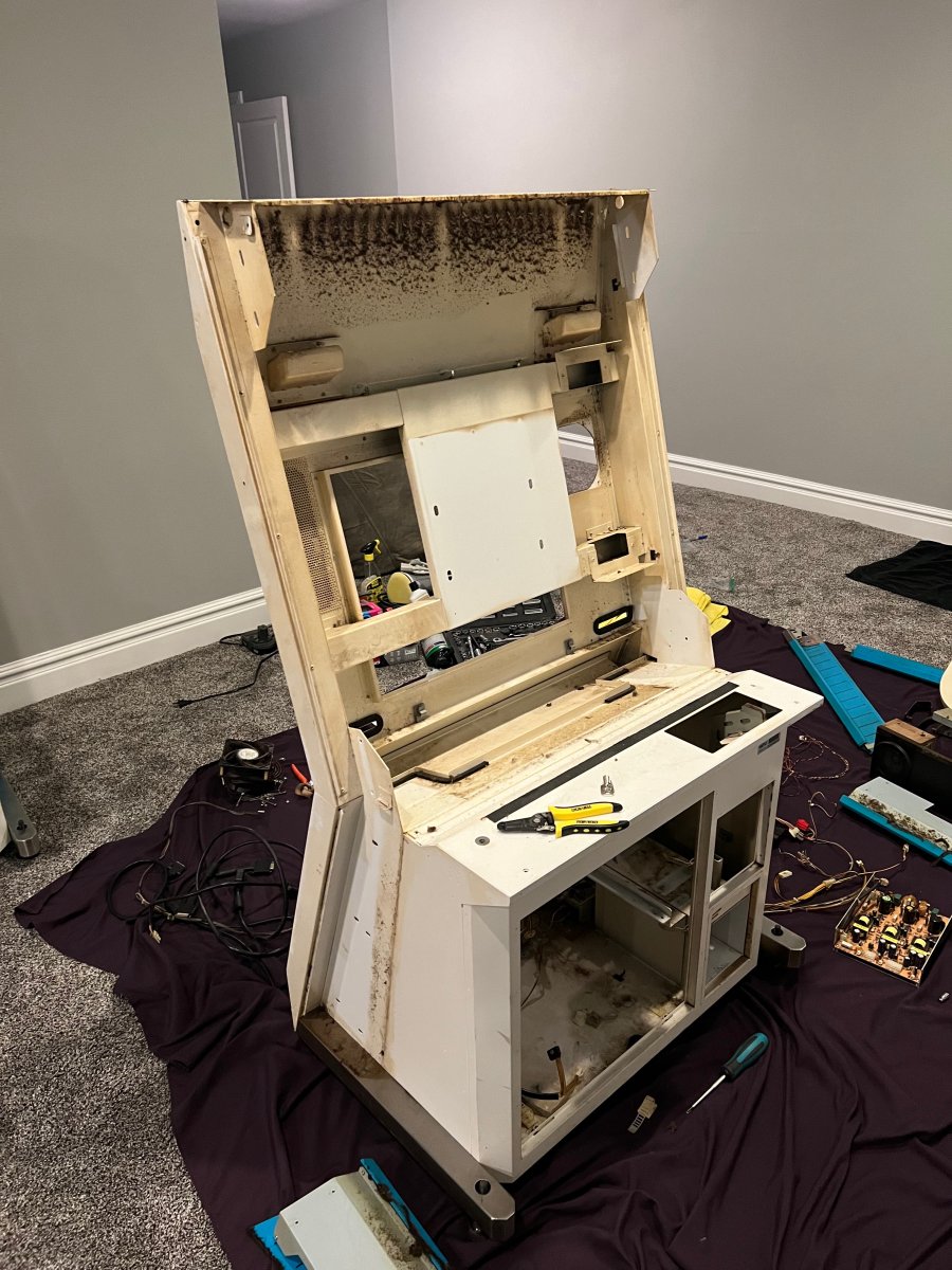

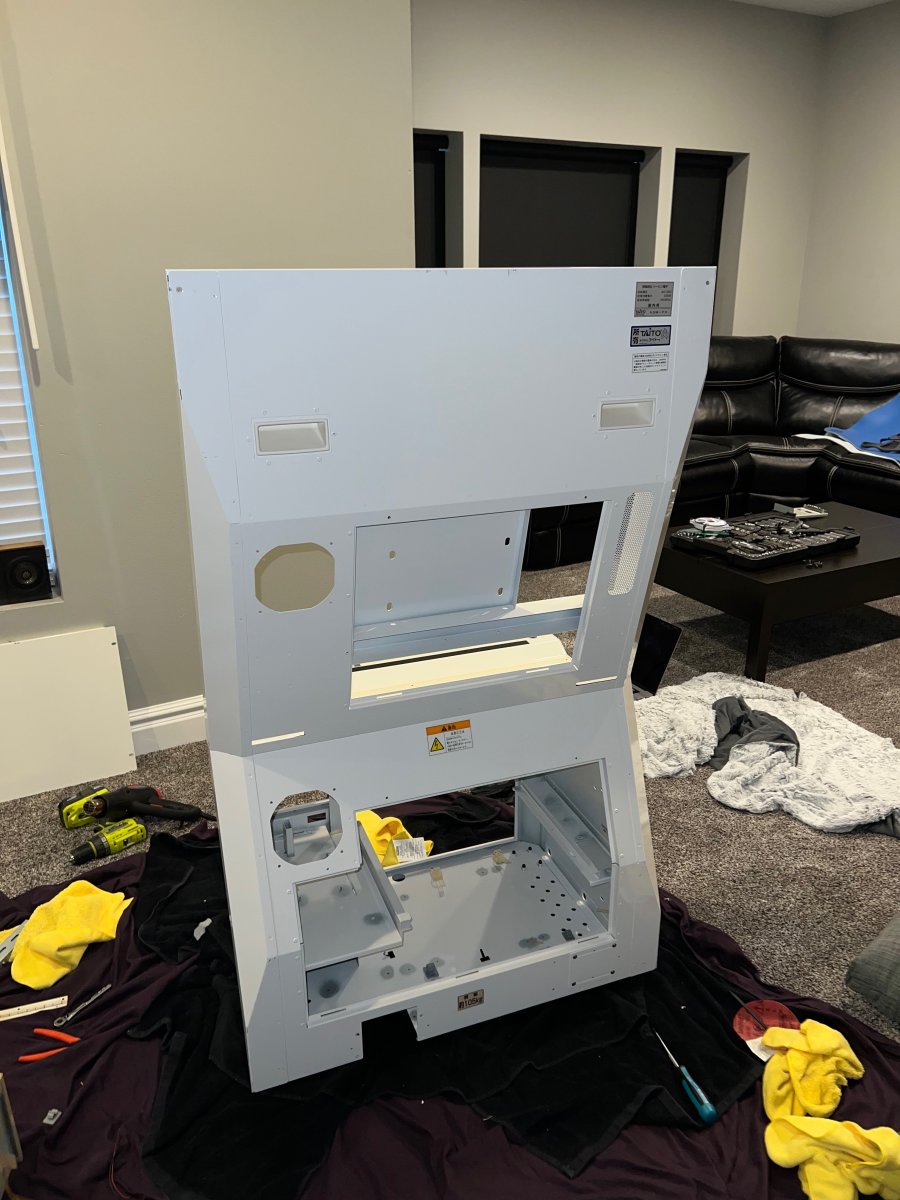

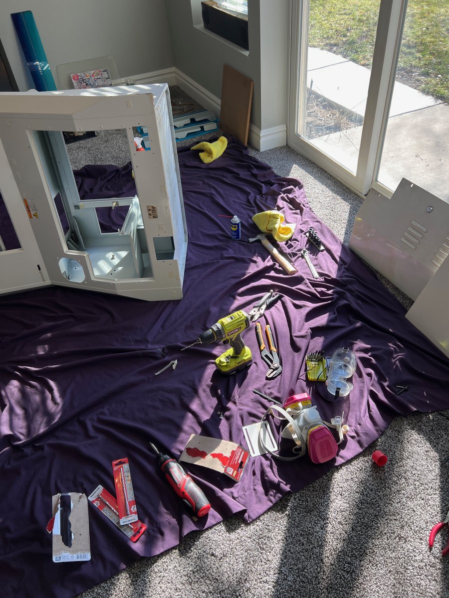

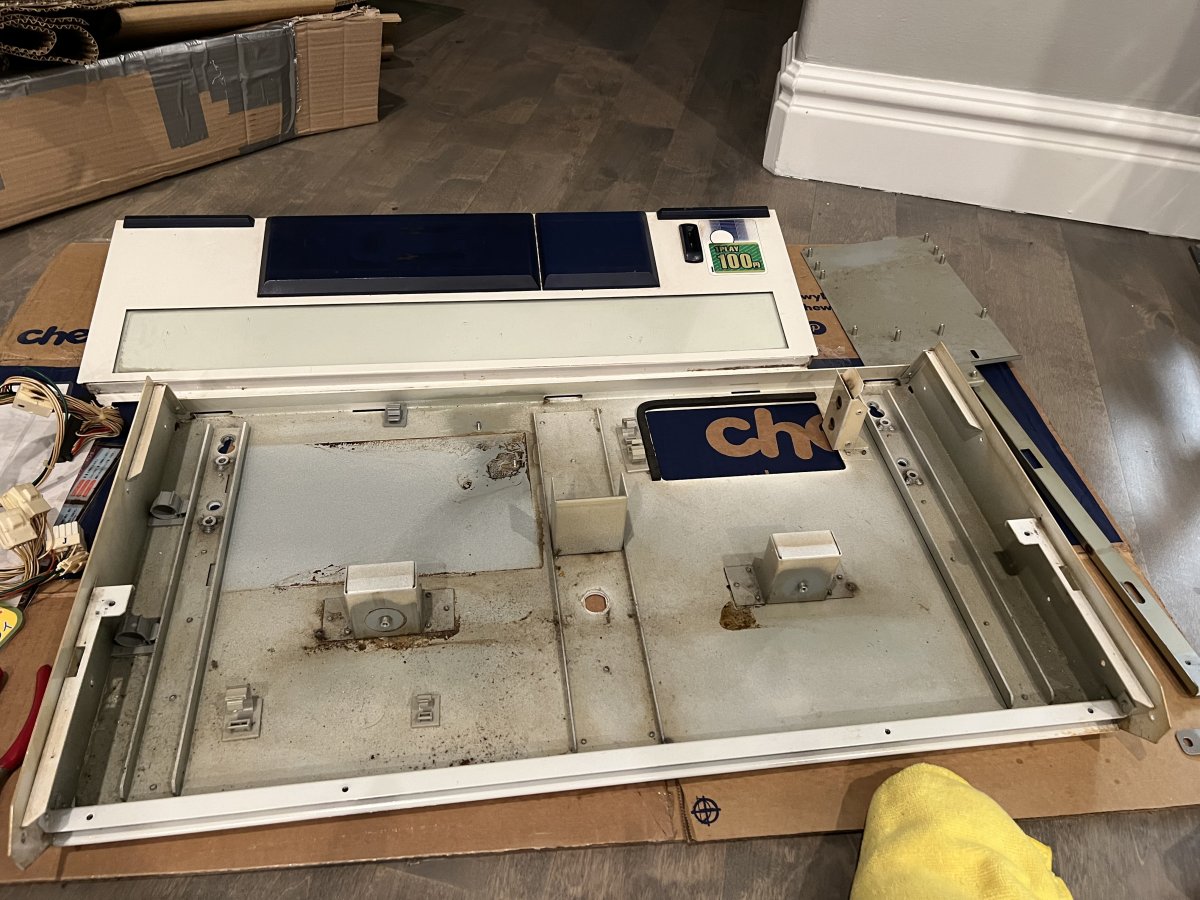

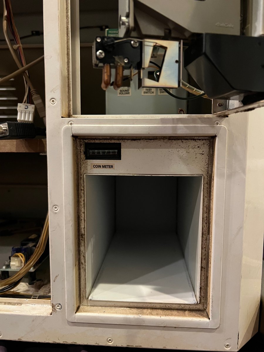

Once I got the cabs stripped down I carried them into our "dog run" (former owner of the home built it. Now I just use it for arcade stuff) and soaked the thing in more of that Method all-purpose cleaner. I let it sit for a bit, then hosed it down. Then I did another round of it and rubbed it down with a microfiber cloth. The after felt like a completely different cab! The casters on these make them really easy to move around. That was a huge plus.

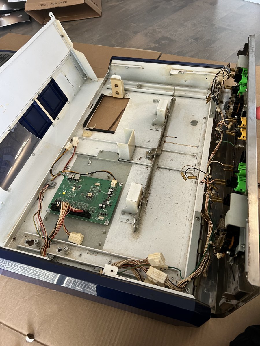

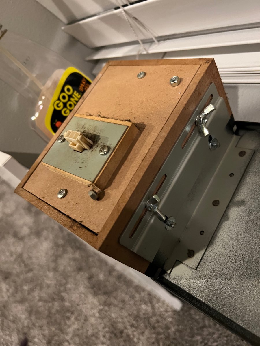

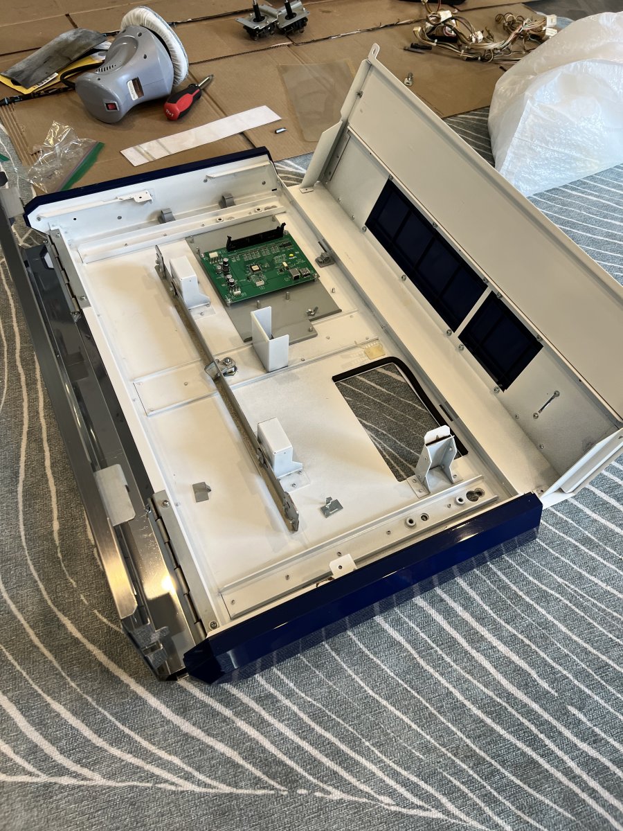

Once I had everything apart I began cleaning. The hardest things to clean were these plastics. They are so incredibly fragile that just unscrewing them caused a couple of the posts to break. Unfortunate, but they did go back together ok. I just had to be very careful. Piece by piece I would take things apart and take them to wash.

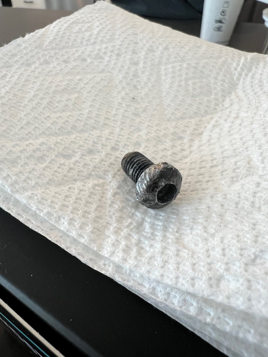

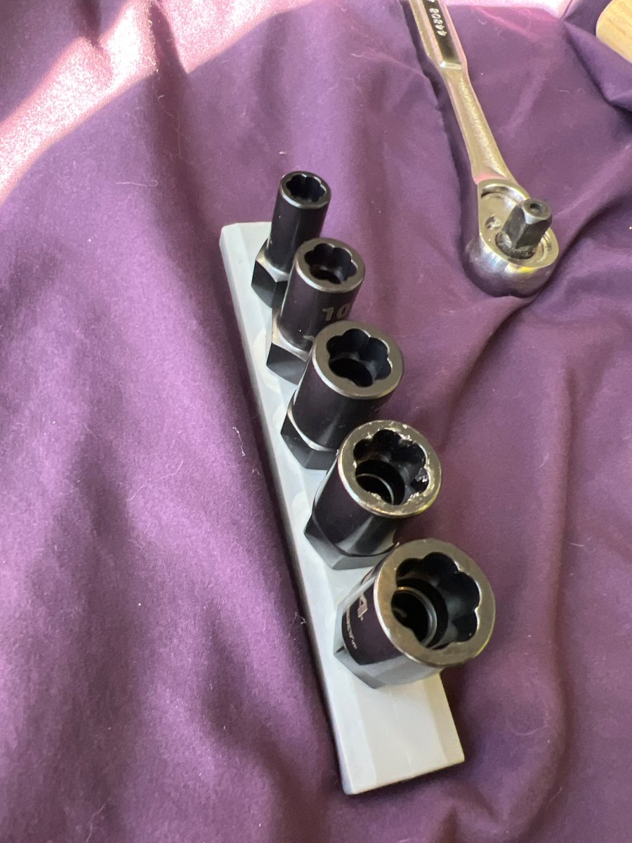

This was the second-most frustrating issue I ran into. The casters on bottom have 5.5mm hex bolts The bolts are pretty dang soft and the threads either had paint or loc-tite on them. I learned early you should slow down, make sure you're absolutely square with the bolt, and if your hex key is at all stripped to get a new one. One of the bolts didn't want to come out and I tried multiple extractors to try and drill it out, vice-grip it out, etc. Finally I ran to Home Depot and got this extractor kit. The 12 mm fit right over the head of the bolt and I was able to hammer it on and get the teeth to bite. Sweet victory.

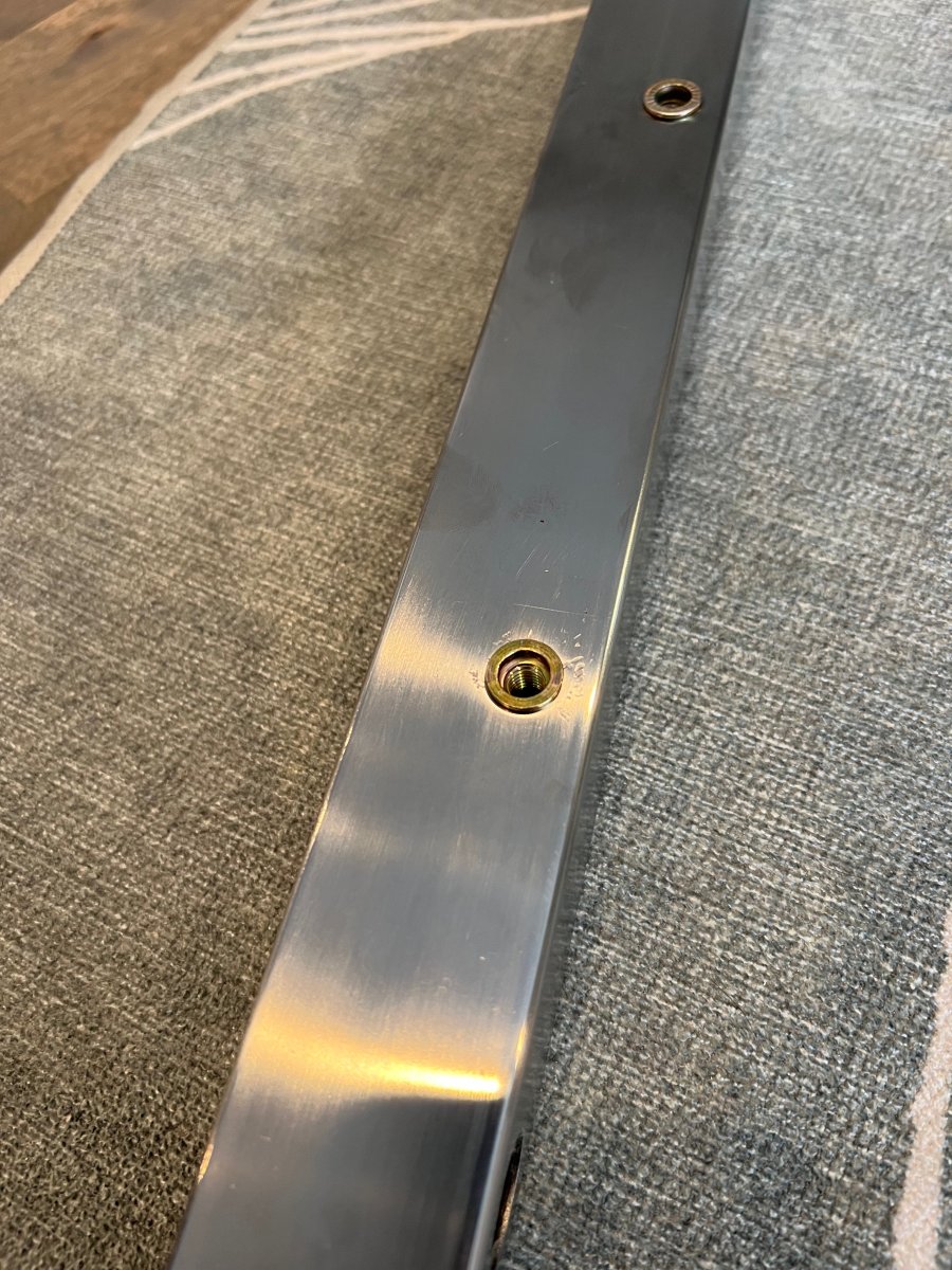

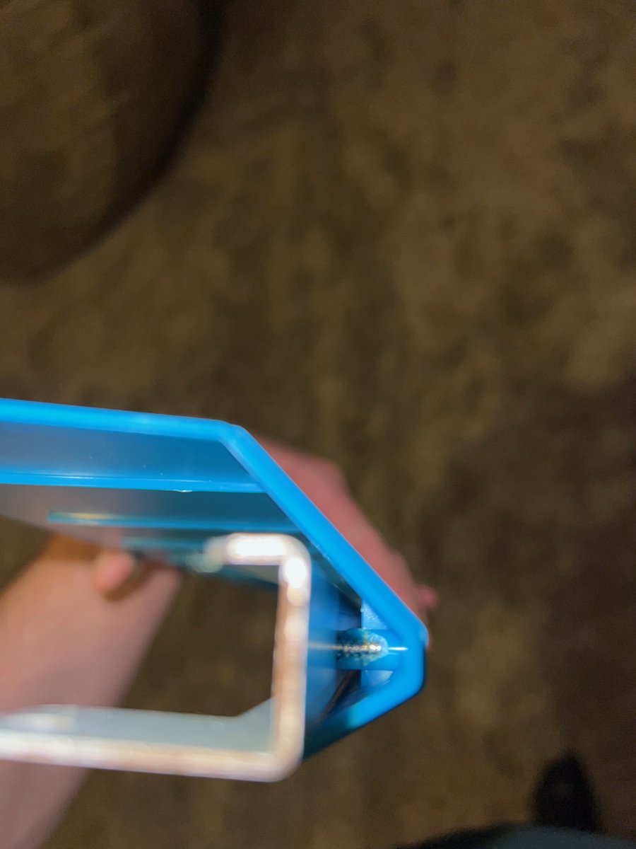

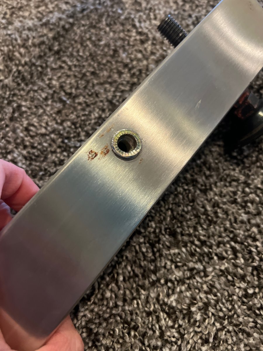

The most frustrating thing I ran into was a busted nutsert. This super sucked. If you've never taken apart a vewlix the front right bolt holding in this leg has very little space to get to the bolt. As I was putting this back onto the cab I was tightening with a socket wrench and everything was going fine. Taking my time because the space is so small. All of a sudden the bolt gets very easy to turn... I wanted to puke. I knew what happened. Fortunately the bolt was only about a quarter the way screwed in when this happened. After another quick trip to Home Depot, I returned with some really thing needle-nose pliers and I was able to grab the nutsert and I backed out the bolt. I ordered a nutsert gun thing from Amazon and got a new one in. Good as new.

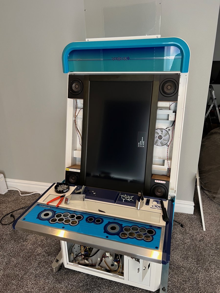

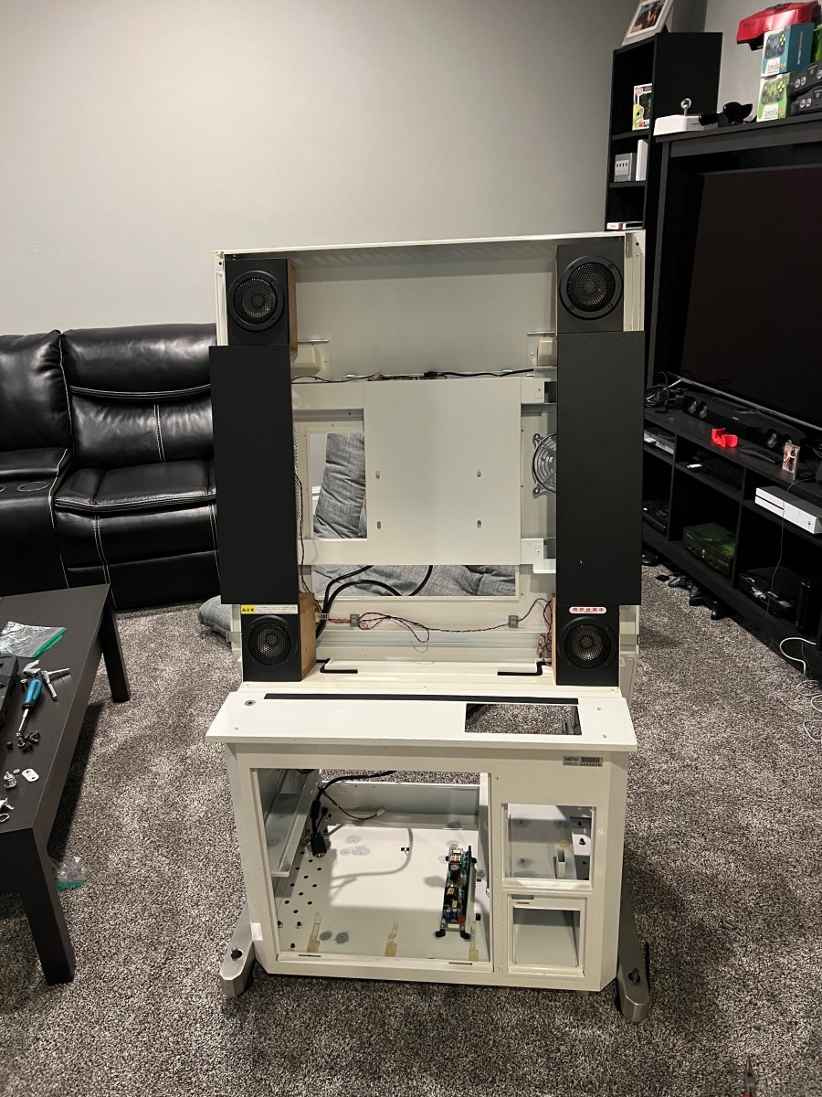

After scrubbing the larger things down moved on to reassembly and other random jobs. I ordered two different sets of fans and although I like the aesthetic of the Be Quiet! fans the most, both these and the ARCTIC fans are really quiet. You can't hear them over the console or whatever you have in the cab so that's good enough for me.

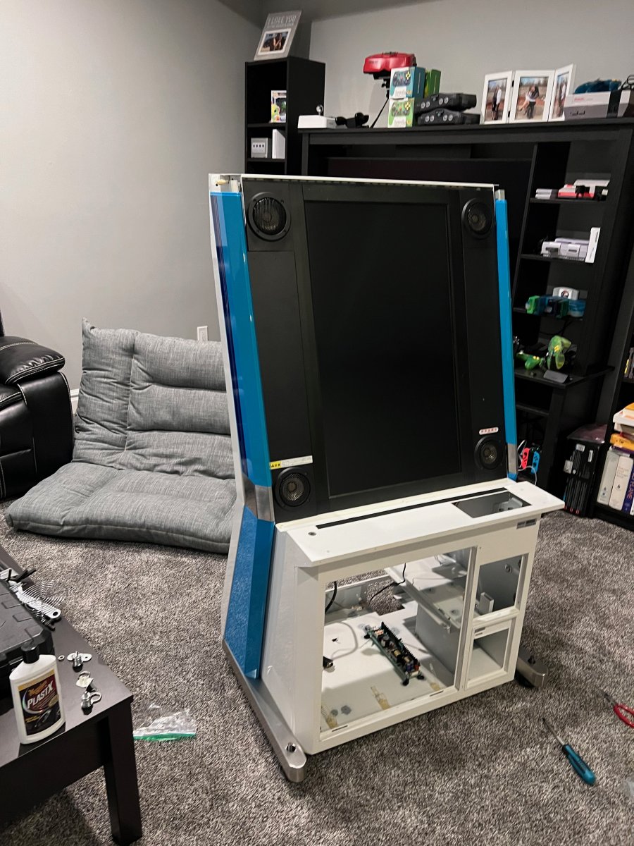

Lastly for this post, I thought I'd show off a photo of the glass being cleaned. That alone made the whole cab look like new.

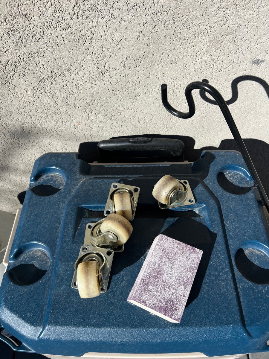

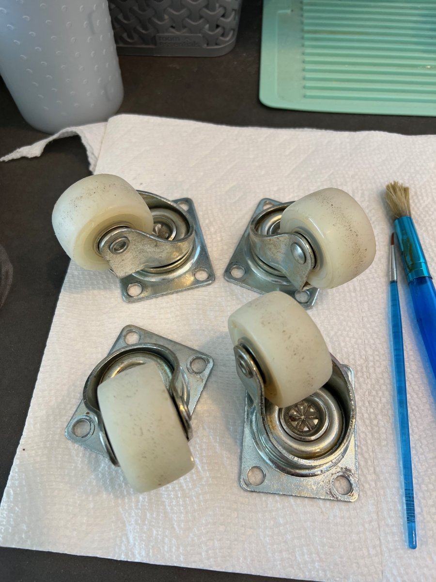

The casters (once I got the damn things off) were a lil crusty. I didn't really want those rolling around on our carpet. I didn't find any info on how to take these apart and I didn't want to replace them with the wrong thing (couldn't find any matches locally) so instead I decided to clean them. I grabbed my random orbital sander and simply ran it against the wheels. Once that was done, I cleaned them with all-purpose cleaner. It was pretty easy. Not everything came off but it's due to the gashes in the wheels. Good enough!
One of the Wei Ya PSUs had an A/C input that was wiggling around. This cab had a "needs repair" sticky on it so my guess is it was this. I did a quick repair on it; maybe I'll go back and make it prettier, but it is strong and these PSUs aren't too hard to come by. I used a fiberglass pen to reveal more copper and flooded the area with solder.

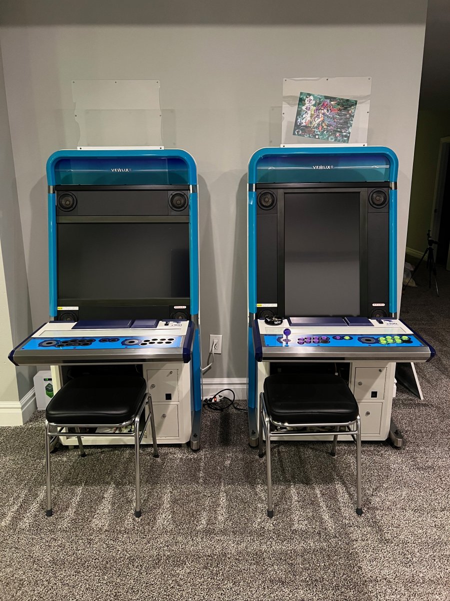

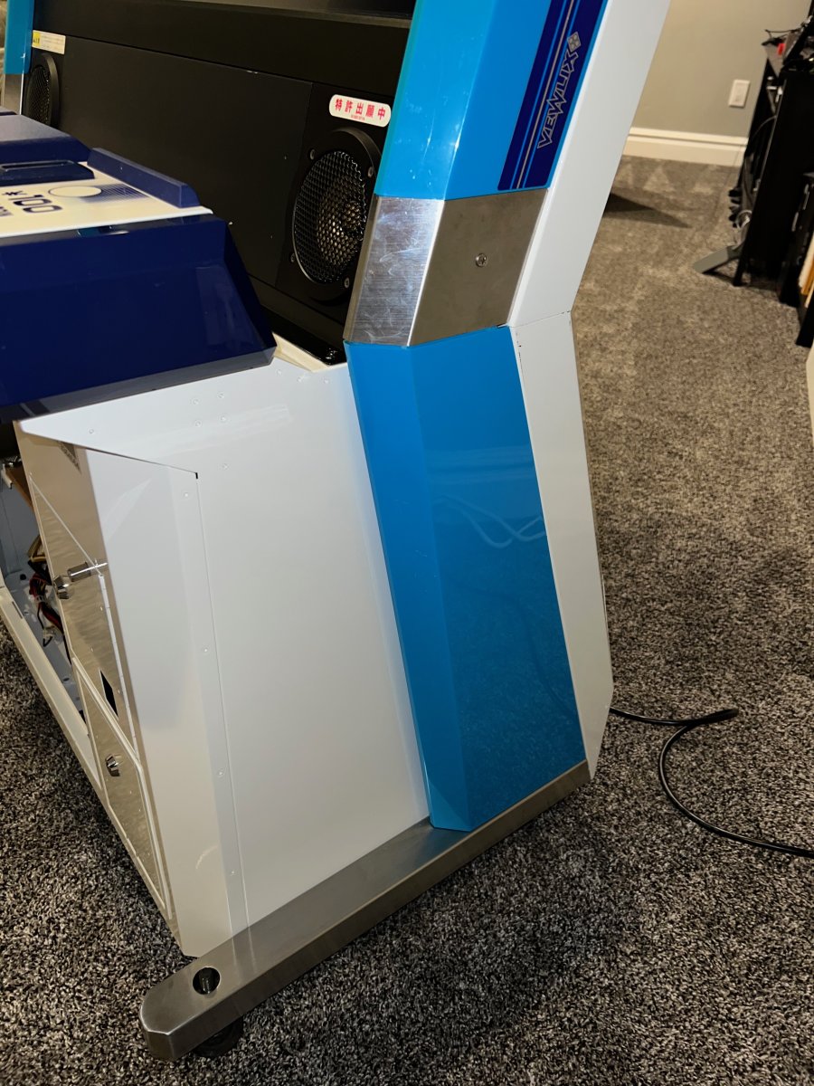

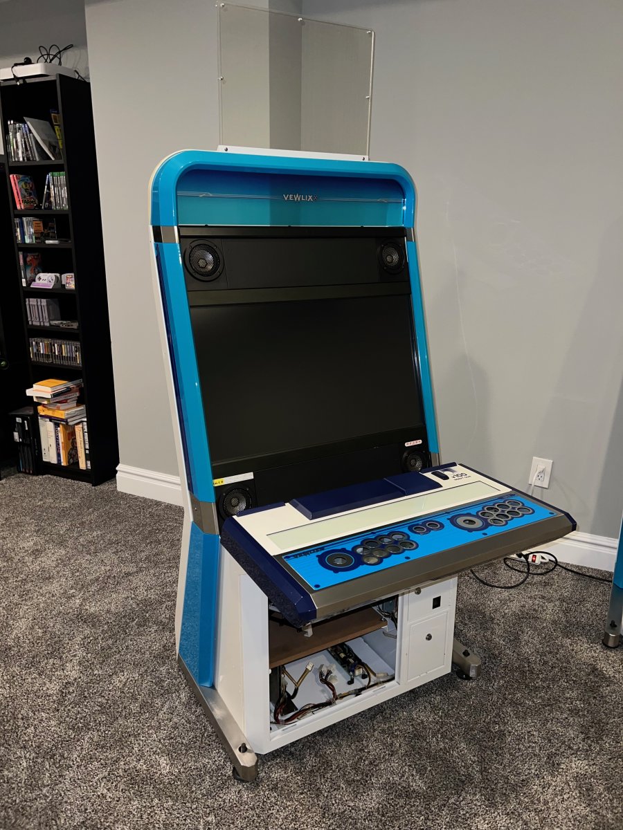

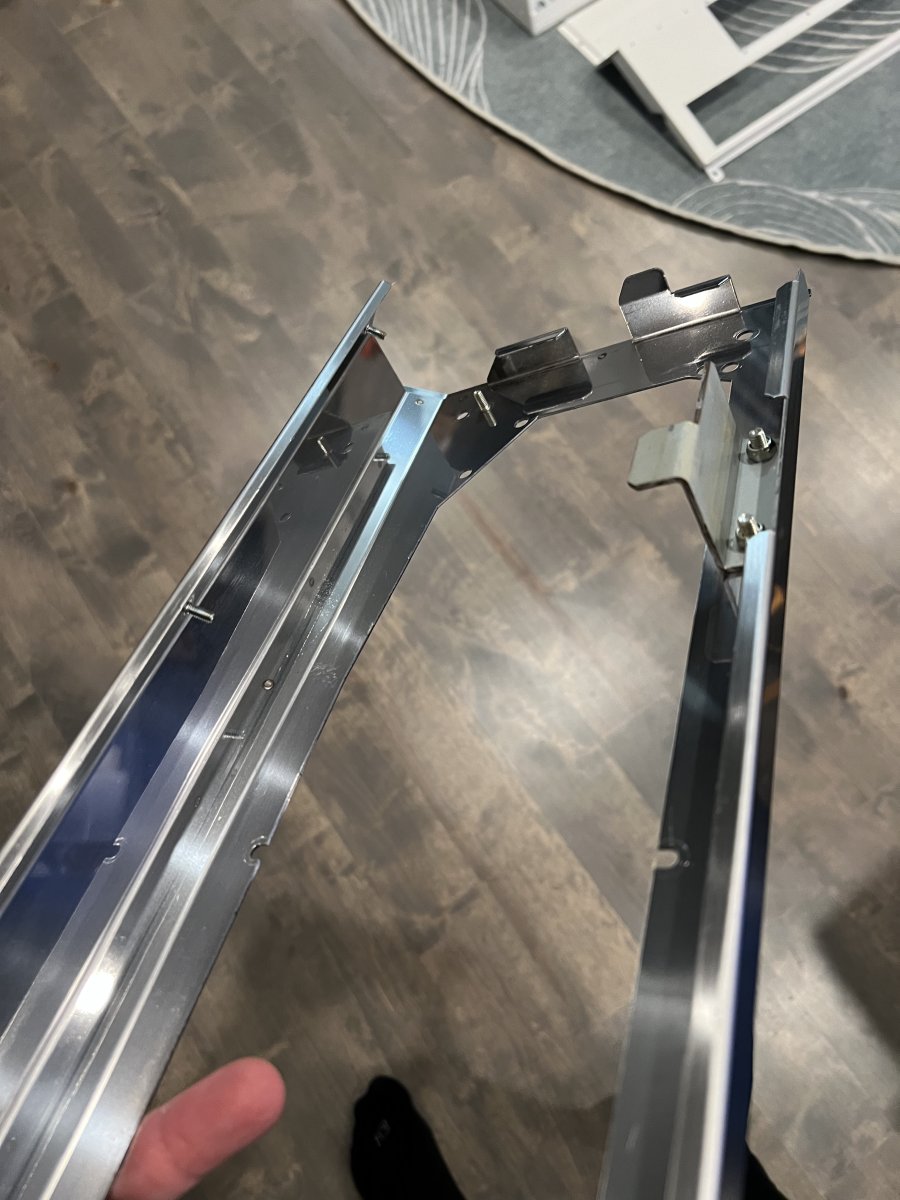

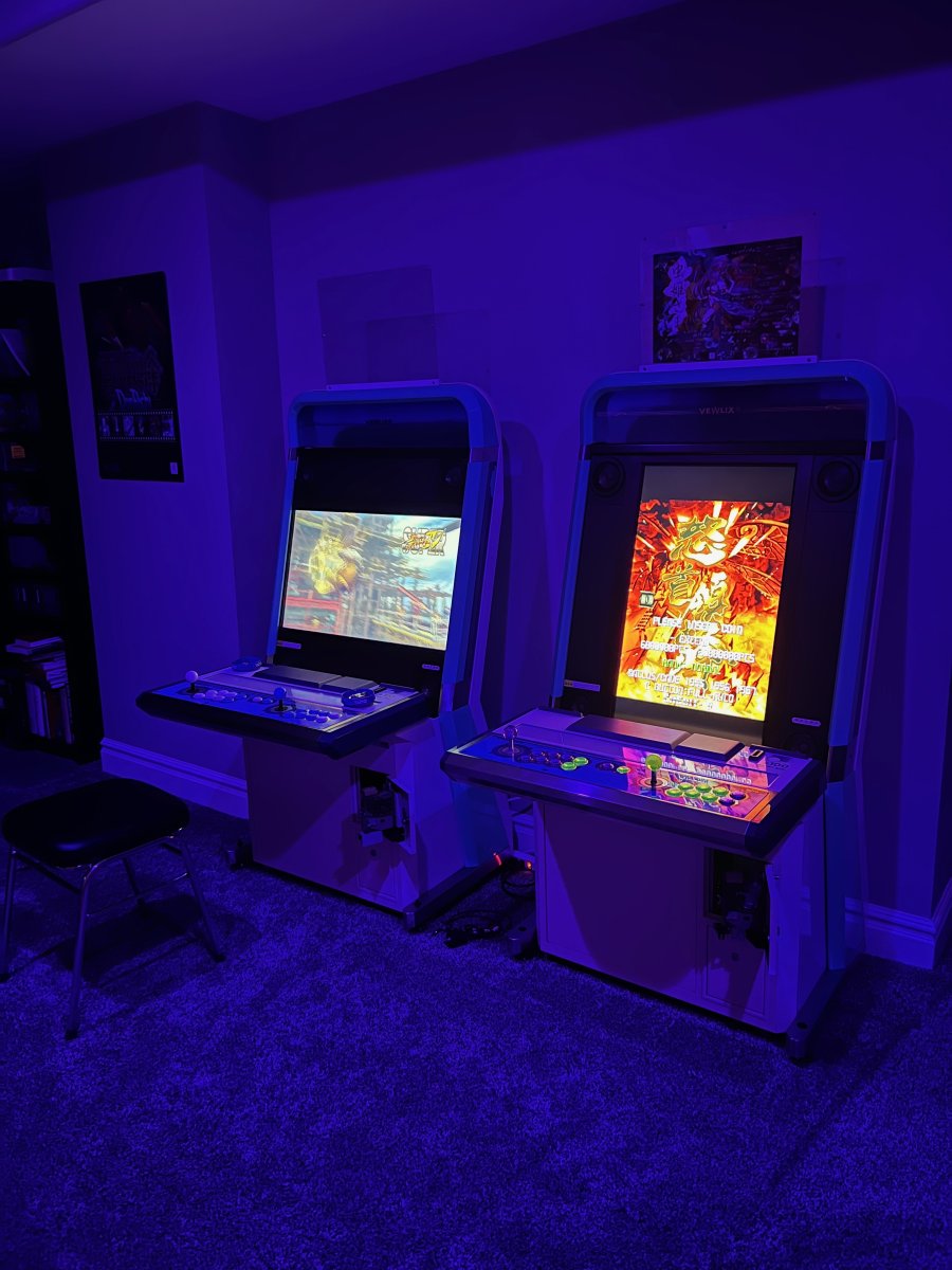

Decided to have one cab Tate, one Yoko. This photo shows I clearly placed the speaker wire in the wrong spot, lol. I went back and fixed it later. The monitor here is the original.

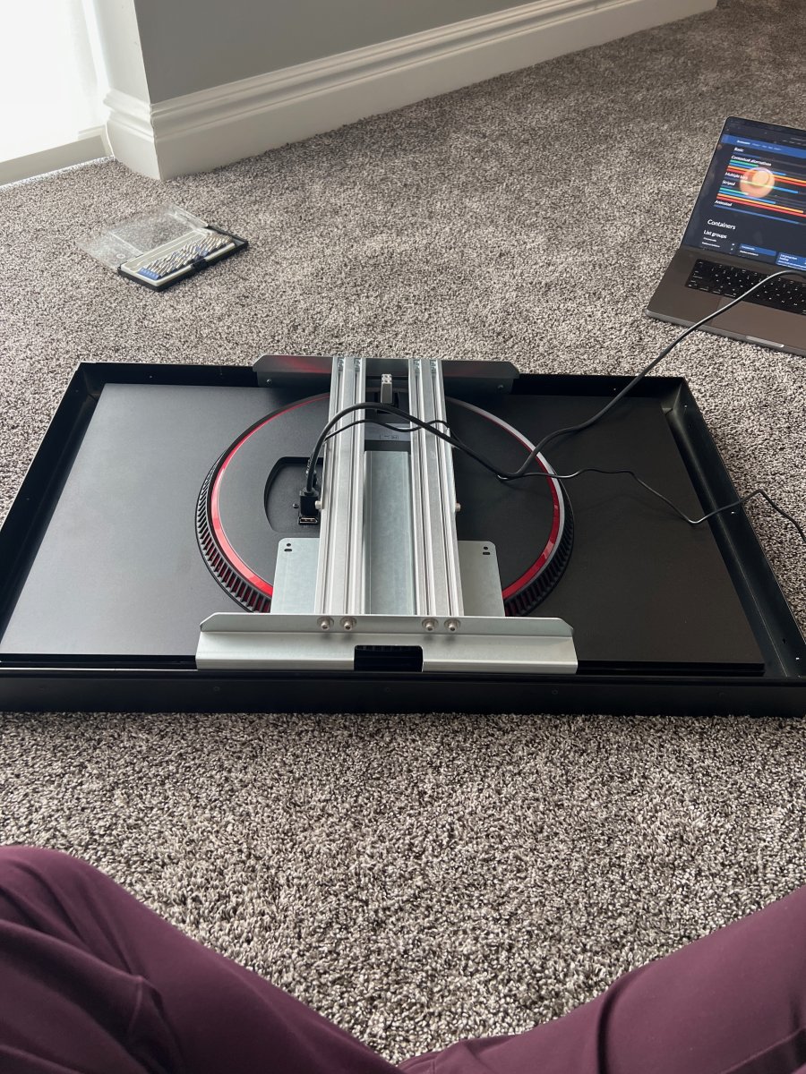

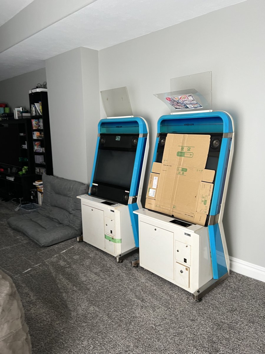

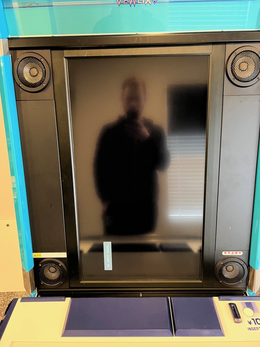

The plan from the beginning was to put new monitors in here. Well I did this around Christmas so there were some good deals going on. I grabbed two new 1440p monitors from Walmart for $180 a piece. These fit perfectly using @FrancoB 's mounts! I got those in and they've been such an awesome upgrade.

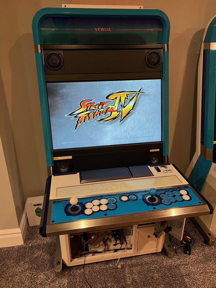

That's mostly it! These really aren't too bad to get going. Thanks to the @Arthrimus board I have some Reflex and Brooks boards in there and using the original harness. Also big thanks to Lemony again for hooking me up with a P2 harness and getting a spare sound board for me! One of these came without. He came in super clutch.
I got a couple Xbox 360s for them and plan to build a steam PC as well. They're a real blast; and as much as I love my Astros, it is kinda nice to not have to worry about the maintenance of a CRT, haha.
Since I have one Tate and one Yoko, I'm working on an Aurora skin for modded Xboxes that is Tate: https://github.com/ElRojo/xbox360
Feel free to check it out! I am just doing it in my free/downtime so work on it is a bit slower right now, but I plan to reskin as much as I can so that it's fully usable in Tate mode. I also replaced all the buttons to correspond to the arcade buttons so that the UI is a little more user-friendly.
That's a wrap on these two!
