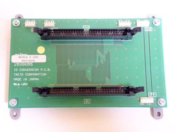

Don't put a Sega IO in there, the power lines on the 60-pin are not in the same place, you'll fry it. Taito sold an adapter from one 60-pin to the other that swaps the pins to proper places if you wanted to use a Sega IO. They still sell them, they're like $20 brand new.
I dont have the taito jvs psu so do i still have to worry about frying the sega type 3 io?
Yes. The 60-pin Taito harness is not pin compatible with the Sega I/O's connector. You need the adapter PCB if you want to use a Sega I/O. I'll take a peek around for mine and get you the part number.
The 60-pin connectors are even keyed differently so you can't accidentally plug Taito into Sega or vice-versa.
To adapt you need:
Taito part no. K91X1207B

I'm in the same boat. I just picked up a pair of Vewlix-F with fastio pcb's installed but fortunately they both have the Taito PSU so I'm OK to power most of what I want to run.
I also managed to pick up one Taito JVS PCB from YAJ so I'm sorted for one cab I also have a spare Sega JVS PCB (from a Naomi) but no cabling for it.
From what I gather you unplug the fastio PCB and plug the cables into the JVS one (apart from the card-reader) and drop a USB cable into the base if using the Taito JVS card.
For the other I'm going to have to use the Sega JVS, so I'll need Taito part no. K91X1207B which I replace the fastio pcb with - then what from there, how do you power the Sega one and what cables do I need to go between them?

You are probably more likely to find a Taito IO than to find that part that converts from Taito to Sega. I have had no luck finding it for not a fortune.
Taito was selling them less than six months ago at ~$25ea. Not sure if they still have any.
No wiring just the PCB.
