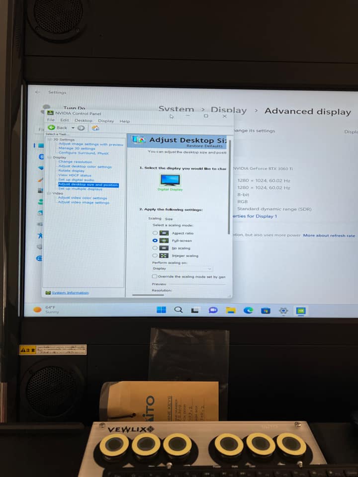

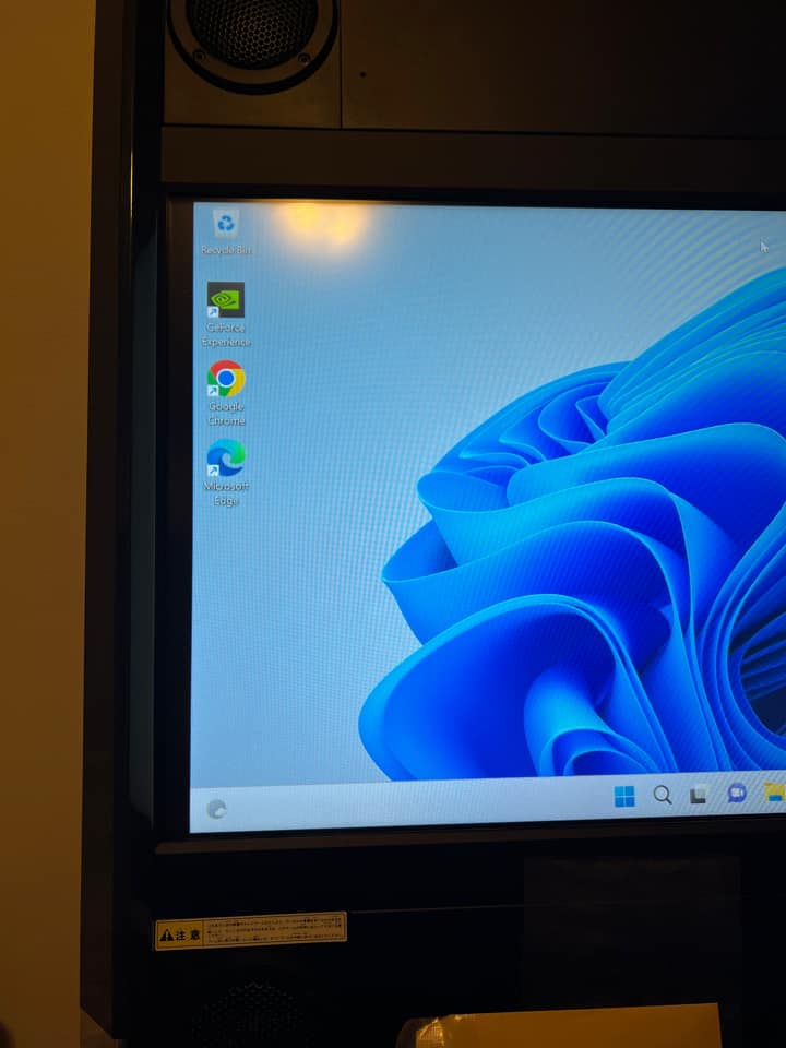

Hi guys when i plug in the pc in the vewlix diamond black the screen is offset to the right about an inch. using a nvidia 3060ti cant find any options in the nvidia control panel to adjust it. also tried different resolutions updating drivers ect.. is there any hidden buttons on the monitor that i can press to move the screen back to the center?
one thing i found is that if i lower the resolution to 1280 x 1024 or lower i get the option of putting the monitor refresh rate to 60.02 instead of 60 and that allows me to set set the screen to stretch mode and everything fits on monitor frame but then everything looks stretched out. anyone else experiencing this and found a solution?
tried different vga calbes to hdmi and different pcs also has same problem.

I just had a similar problem this past week on my Vewlix F except it was offset to the left. I was also using a VGA to HDMI. I swapped to a dvi to hdmi (then a hdmi to DisplayPort active cable) and the problem went away. I’m not experienced enough to tell you why it happens but I just wanted to share what fixed it for me.

With VGA since it's analog, the monitor has to set the phase and position. The F monitor has an auto detect and manual adjustment in it's OSD. I'm not familiar with the DB though.
That said, a digital signal (dvi-d, dp, hdmi) is a better option. What are the inputs on your monitor and what are the outputs on your computer?

monitor has vga and dvi port. im using a the stock vga cable with an hdmi adapter on it.
also tried using a different vga cable to hdmi cable had same problem.
my pc can do displayport and hdmi. built new pc to run it on the vewlix

I don't understand why HDMI (computer) to DVI (monitor) wouldn't work. That's what you should be using. Set your resolution to 1920x1080 and try a different cable.
