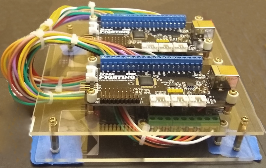

Would be nice to have an actual PCB to connect both to (just using both sets of connections on the UFB right now), but that's a whole other subject.

Yes, using the terminal block version of the UD decoder. Just connected terminal block to terminal block. Used the 20-pin on the UFB to connect my control panel harness to. Potato quality image of my little setup. You can kind of see the UD decoder down at the bottom there.
That's what I figured, sweet, smart thinking. I have my control panels wired up to the 20-pin too, so I could definitely do the terminal to terminal approach.

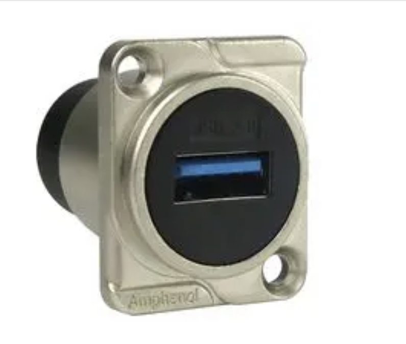

There are two rear mounted Neutrik USB ports (thanks @Ziggy Cheetos Dust !) in the middle of the panel. Ideally I would like these towards the outer edge but they would foul the mount I have my Brook UFBs on, so for my panel they would need to be somewhere around there.

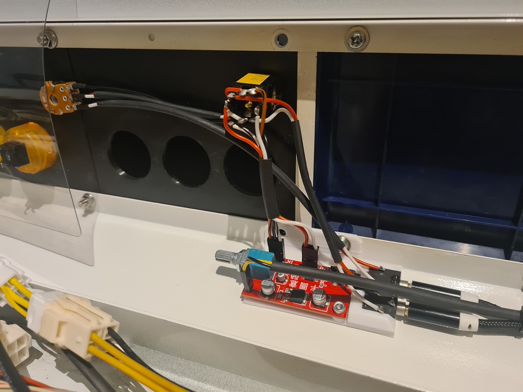

Then there is the volume control and a 1/4" jack. I'm using a DPDT stereo jack along with a headphone amp, a B50K pot and a few other sockets etc:
With no headphones inserted the voume pot controls the line level audio before it goes to the Taito amp and cab speakers. With the headphones inserted, the audio is cut to the cab speakers. The (sub panel volume pot controlled) line level audio then goes to the headphone amp and then to the audio jack/headphones. It works really well, it's just a bit more 'wirey' than I would like. If I get some more time in the future (lol) it would be nice to consolidate more of it onto a PCB or two.
Once again, it's not something I'm expecting others to want/need, it's just what I using on my panels.

Nice @FrancoB. Glad you liked the rear mounted USB. The model I used was this one:
Thanks for the info. I assumed you had used a Neutrik one, [this] one. We can compare dimensions but I imagine they'll be the same as they're intended to fit patch panels. Luckily there was a step model on the Neutrik site so I grabbed that.
They will dictate the panel thickness anyway if you want to flush mount from the rear. I had to tap little threads in the panel to screw them in.
But even top mounted they look more premium than the plastic ones.
Measuring the model, the height between the end face and the flange face is 3mm and so would suit a 3mm thick panel. This may be a little too thick. If a thinner panel was used then washers or a 3D printed spacer/gasket could be used to keep both parts flush. ~2mm may be a more suitable thickness. I'm thinking of using M3 self clinch studs to mount them as they'll be easier to install from a production point of view. For a 'one off' I would have tapped them like you have. :thumbup:
