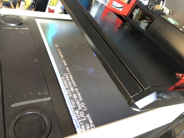

So just picked up a Vewlix vs (first time having a vewlix) I know the IO thing has been talked about a lot.
was hoping this was gonna be plug and play.. never that easy lol

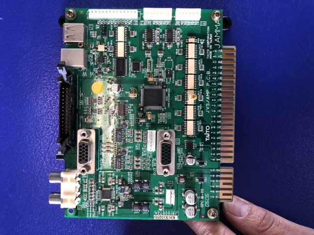

trying to figure out my options for operating a single taito x 2 multi in there. KC sent me this jvs to jamma I/O I’m assuming I’ll have to rewire controls/service/test/coin with a jamma harness.. which I can do.. question is How do I power this board. Do these type draw power from the jamma harness or a jst connector? USB??

Thanks for any direction.. I have a taito x2 working in a NNC if there is something easier to do for just the cp that would be ideal.. I think I may prefer a typical sega or taito I/O with a 60 pin connector idk..

I can use for splitting video at least lol I'll keep buggin kc he said he may have this I/O hope so...

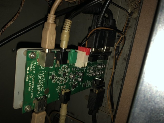

nope either, use for X4s with some some specific games. USB Io, required a customs harness also.
need one of these for jvs games
Say I could use the ones he sent? How do I power the jamma one I have a jamma harness laying around I could use. Does it pull from the jamma edge or one of the jst connectors. If not I’ll start Hunting for some sega I/Os

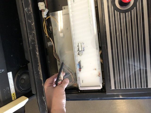

Also I don’t think this versus has that 60 pin connector so I don’t think I would need the adaptor? Would just need a 60 pin for controls from the sega I/O I’ll double check tomorrow
The pinout on the 60pin connector is different between sega & taito, this why you need the adapter if you want to use a sega io in the vewlix.
The jamma edge IO he sent you is meant to adapt JVS games to Jamma cabs.
They do have have “G” connectors 2 of them 1 for each side I guess I could get that and wire a harness from 1 player panel to the 2 player side. Or do a custom harness straight from the sega type 3 to the “K” Connectors. Ordered the I/O gonna keep working on it
ordered type 3 from Yaton but idk when it’s gonna show cause of all the shit going on. Also the sega converter gonna build a k > j wiring harness and pull it through to the p2 side Thanks for your input @Derick2k
