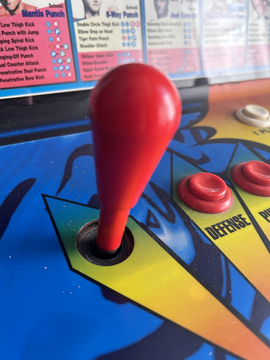

I noticed on my Virtua Fighter 2 original cabinet the left joystick is a bit loose. No issues with contacts or anything, it responds no problem; the left stick just has way more play than the right stick which I find a bit annoying. I’m new to the Model 2s.

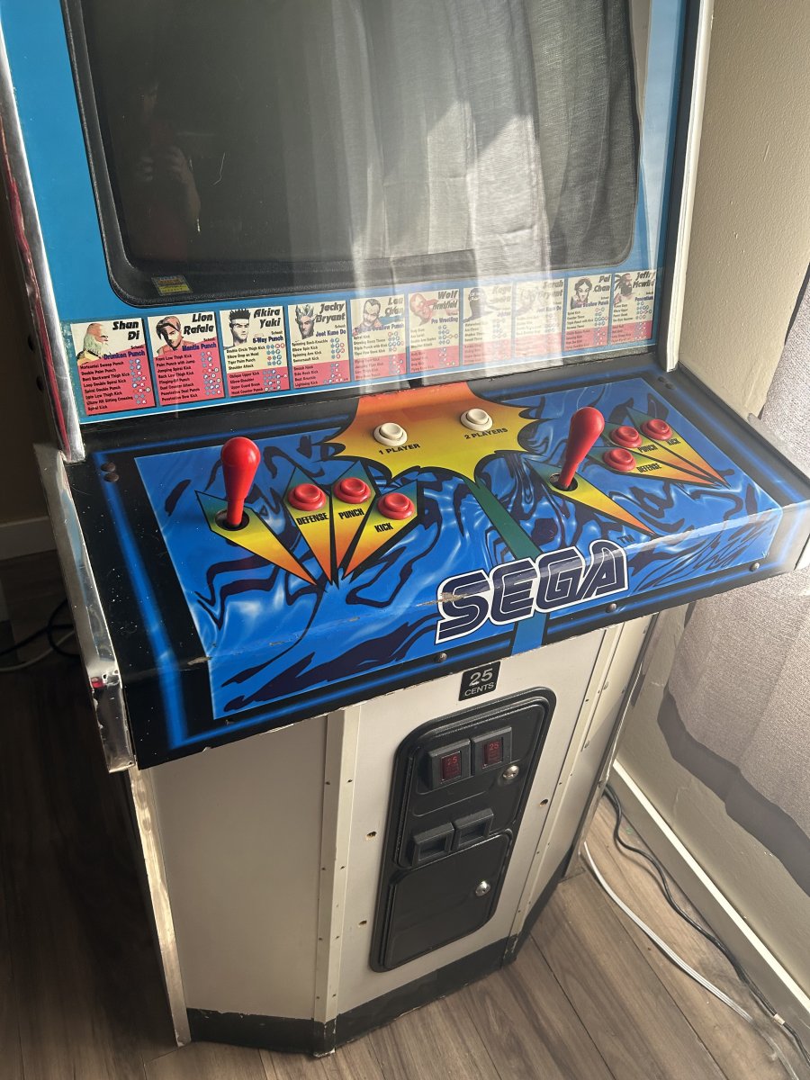

Yep! Here is the affected one. Can’t really see it visually

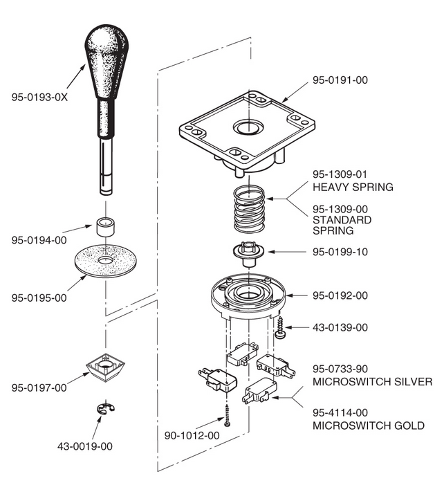

these are not sanwa but happs "competition joystick" also known as spring galore american joystick! (https://na.suzohapp.com/products/joysticks/50-6070-160)
Your control panel probably has 2 latches that allows it to swing back and open ... you'll be able to "see" the issue a lot better once flipped
ps: You're missing a dust cover (95-0195-00) on top.... which also protect pinching your hand/fingers

With the schema above, i think you are equipped to disassemble that joystick and perhaps find what is wrong! You might have to order just a broken or used part but these are very cheap joysticks and you could simply replace the whole thing for 10$.
