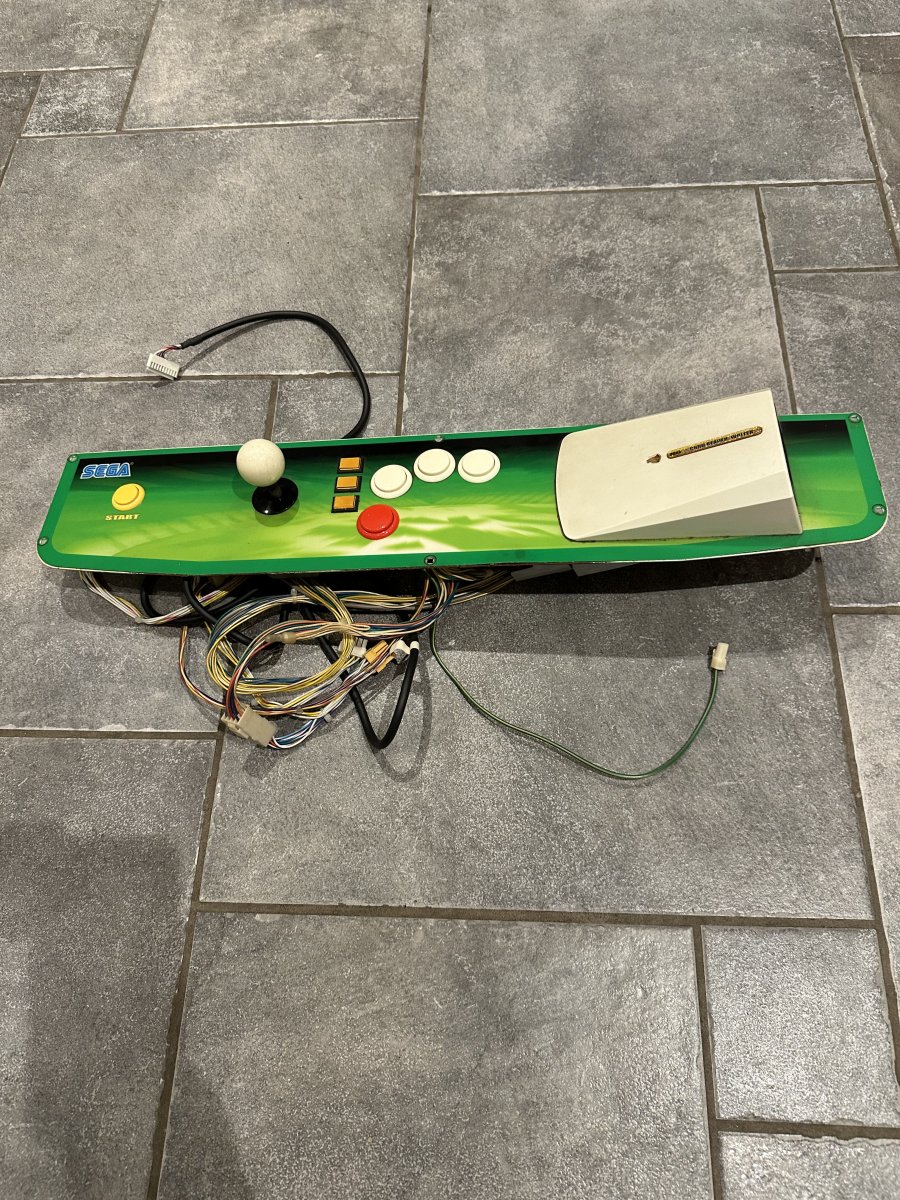

Does anyone own one of these VS4 control panels with the card reader?
I am hoping to connect this up to the Triforce to unlock all the hidden features within the game. There’s no information in the game manual on how to connect card readers. I have a Triforce manual on order, the information might be in there, but it won’t arrive for a while. Can anyone help and show me all the cables and where they go please? I think I have them all but not 100%.

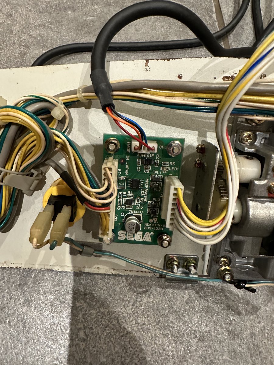

Thanks for the link. Have looked at the schematic and the reader PCB is a Sega 839-1233 on this panel and it has a different pinout to the one on ghost squad.

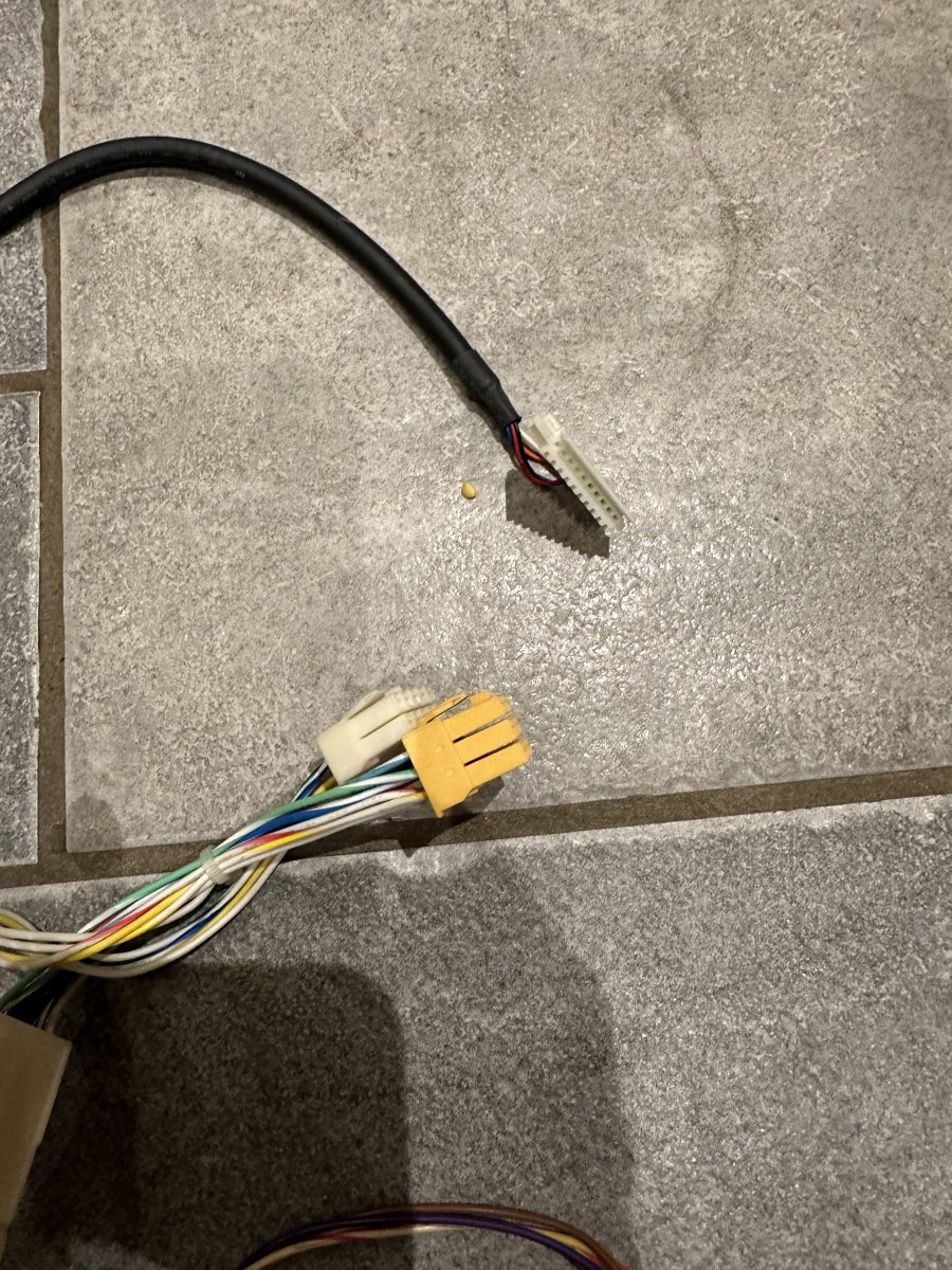

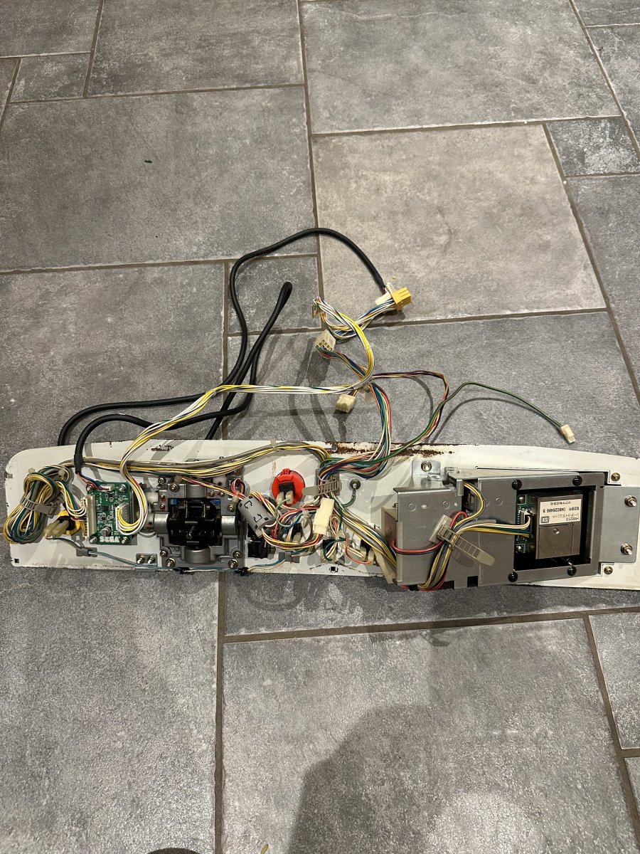

The long black wire harness connects to the Triforce motherboard. Some wires will connect to the JVS IO.
Show us what you have.

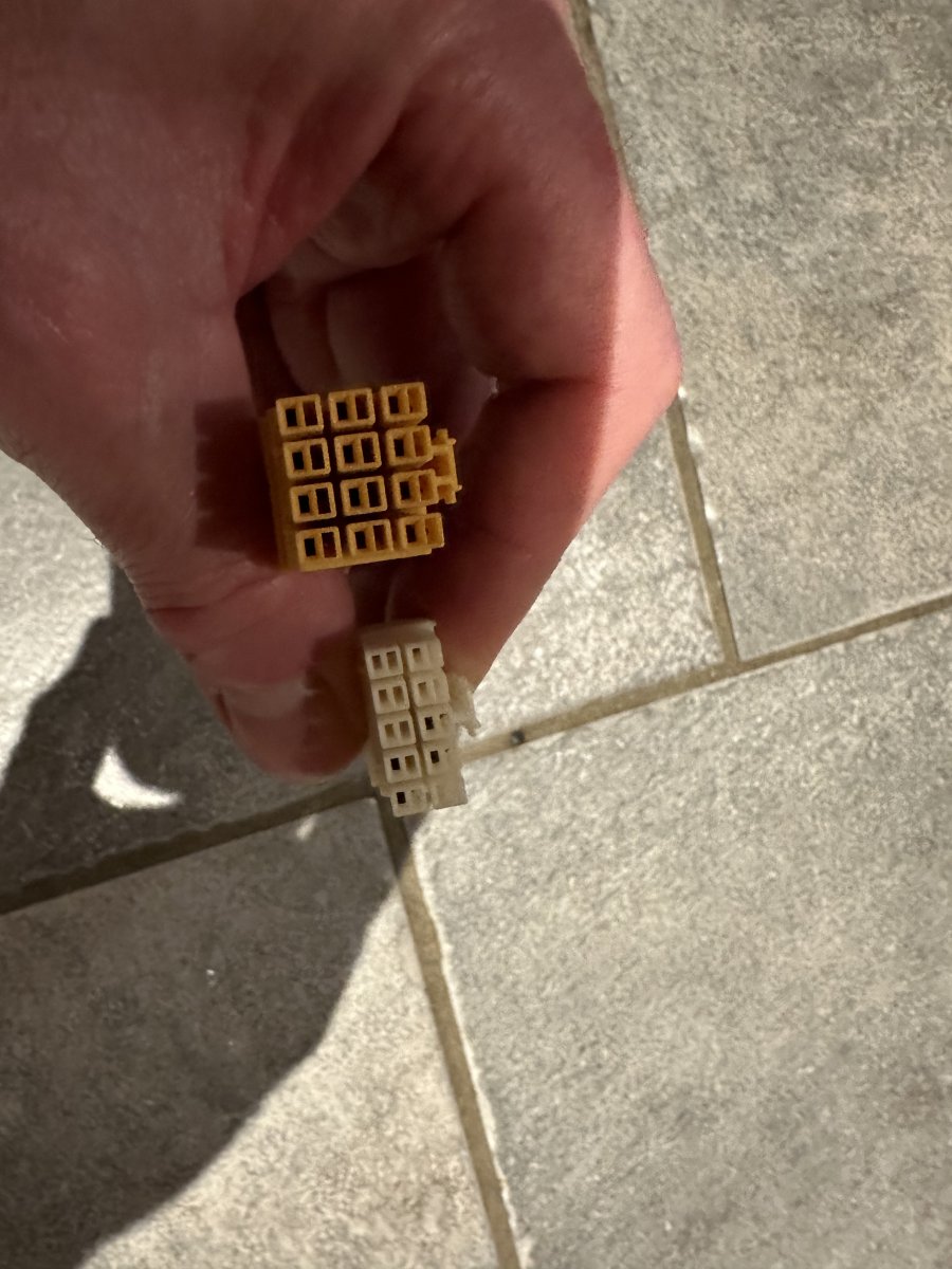

Here’s what I have. I have ‘added’ the 8 way JST connector and 5 way micro JST black lead on the PCB from another panel. What I don’t quite understand is the 8 way JST goes to the 2 player and kick harness connectors in the cabinet. Not sure what the card reader is going to gain or receive from going to 1 player or 2 player controls.

Any chance while you have the reader out that you could take some quality pics of it :) Inside and out?
