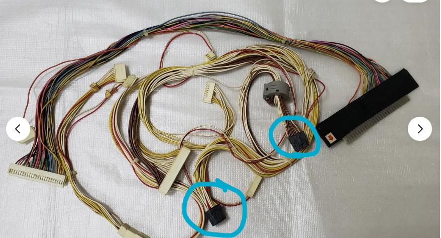

New Astro/Astro monitors support medium resolution so it'll run on the display, like sonicfan said tho its hard to tell without seeing how ur cab is set up.
The VF game boards pull too much current for the tiny JAMMA edge finger. The model 2 is looking for 5v power on about 15 pins on the filter board and just as many to ground.
https://www.arcade-projects.com/thr...d-worrying-and-learned-to-love-the-bomb.8697/
specifically this post:
https://www.arcade-projects.com/thr...and-learned-to-love-the-bomb.8697/post-334200
So I’m going to need the model 3 harness in order for this to work I have a sega new Astro city wired for jamma I have no issues playing my Naomi on here when hooked to the capcom IO
Your best bet might be to get a harness that can bring these 5v and ground lines to the filter board.
All of the controls, RGBS, and mono sound can be handled by the JAMMA connector with this thing you pictured:

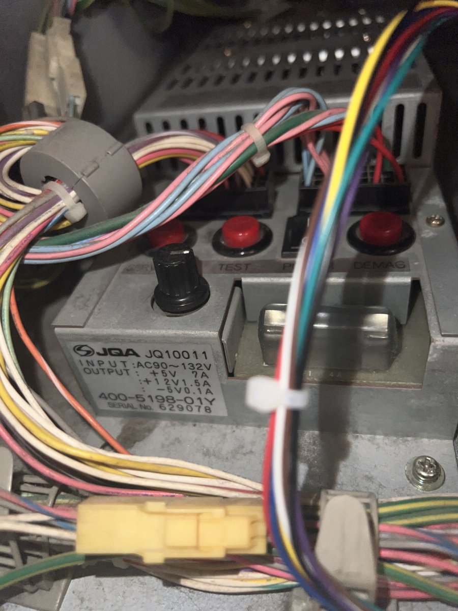

I am in the same boat Virtua Fighter 2 Rev B. I see adapters to power over Jamma from ebay, but not sure what the move is. This harness is one that I already own.
I have a spare sun power supply I wanted to use. Will the 5v black amp up connector connected to a sun PSU through this harness suffice to power the board?
So i would need a filter board with this wire too ?
Yes I do I thought you ment on the harness

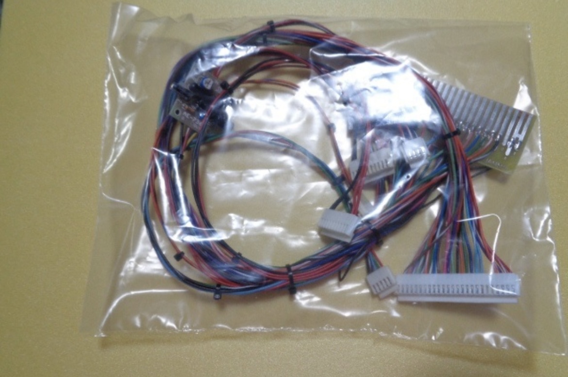

@Krec9 Both that filter board and the shape of the main-board indicate that is a Model2b. VF2b runs on a Model2a board, which uses a different main board, a separate video board, and a different filter board. Can you take a picture of the ROM board so we can identify the game?
@Segafan1985 Theoretically, yes. The 2a would only use the two power connectors circled in green here on CN3 and CN12.
