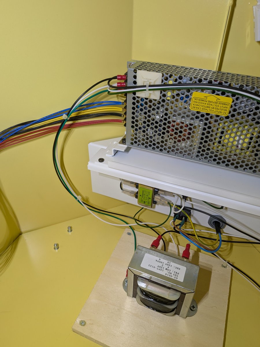

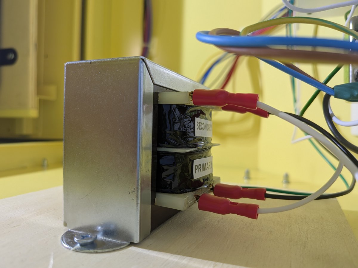

I got this iso transformer:
https://twistedquarter.com/index.php?main_page=product_info&products_id=376
I wanted to make/buy a harness to get the AC from the existing harness, but couldn't find the connectors. So I ended up getting the AC from the power supply's connectors. Then made a harness with the Wells Gardener's female power connector for the k7000 chassis.
Here is the female connector and pins you need to connect the chassis' power:
https://www.mouser.com/ProductDetail/538-19-09-1029
https://www.mouser.com/ProductDetail/Molex/02-09-1119?qs=jBHU5RPckUpH2xgojJNbXA==
