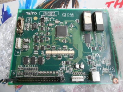

I'm still looking for a Taito JVS PCB for Battle Gear 3
This pcb has two numbers:
J9100556A
K91X0951A
There seems to be none out there.

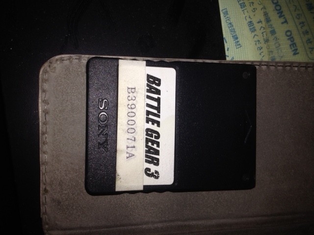

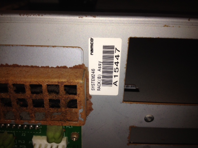

Hello, I just got here looking for information about battle gear 3, I'm from Spain and just bought this twin cabinet, but the system 246 not seem to work, make beeps when you start and nothing else, if anyone knows what problem would appreciate .
I can also provide them the info they need about the taito pcb-jvs for the project.
Sounds like it is recognizing the dongle as good. Most likely the DVD drive has died on you.
It could also be the whole system246 has died. And also Battle Gear does not use DVD. It's a HDD, so maybe that has died, but this is the case for both units? No image on the monitors?

Also I do know that BG3 will boot to a black screen unless an IO board AND the proper wiring to the analog board are in place- if brakes, throttle, steering aren't connected correctly or have come loose - or the IO board isn't powered up/on, the game will boot to a black screen...
Any and all photos or details of the IO board would be much appreciated- I've only got a low-resolution photo at this point.
Also, if you could get dumps of the eprom, that would be much appreciated!

The two units only show black screen, but one does ding ding ding and cut, I will try to take audio sample. the unit that makes ding ding ding, is a substitute I'm using an original Time Crisis 3. When I picked up the cabinet not to ding any pcb, I do not see any LED on the pcb taito jvs, you could make a dump of the EPROM today same.
