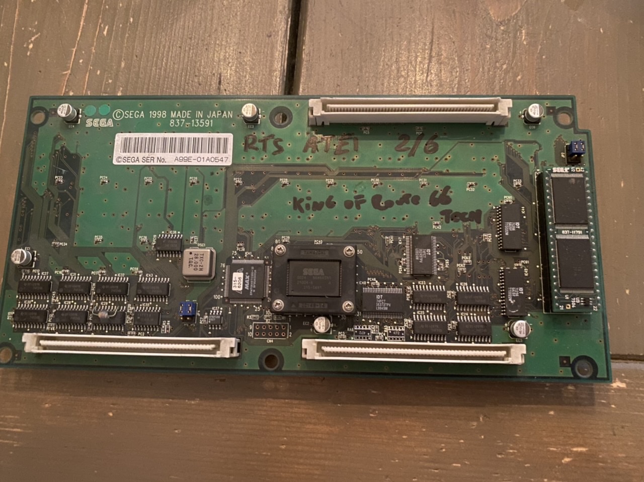

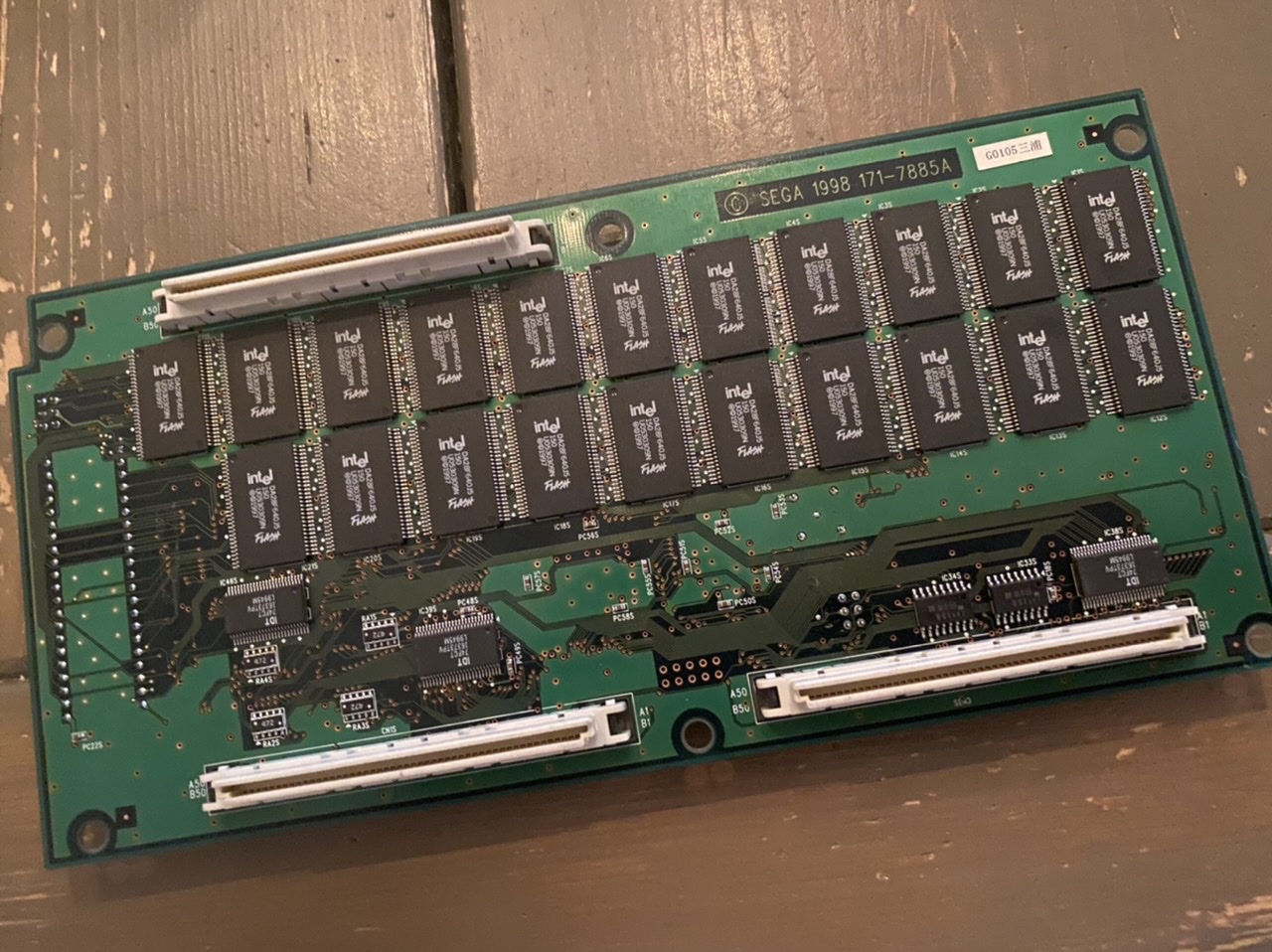

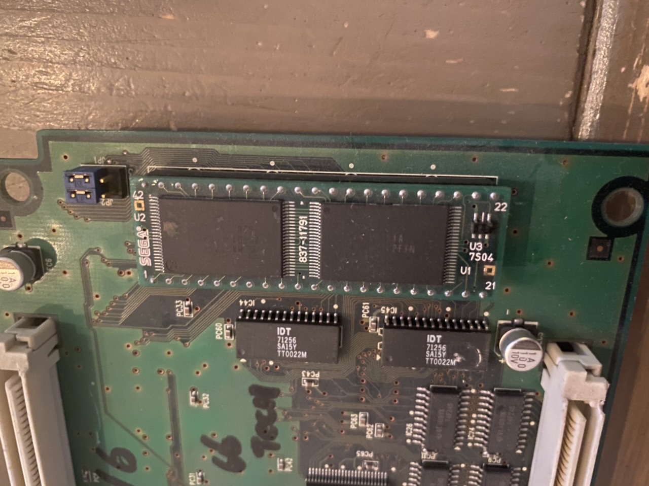

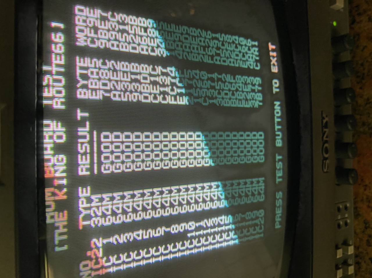

Cool I have one of those programm Naomi boards laying around and some test cards used on some shows with the flash and the screw down sec chips
@MetalliC I have a undumped king of Route 66 and a early tech demo of f355 and crazy taxi. And that f355 Card can run on a Naomi 2 system little flaky but it will run :-) will dig it up and make a video
here are some pics:
