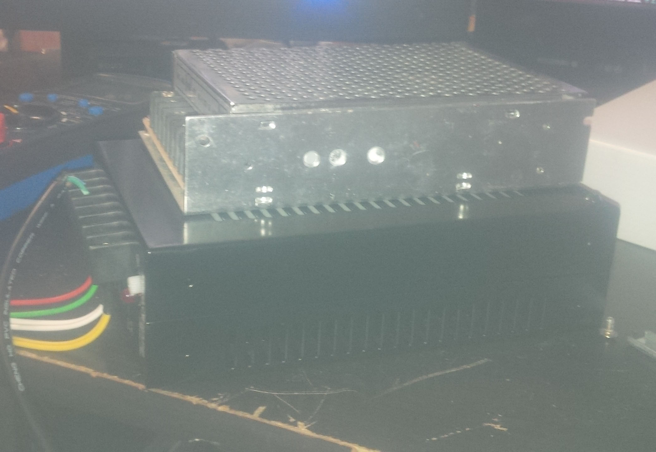

Here are some boring ones - this is the original power supply in the Pana Custom sitting upon the one I picked up for the HAS:
The dimensions are (inches): 6.5 L, 4 W, 1.5 D <-- the depth measurement is the most important one. If it is too tall, it sticks into the joystick.
I hope this helps. I assume that I need the typical power requirements for running CPS2 stuff.
I would go with the mean well or try one of the similar suzo happ ones.
