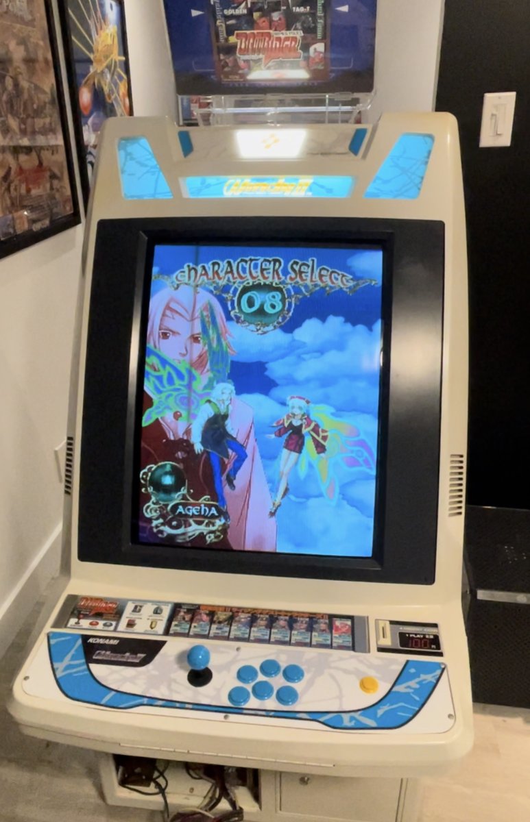

Hey ! just got back from a 1 week trip with my family: 7 days without playing any shmups is so long so i decided to fire up my lovely Windy II for one or two credits on ESPgaluda...
Surprise !!! : The monitor doesnt start , Chassis is beeping , PCB works but no picture on the CRT . No more beautiful neck glow either... ;(

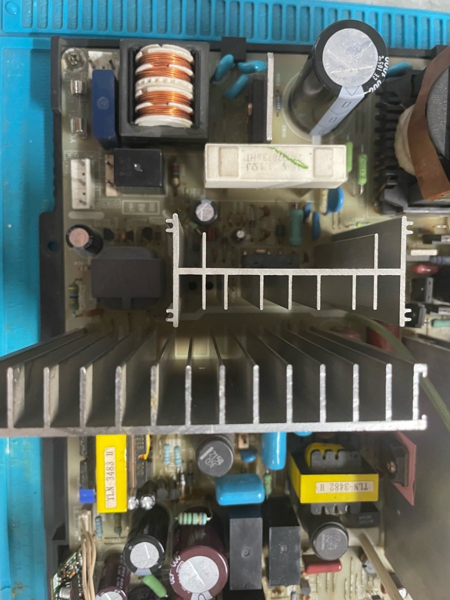

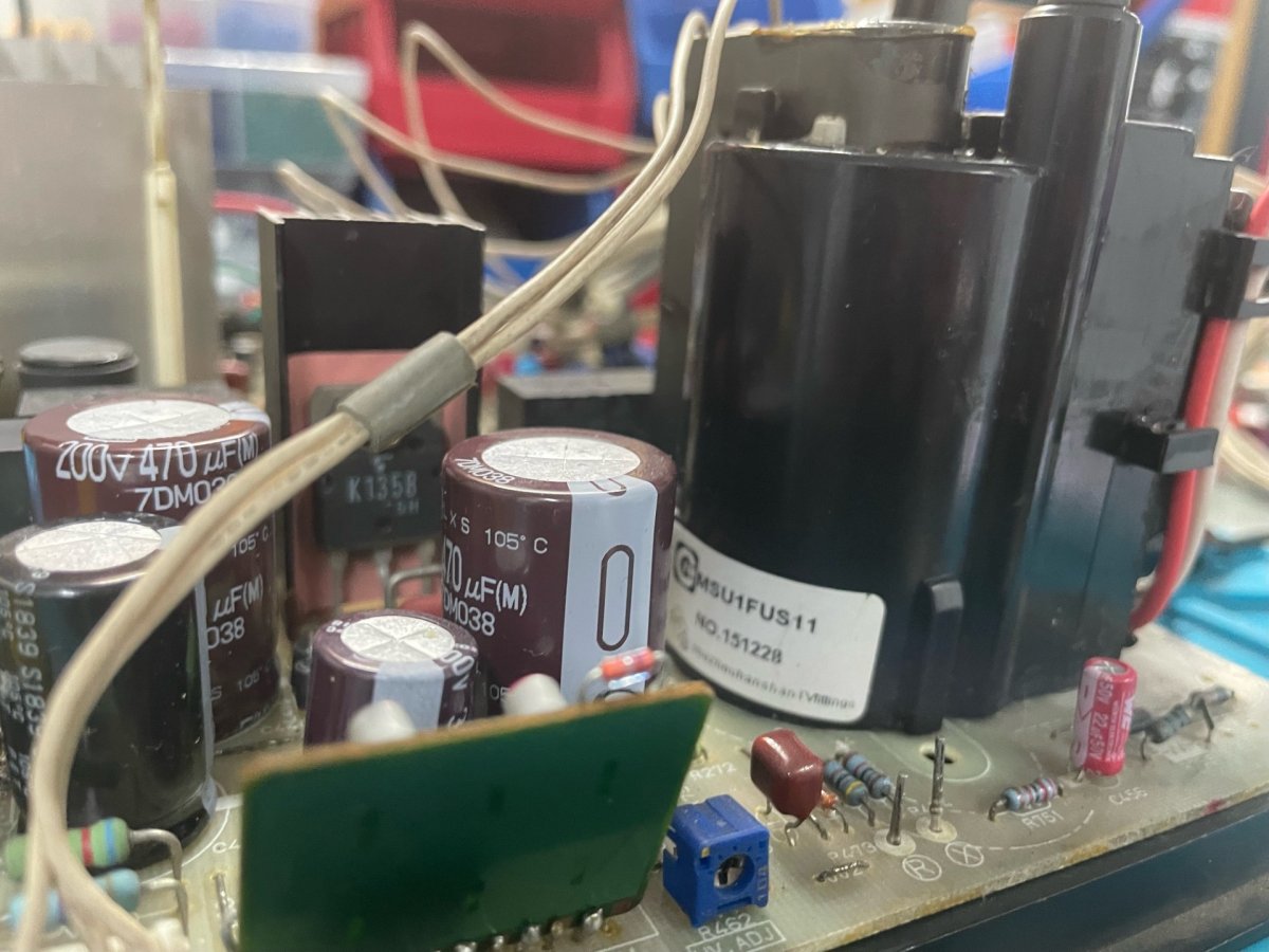

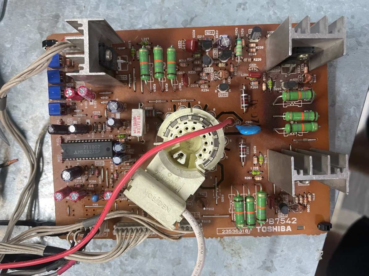

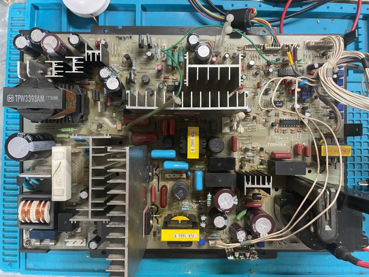

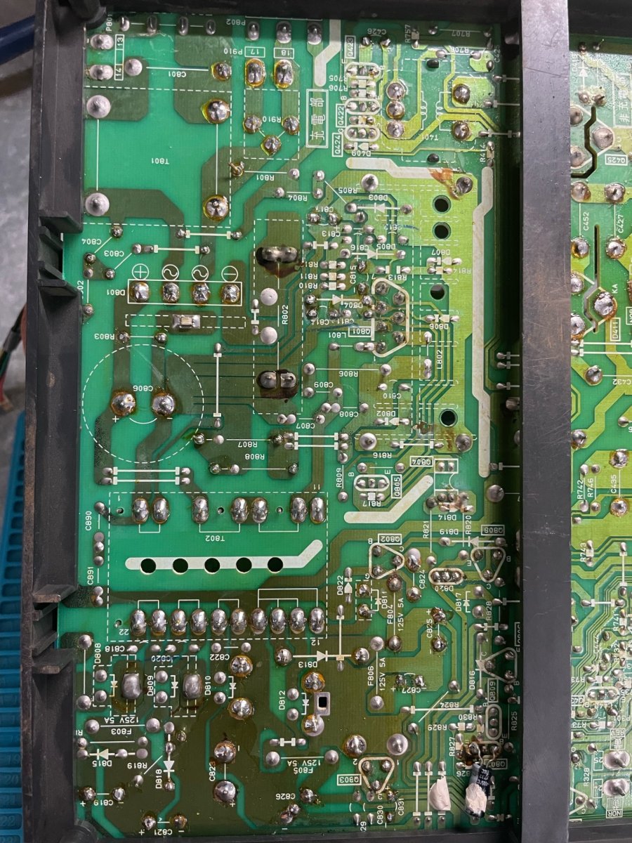

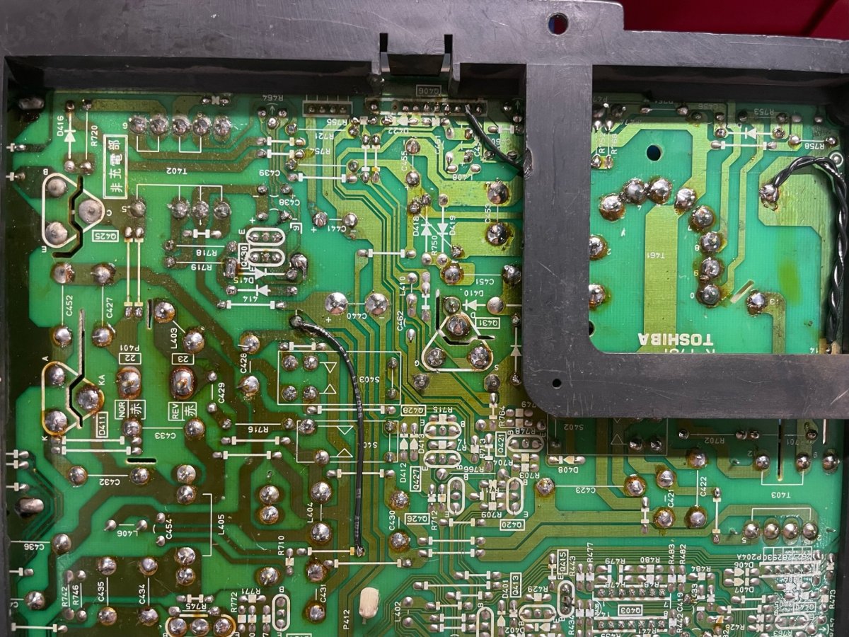

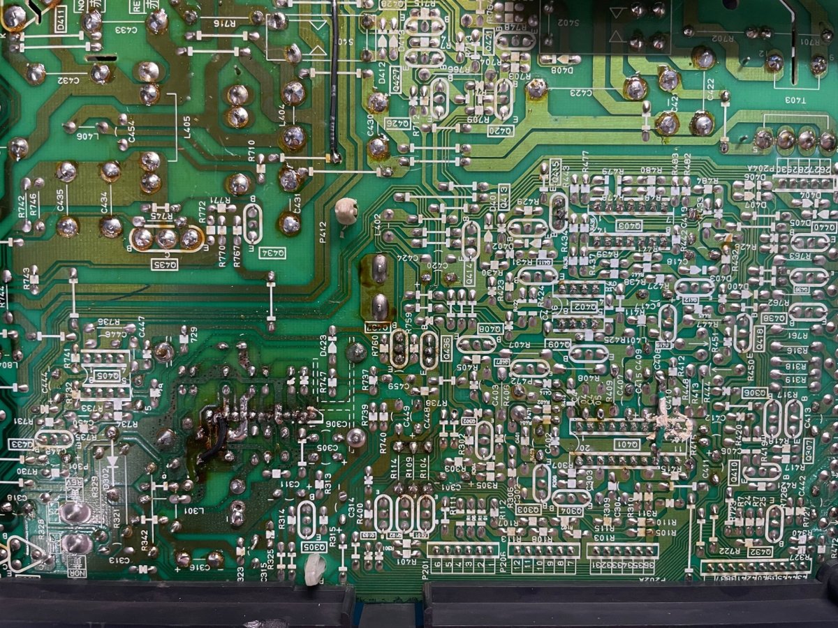

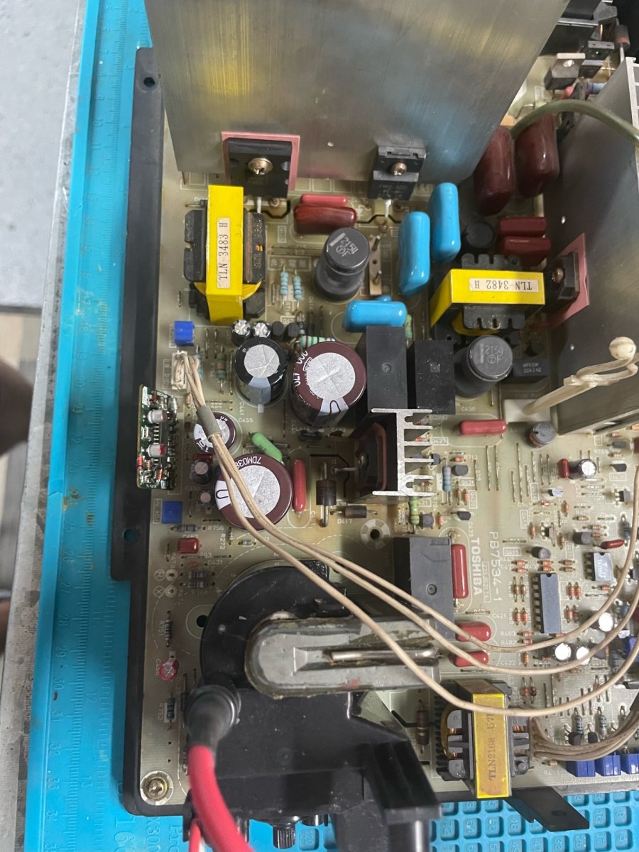

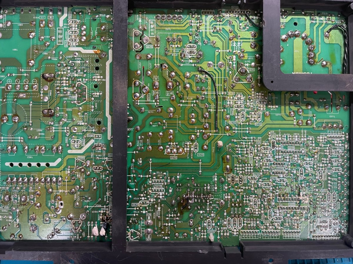

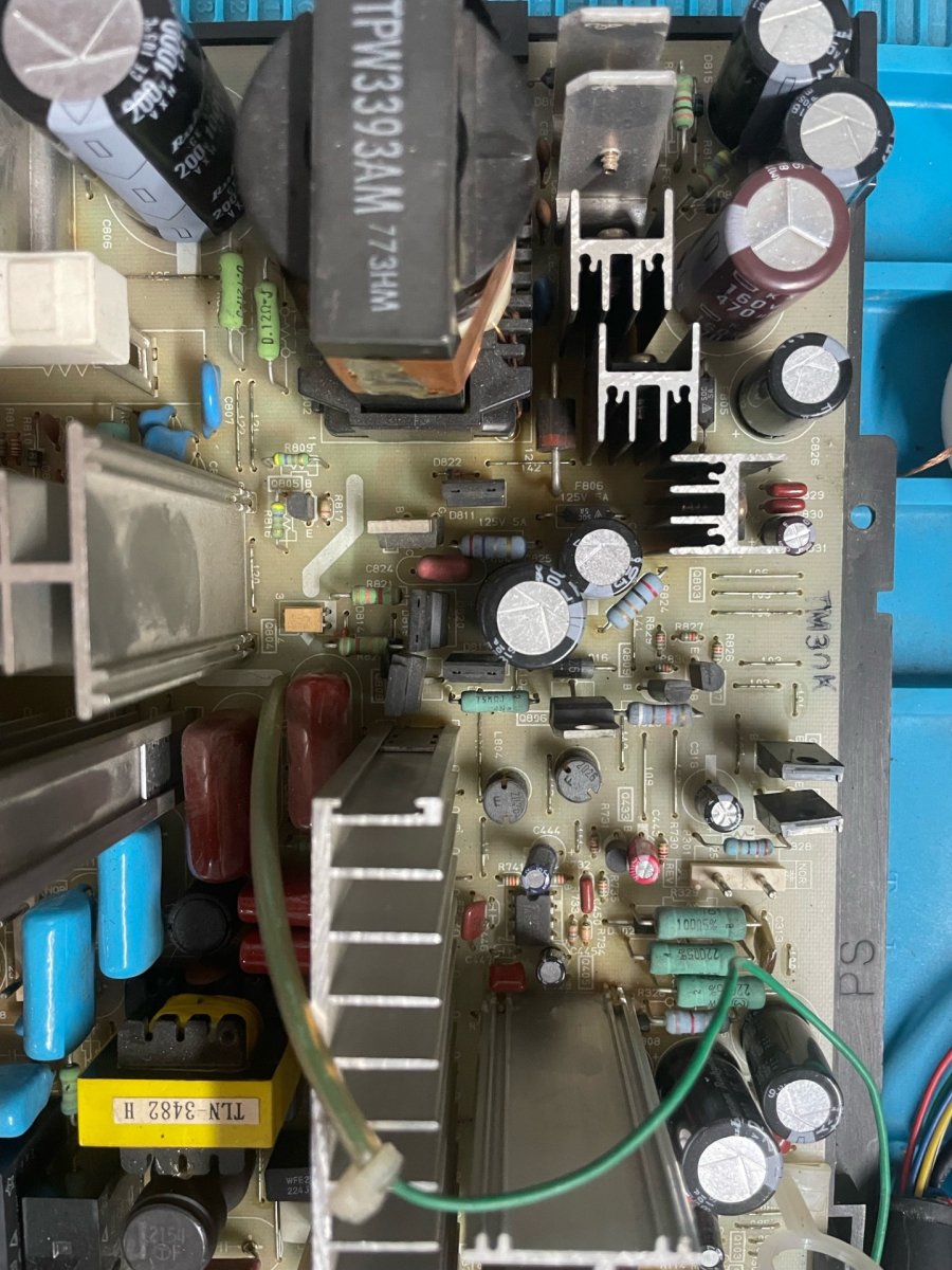

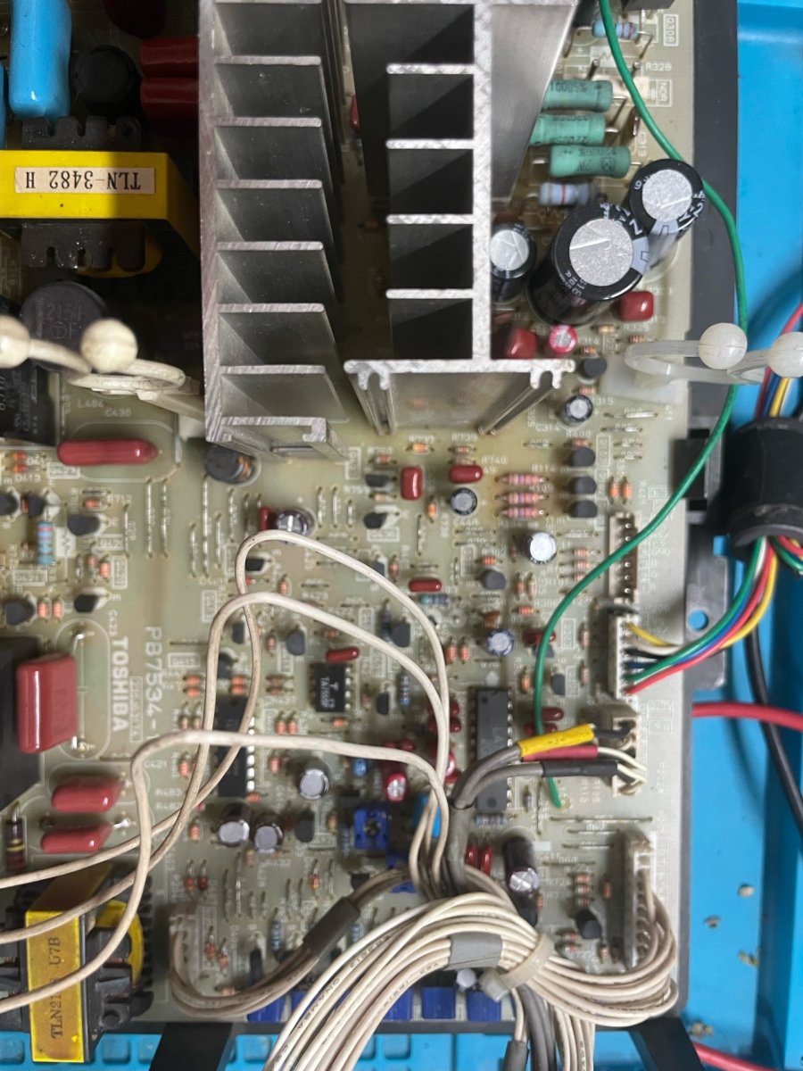

quick update: remove the chassis : new HOT is blown. So something faulty on the chassis before the HOT is causing the issue. Took a few pics of the chassis. It have been repaired by someone on this forum a few years ago: I was not the owner of the cab back then : ( new caps. new flyback, repaired traces, something else ?? )
there is a repaired section under the chassis that seems very bad....i have no clue if it have been "repaired" like this back then...
Will bring the chassis at @Mrhide 's workshop to troubleshoot the isssue. Someone have any hint ?
HOT's thermal pad seems ok. PSU is tested ok .
I might send the chassis to Sharp Image or arcademonitorrepair.com if we end up not finding the issue.
thanks for your help !

update : i decided to send the chassis to Sharp image to get it refurbished. Since it was already recaped and had a new flyback: they ended up replacing the faulty vertical IC and blown HOT
Since i forgot to include the remote board in the shipping ( my bad.....) , they werent able to fully test the chassis before sending it back to me.
Plugged everything yesterday: i
  • i know have a neck glow! but no image on the screen. Tried with 2 different PCBs without any luck . sound is working.
  • no usual crt startup crt "clicking" sound when it get the video signal
  • chassis gets the video signal from the pcb: normal hissing sound when connecting / disconnecting the vga cable from the jammafier.
  • i have the usual static electricity on the outside of the crt when touching it
  • i heard the degauss sound when i press the degauss button but nothing on the screen appears
  • some "white glow" on the screen when powering it off. Nothing when powering it on .
  • no beeping sound from the chassis (HOT have been replaced)
  • messing with the remote board pot does nothing on the screen
  • messing with the flyback brightness pot does nothing on the screen...
Every wire is correctly connected ... triple checked
Anyone have an idea of the NEW issue ???
thx
The last chassis I worked on where everything seemed to work but the screen pot did nothing was a bad neck socket. The G2 pin was not making good contact.
