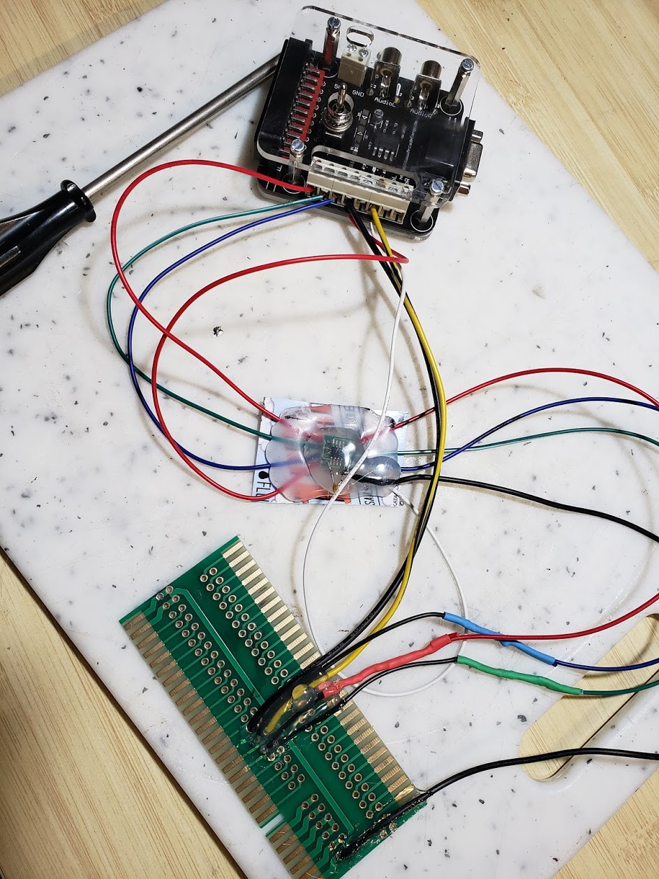

I'm posting pictures here of my build.
You can see what I'm doing for testing.
I can see why you need the amp.
It looks like it needs a boost on gamma or pedistal.
I had to tweak the monitor to at minimum see if I was getting RGB.
Pictures to my album. You can see the recent screwing around I did there in detail.

I built your amp but still have a dark picture.
Can you please double check my work?
Your pictures and your description in your post doesn't seem to add up.
Current picture looks like last time I directly wired to the SyncStrike.
Amp apparently is working because I disconnected it from the scart solder edge, and directly fed it 5V.
Picture is still "dark" and I have to crank the monitor's gamma to see a sub-par serviceable picture.
There's just not enough brightness or chroma.
EDIT: Would this have anything to do with my MVS-wired cabinet?
The monitor is a wells gardner K7000 series 19"
Thanks!

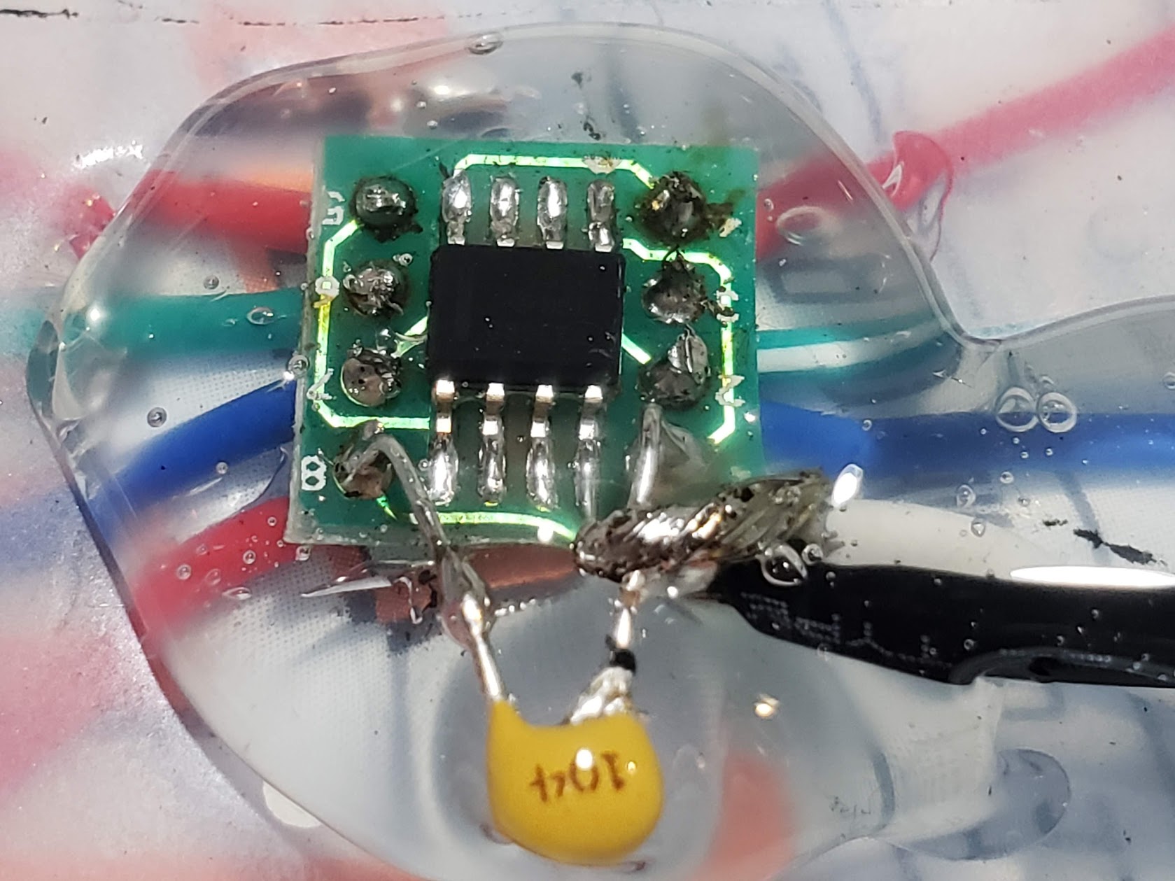

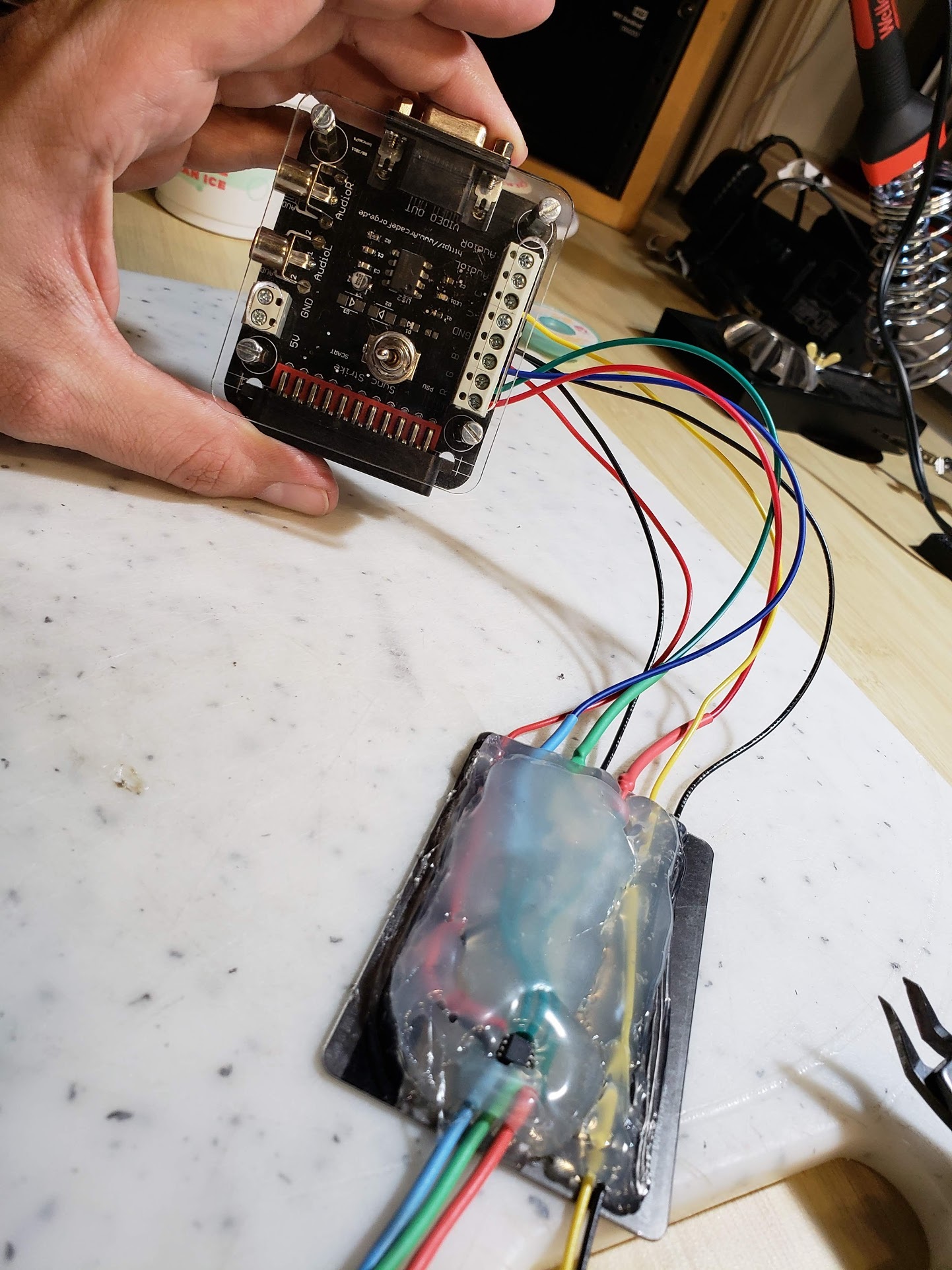

First off I still got everything on the list for testing.
75 ohm resistors
7316 amp
SOP8 PCB (DID I GET THE RIGHT ONES?
.1 Capactors
9xPXgt6bFGF05LH6cjQknfKQMEA1LQR9SqzLEiqJ4-1FYQlVdUjHBApnTLwY4edcueSN7OiLqB6aFkIXIjWDBNxoYJwg0xyzYPOoKB3ibTT6a40WZMG2y2GNe0JikhkLyss54UvChi65uINIOD36f29jJ8KPA-xtUmQ4i-u2hgKBd6TmTxW4cYtNhU_mQJxvGg03PIQbswX99Bl0NyOGpVJGOwB2VyYhcevEBYlq5wCnij9yyQXwcCi_Gs7JevoRwwJF_90pGowAl0p7PoPZ1Axf__IGK9ZR1J0DSRemho7JoFKbSkGZ0FdVQa64R6VTd0PwiLa3OANd_g7wOwueM3sCYv1wve03P4a_Q54mT_zPBEfOss7zX8VVYjfoUg6iT3Vj7nycr6EMk1QUwtHWHI0fkIGi5ahPefg51-g80kJwK-6G0NtYzaZdP5NvncNIICZJC1atPrMZrFdBL1mdM2fIcA1smf90TnMLrEFpBJjJ21xNwS0QM5X1baAWZnjScQ0VBfVX9Oh9e4u4K2D1SE7avivc3rksPAjH6e9jo-laCWcMc0ja57ZNqT1v90pk9tn57TXEhcts7X1kxTLMBsneEoDaeXf8xyAyDzgIFDicCrHFDet0FnxFyxQnnu-yahWYoHvXAfMa3e59SyiDCLbRyw=w1920-h1441-no

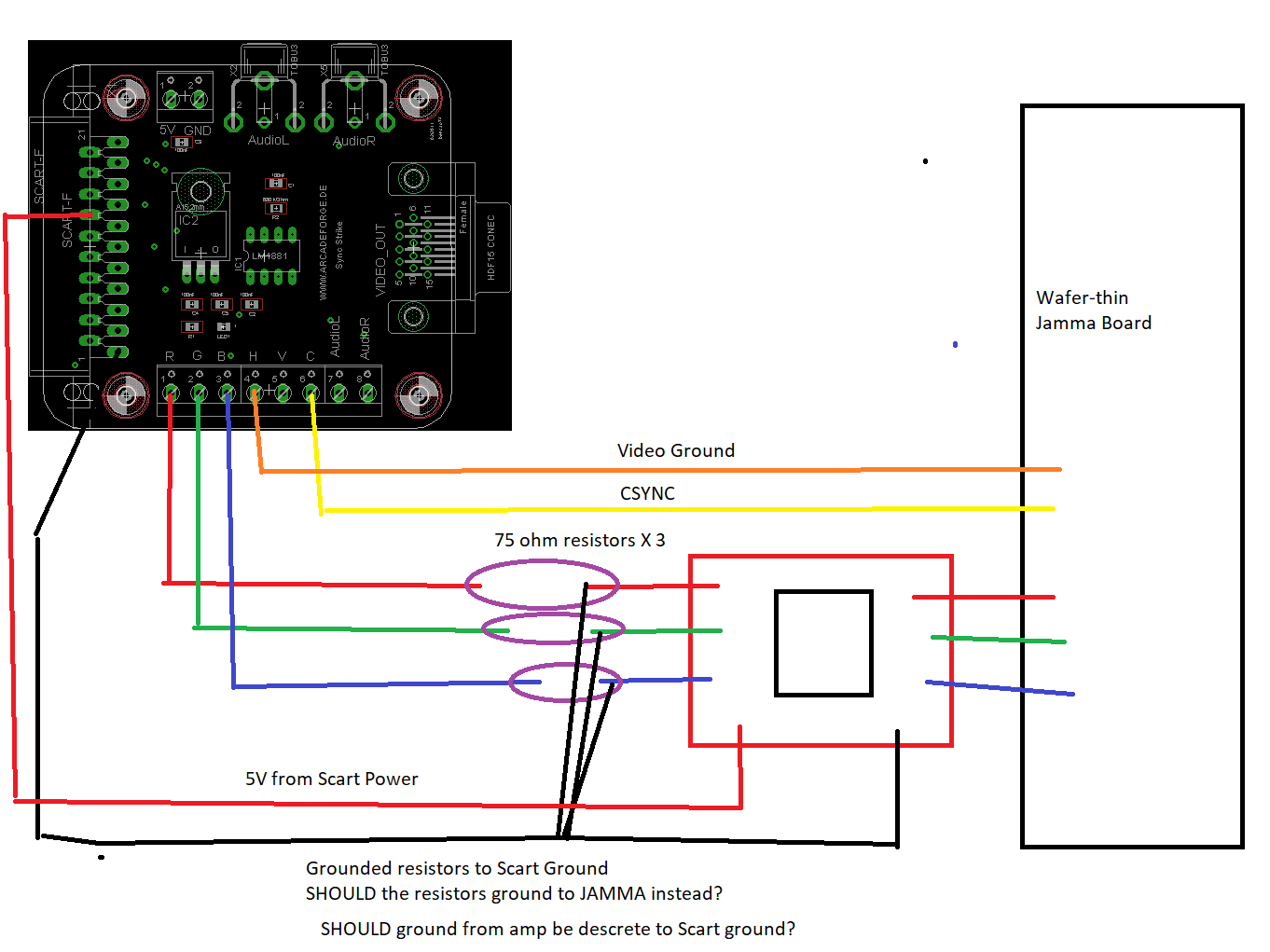

Your amp has resistors BEFORE the chip tied into the chip's ground on the way out to the Sync Strike solder edge for ground.
As it stands the ground from... Chip - Resistors - Sync Strike solder edge.
Here's a crude-ass drawing of how it's wired currently...
Should I separate the grounds from the resistors to the Jamma edge ground? VGround?
Perhaps that's where I screwed up are my grounds???????
I also didn't include the .1 cap across the power on the chip.
tLM_tY7WWaMoHABMrDnDDNm-P6RzjMgCu7r_rYKMp_bZtTWk0ULYYS50uNcKDd_b6z6Ol9zyYVCBVYUoNPhgIHVFkz_F7wkQIn4OF6cy4ow3M2O8cy_EqBcBN_HdW7INVPuOwkjjzn8U7jEqFy0py3LlgfaX5TZYuy-eQiNbCLdpKJ_1UTPyboPfQ0ScTbJcA4zipkdQaW3nc6ynhdUiqneinX1EzwZccSflvOtCf5wGhRsMicsE4W6x49c1SG5s-rmaGoWEqcXasVJGnQOw26PU8_ZzpkUmXXLMYXXAzPy8t5_NvqFsaqBQwAKTzZf7wdT1QLuSvar7zR_3MVKZDk2LMgbj-jZLWN4ylJ2eTBJUQwAOO_1ZO6d9vhsiqdlBdqQ61AwDnjwlj4B8fST3r4cUM3BDjmmu8T6DE2a6uAfjoXedIh26rpTtu2UAN1n1YdiAFca6vj92PKAiwU6BxMPYC8cbPIIyo0rz3ZZuT8G7qWFNWU-Gj9gOcsgjDj7FwKzIK0OJrqGWkJuYac1_kdg6RXxEcHYoKvT4HQTy49YhSLG6aumBM9znKmHX5_DmfcU2XcEAedK4edpcnfjWoxOmocp2-UmLiU9ieBuBAnIXpuvnQ_7rcpODBDRKqe1RZsl1xtc3JBLvuo_MH2Fc_Tu19w=w1920-h1441-no
I have enough to make ONE MORE because I figured I'd screw up, so I bought extra parts.
Let me know if I did this right.

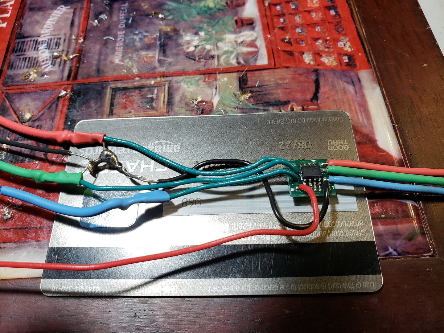

Also, your thoughts on the hot glue solution? LOL I was thinking of something for long term.
0p_Szzpe4d77DiWXwpq-yxzKomSjZ8LKJqjDdb_COSgOu3kfUmf1j2-tROV__Fl5U-4V1cH21ZbBFqlpXF9giUeQIRzQh5xBal0qk9VxsJrdaXjFOQvV7kj4ILDv0if8H2qb5UokgtecnbRzf8SQarMFmLnNvN6ymZIN7e9RzB8iJh7QWxlB3bppbjbpR0mkW6R-du1t4jh2wzyWTpNbNWYojSav3ub9YEDS0q3RAPRpL3syBDm76ccn_x2GXVzfPO2jrlhOhvA0EiwPjRY_VxffO2KxYrhIuBSixilRvLeIdM0Qodf4S69T1MPy93TtVbPd8aum6DqpUf6OGniWBig6exI0kzT3sehWzuCqWYZNn3pU1SJjt-lMaaThcUyHxS3fnIIQk1ZddrbBON-vg_e68MOgGLMDLvBxv2Ua1pMjUfnatuqF5nUnKfyH_xZqWZ7zd_9M6d7q7a8jr4cK4c6Q-UcQ09tF9fkzm4kbsWteq29RcrdvGfkPYLwJpNCuWDNozpQO1beVFGMpz4ByuksW5bPL2AHV4AyFjgi-rz5dBKKVU_bUF8Wb9MgGCSyY01mccgeKSTQnIkTBfJrQJia19M2cC4iE8MmTTcr03OCTFMtNqfngluJHpVvxT-XjCsPSlCrSFEYaa3g0FKYVPEkfBw=w1442-h1923-no
Thanks for any help you can provide.
I don't see any pics in your post. But the diagram you drew up looks right. Did you check with a meter to see if you made any solder bridges? Also, did you check the PCB if you have correct continuity before you soldered it together? You should put a meter on each of the chip's legs and confirm it is not bridged to any of the other solder vias.
My guess it is either a grounding issue or 5vdc power issue if everything else is in order.
Thank you @acblunden2 for checking my work.
Perhaps I somehow missed something.
There we go....
I copied and pasted from google images, so they don't come across *noted*
I tested with continuity, everything reported ok.
I'll hit it again tonight and try a third and last time.
I was more curious what you ran the resistor ground to.
Did you connect it in-line between the Amp's ground, and your SyncStrike's Scart ground?
Or did you wire that resistor group ground to something else?
That's the only thing I can think of that would potentially cause things to malfunction.

So this worked @acblunden2
Grounding was all over the place with your configuration with my cabinet. (ref: MVS-2-19 NeoGeo)
I was getting a lot of noise from all sorts of grounds I used that picked off the resistors on the RGB input lines.
When you mentioned Bob's design was more for PVMs and such, it got me thinking as you had a 31khz tri-scan monitor in your pics.
I wired up 3 amps in your config all sorts of ways and didn't have any success what so ever.
I went back to Bob's design, re-added the capacitor, and found that grounding the negative on the capacitor to jamma edge cleaned up everything.
GREAT SAGATA-SAN's GHOST!!!! IT WORKS!!!!!!!!!!
The resistors went back to the output positions per original spec.
Shmups are buttery smooth.
I hope this configuration finds you well for future troubleshooting.
Cool. Dunno why my instructions didn't work for you (EDIT: Also, that is a Nanao MS8 dual res monitor set at 15khz in my pics). But now that you got the video portion covered, next up is the audio portion. The Sync Strike makes that easier as you can just harvest that signal using RCA wires. Run that into an amp, then downmux it to mono. Feed that amped mono signal back into the fingerboard. You can also rewire your cab for stereo.
But as far as all that hot glue goes, good solder joints do not need hot glue.
