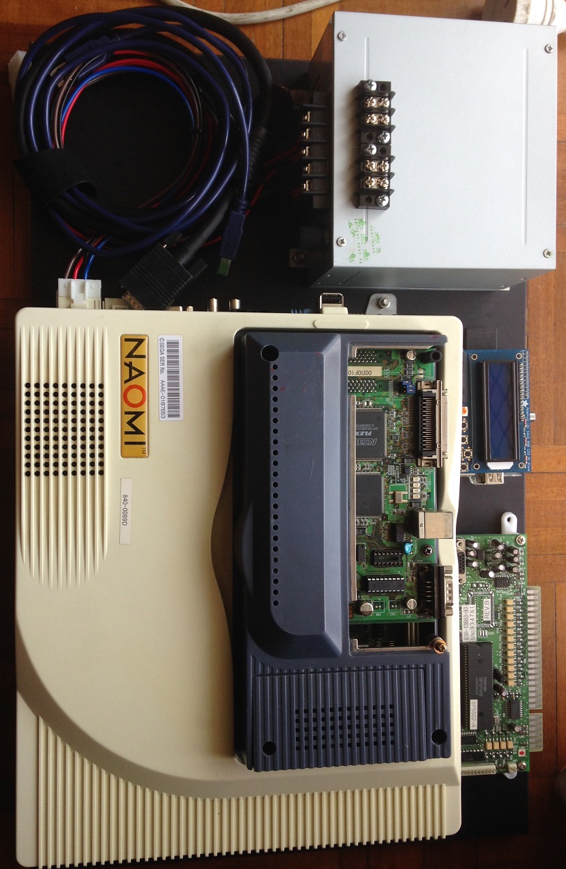

I have been slowly collecting the parts to put a NetBoot setup together for a while.
-I've replaced all the fans
-Burned the multi BIOS
-Got a power supply sorted
-I don't think my NULL PIC works though
I think I'm almost there just this last issue.

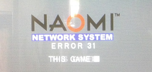

Then game boots to error 31
Using the python script:
evan@Omega:/mnt/d/TransferGame$ python naomi_boot.py SNKGD_SL.BIN
connecting...
ok!
length: 09800000
time limit hack looping...
This title boots fine!
Not all games work with the python script though. When I use the python script, some games do the Error 31 thing, for example Street Fighter Zero3 Upper.

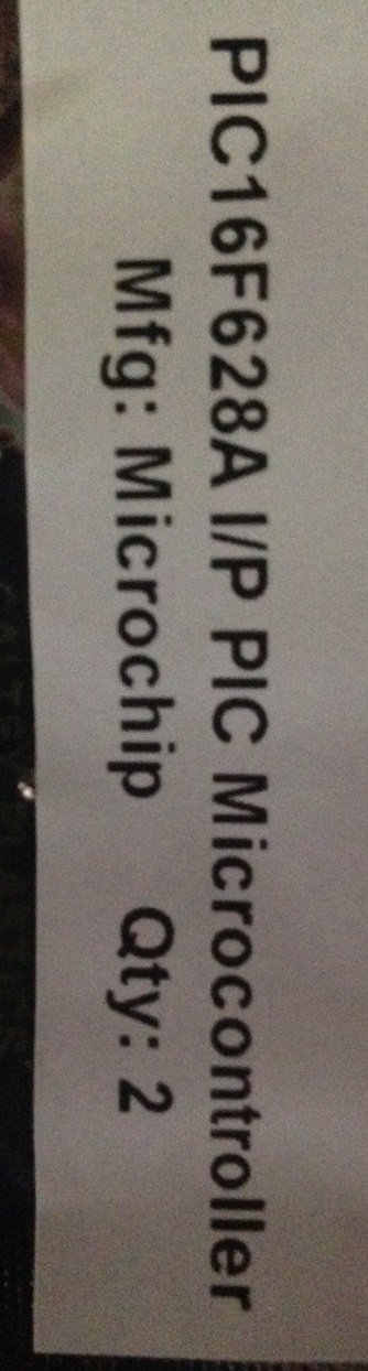

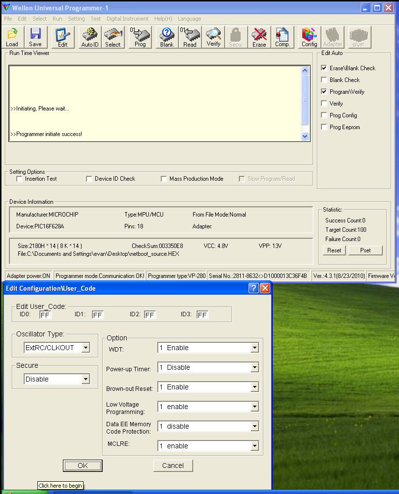

For the PIC:
Have used the code I got from @werejag
I burned it with a Wellon VP-280 - have attached screenshots of my settings. It looks to have burned correctly. I must have missed something but not sure what.
Anyone have any ideas?

Error 33 is the one I'd always get with zero pic issues. I think 31 has to do with the game data, the region, encryption, corrupted transfer, or wrong bios/region setting. Are you using the newest bios? What game/region are the jumpers set to?
Are you saying the same game/data works when you transfer it one way, but not with another?

Hm ok. Might be the PIC then.. If I recall, the pi script keeps the connection open, so you don't need a zero pic. Transfergame doesn't do that, so the PIC needs to be good.
That PIC is a pain in the butt and still a bit of a mystery to me, even though a working PIC has emerged from my own programmer: Programming zero-key pic
Ill PM you a couple things that may help
If you get stuck - I can burn you another zero PIC and send it to you, the settings need to be correct or it won't function

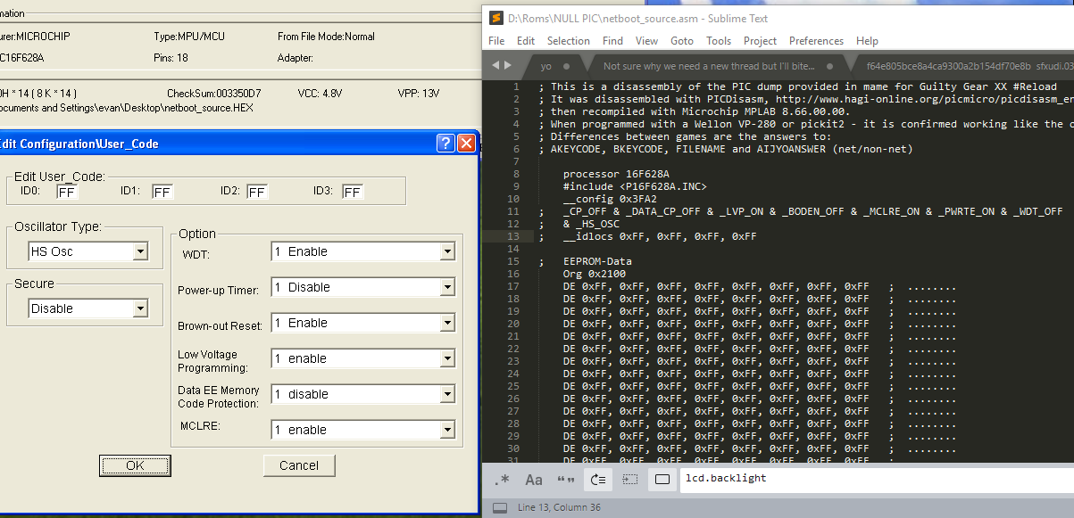

It says right there in the source. :)
HS Oscillator
CP = off
Data CP = off
LVP = on
BODEN = off
MCLRE = on
PWRTE = on
WDT = off
HS Oscillator
CP = off
Data CP = off
LVP = on
BODEN = off
MCLRE = on
PWRTE = on
WDT = off
*facepalm*
I assume CP = the "Secure" option?
No, Code Protection, you have it there, you have it disabled in your picture :)
edit: scratch that, data code protection is also listed, so yes I'd say it's secure

You are a legend mate!
Here's the settings that worked, my game just booted using only TransferGame.exe
I'll do some more testing.
The CP and DataCP flags are not that important.
If they are set, the code and data can't be read out from the chip, but the program doesn't use or check them.
The oscillator and some of the other flags like the WDT are very important.
It was a wrong oscillator setting that made some of those pics work on a chihiro 1 but not on a chihiro 3.
The python script does not only keep the connection open, it also resets a timer value regulary so that no timeout is generated.
Due to that, the system can run, even without pic installed.
If your pic doesn't work due to wrong flag settings, you will likely have the same issues if you try to run the games without pic as well.
