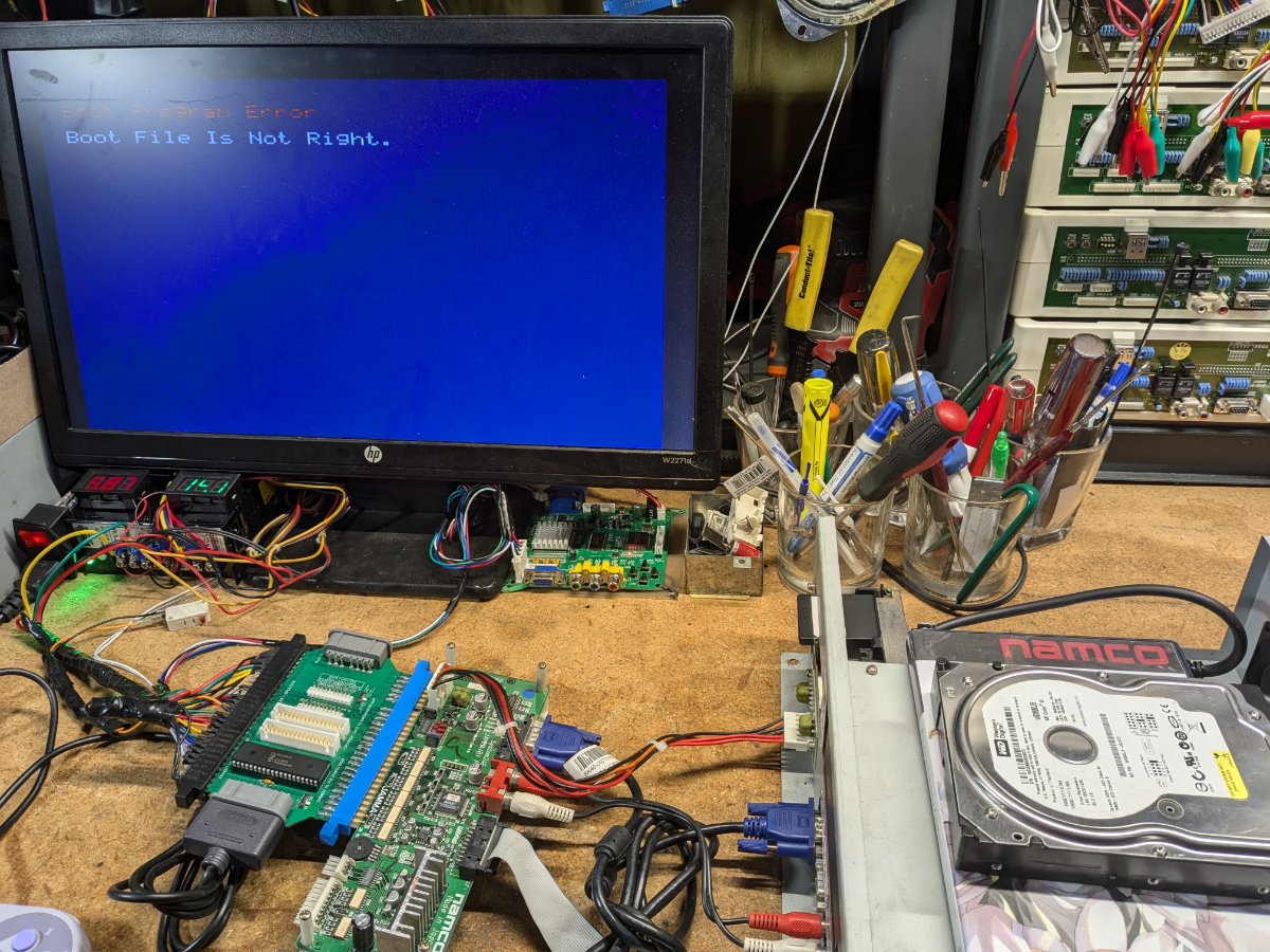

I've been trying to figure out how to CHD or Image Fates.
Have a Boot Dongle for Fates which seems to work, but can't figure out why the image won't take to the HDD.
Currently using:

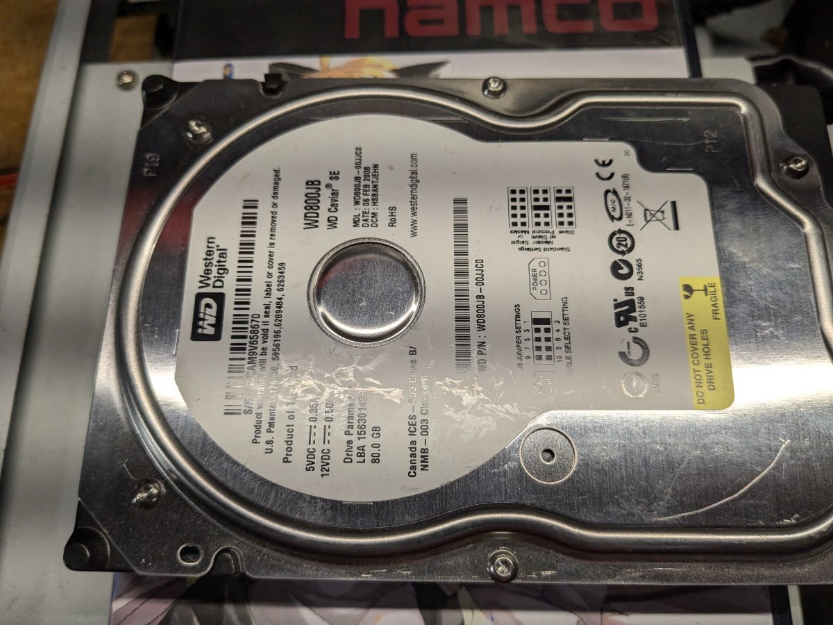

New Original HDD WD800JB
CHD from archives. CHD command (as admin) extract to HDD
Everything copies and verifies on my PC but keep getting the blue screen error "Boot file not right" when trying to boot Fates on my Namco 246. It spins up and tries, goes from Boot 01, Boot 02, Boot 03, then black screen, then flashes Boot 03 again before going to error.
Also tried using Win Imager to write as an .IMG to the drive. Same results.
Am I missing a step?
Thanks in advance!

From my experience blue screen with "Boot file not right" is when dongle is dead or have bad connection caused by dirt or PCB inside the dongle is loose. Also check your HDDs setting on back of it. IIRC it should be on MASTER.
Appreciate the info. Dongle was taken apart and cleaned. Tried in both my Namco 246 and Namco 256 (On 246+ mode) and get the same results. I've tried multiple images from the archives, including the .IMG file defor had posted from their personal collection, which was the full 80 gb.
The back of the HDD has been changed from Cable select to Master and makes no difference.
Idk if the dongle got corrupted somehow during the process, but the card was flashed from an original Time Crisis 3 dongle, to a Fate Unlimited Codes Dongle. All other cards that were flashed work fine, except this one. I can't tell if it's the dongle or the HDD at this point, as he couldn't test the dongle for Fates, as he didn't have a HDD to test.
I think you can test the dongle read first.Then you must see this screen.
And I suggest you use this syntax to convert chd to img.
for /r %%i in (*.chd) do chdman extracthd -i "%%i" -o "%%~ni.img"
and finally use HDDRawCopy1.20Portable.exe to write the img image to your 80GB IDE hard disk.
Of course, you can also download the img format file directly.
NM00048 FUD1-HDD0-A (HDD).img.gz

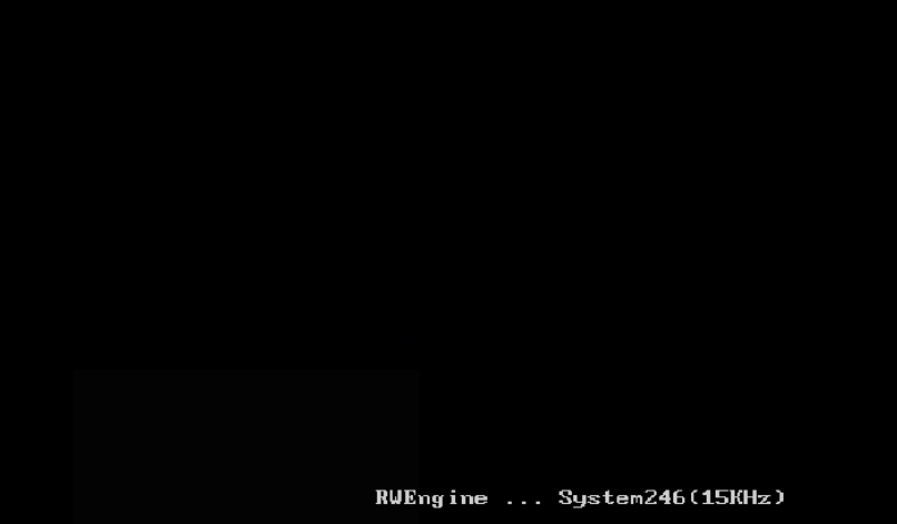

Yea mine does some of that, but stops at Boot 3.
Mine doesn't do the "ReEngine" or sound initializing that you showed. It just does Boot 03, then goes black, then the blue screen.
Im using a WD800JB which I was told is better quality than the WD800BB that was original equipment. Idk if that makes a difference but it's still 80gb.
I think I used the HDDRawCopy tool to make the last image file I tried. But I'll check when I get home. And I'll test that script as well to be sure it's not what I was already doing.
If you have PS3 memory card adaptor PM and I will try to fix your dongle
