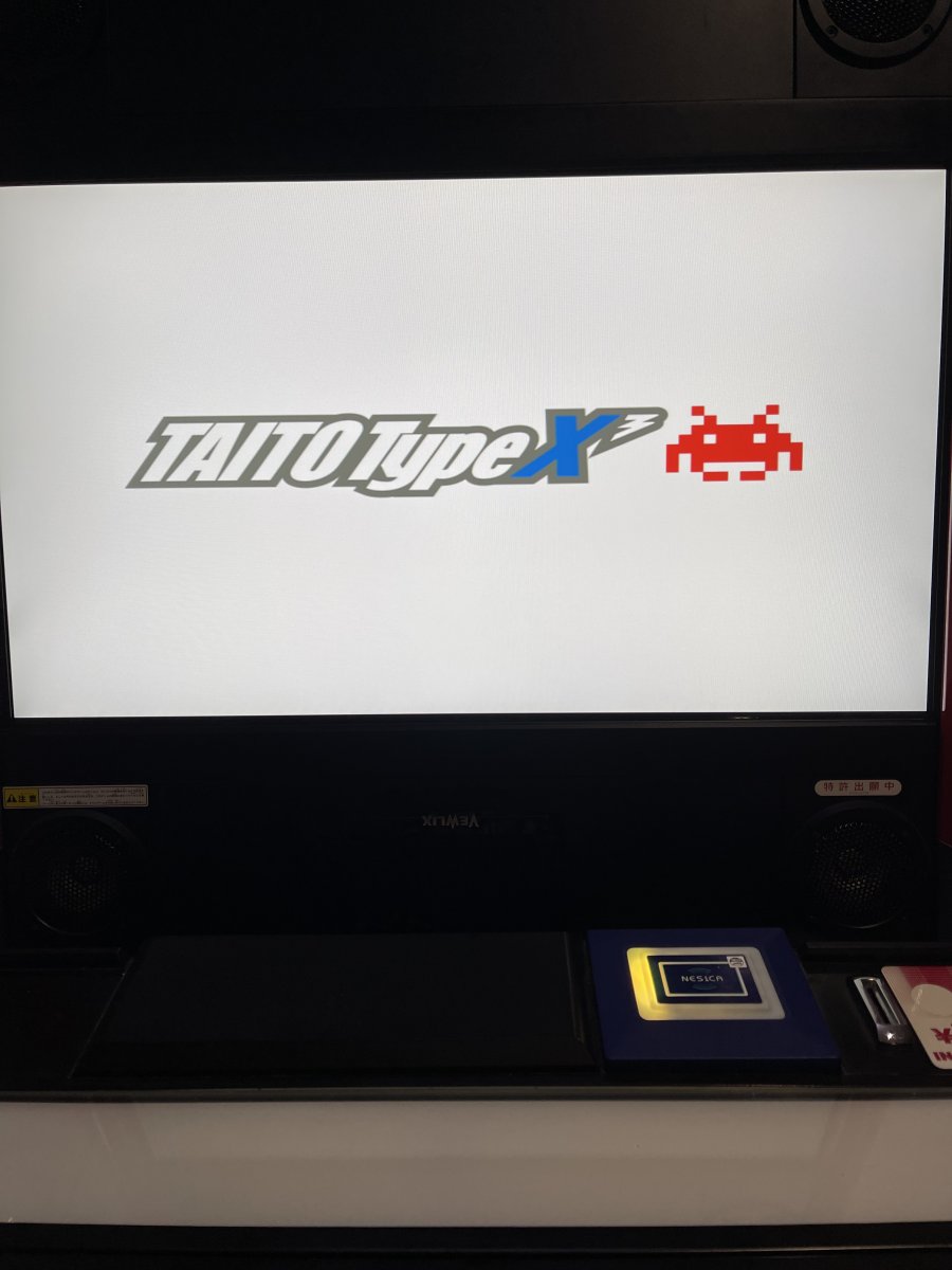

I just fitted in the Ssd with the multi and the screen is stuck at the logo. Maybe I’m missing any step? I've read the instructions a few times, but I don't know what I'm forgetting. Any suggestion will be welcome 🙂👍🏻

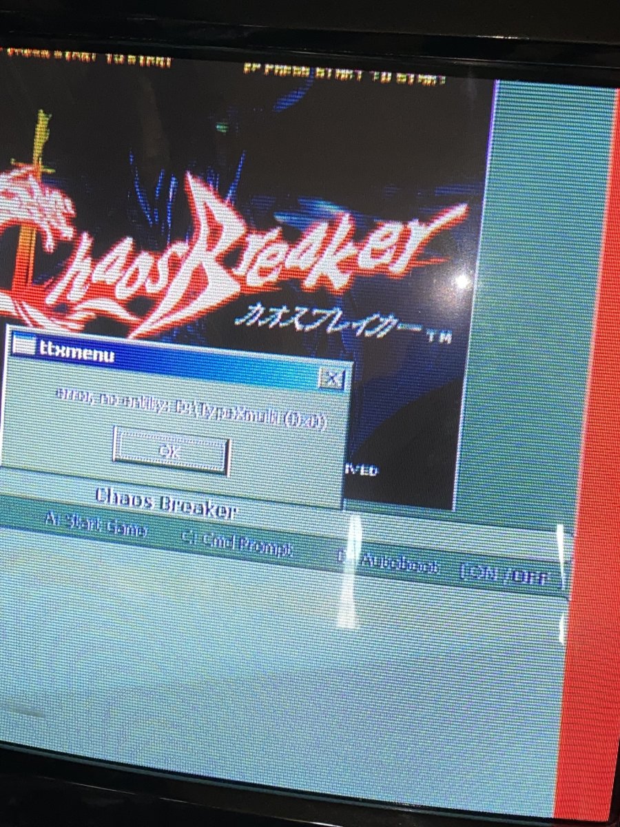

Powered the ttx , powered the nac cab , loaded first chaos breaker and then tetris and ive receive some messages , first ive received is : “ error , no entity : D:\TypeXMulti (0x0)
After hit enter is enter in game without problem
Ive also received this message too and is needed to reset the system after receiving
“Error lunch file is invalid”

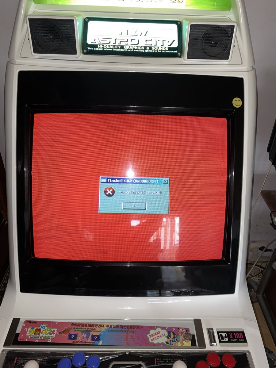

Now it doesnt enter in system , tried with both IO (chinesse & taito) .
I erased the txt from games partition and doesnt enter in system . It doesnt past of that “reset line” to take me to red screen and then to enter to the games menu to choose a game
