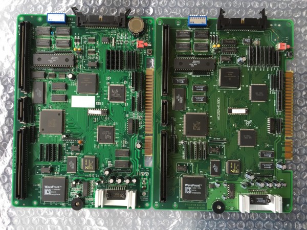

Do you know of an easy way to tell them apart? I have 2x mobos and they're different but I have no idea if they're older or newer revisions or what.
I have owned all three revisions of the PGM motherboard. I noticed no difference whatsoever and just ended up keeping revision 3 (the one that sheep_nova sells). I've had a couple of screwy motherboards which froze games and did weird things in the settings. I attempted to fix them at one point, but given how cheap they are it's worth sourcing a couple while they're still in abundance from China.
I'm not sure about V1 and V2, but V3 is easily identified because it has a coincell battery and a circle screen printed on the PCB around the coin cell.
Check these pictures scalped from Google images:
The motherboard to the left is revision 3 (the version that sheep_nova sells) which came stock standard with a coin cell battery from the factory.
The motheboard to the right is revision 1 (you can see the battery leakage). I had a couple of yaton's deadstock DDP2 kits which came with two different motherboards (this revision 1 and also revision 2). The batteries were like new, checked them a month later and they had leaked all over the board. You definitely want to remove that battery ASAP, it's horrendous how quickly the traces get damaged.
I'll try find a photo of revision 2 and post it up later :)
Another interesting thing to note, the Chinese motherboards have PGM moulded into the plastic shell, whereas the Japanese and Korean motherboards have a PGM decal/sticker in white on them.

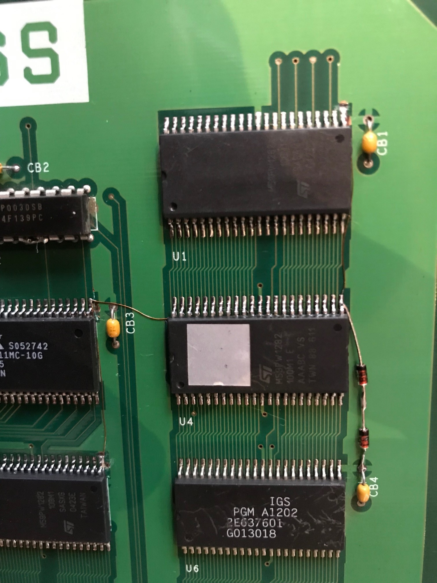

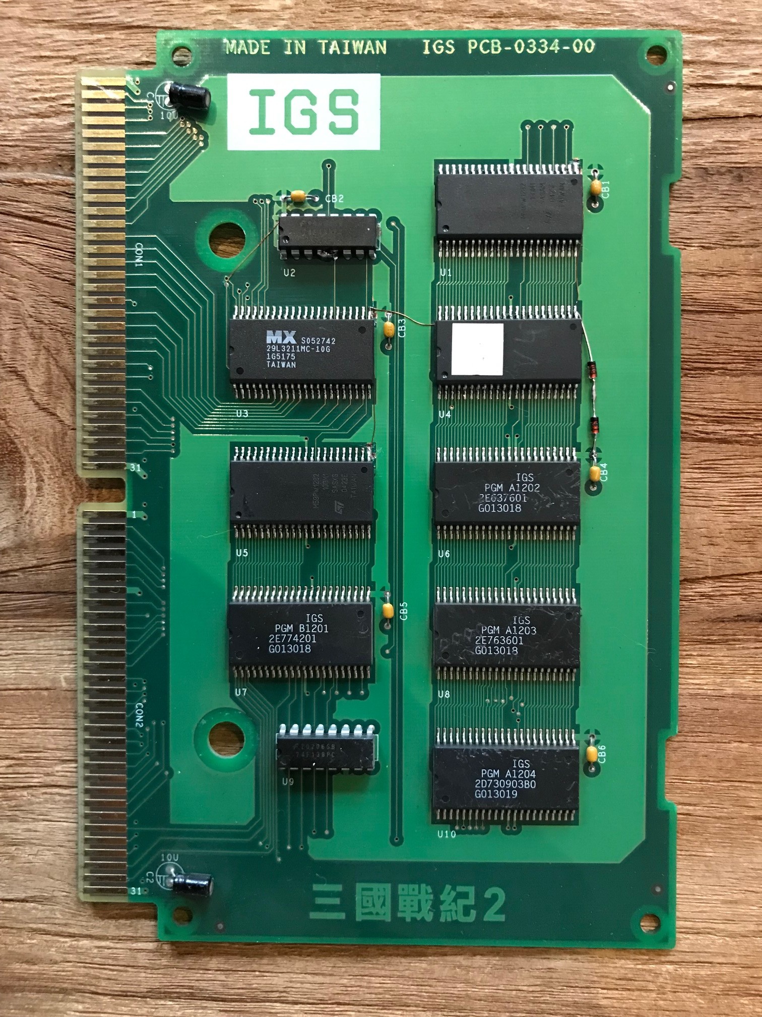

Here ya go boys;
(Label not pictured, but it came included :) )

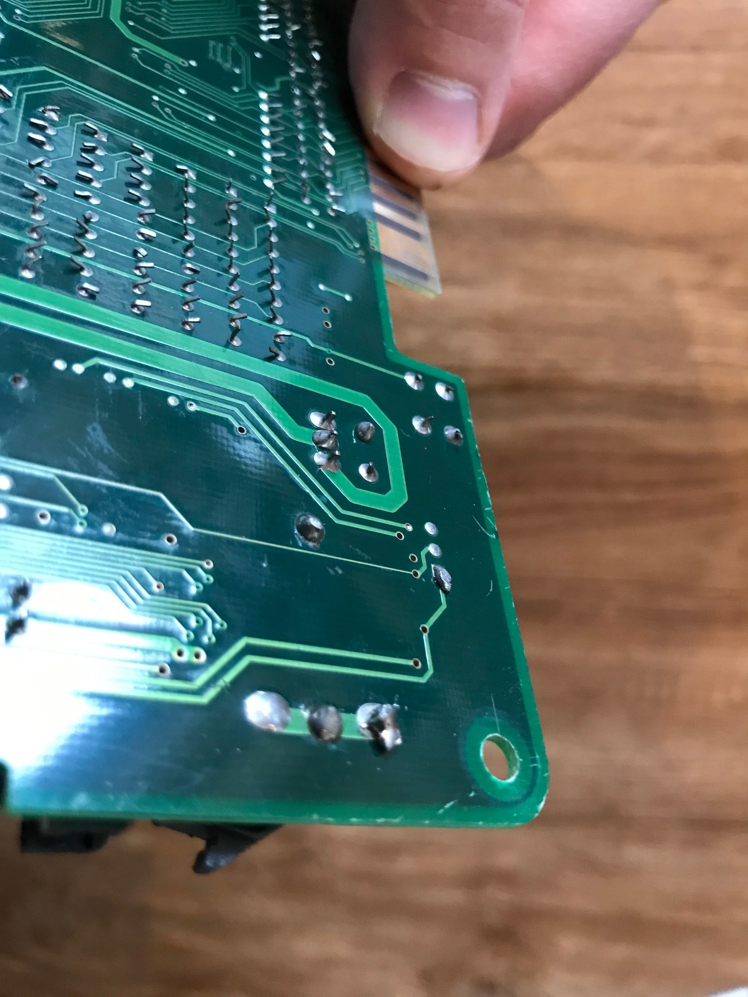

and also some pics of the v3 motherboard I got, but there seems to be some sloppy soldering done around the battery holder, so is it a original v3 or just a v1 or v2 with a coin cell?
