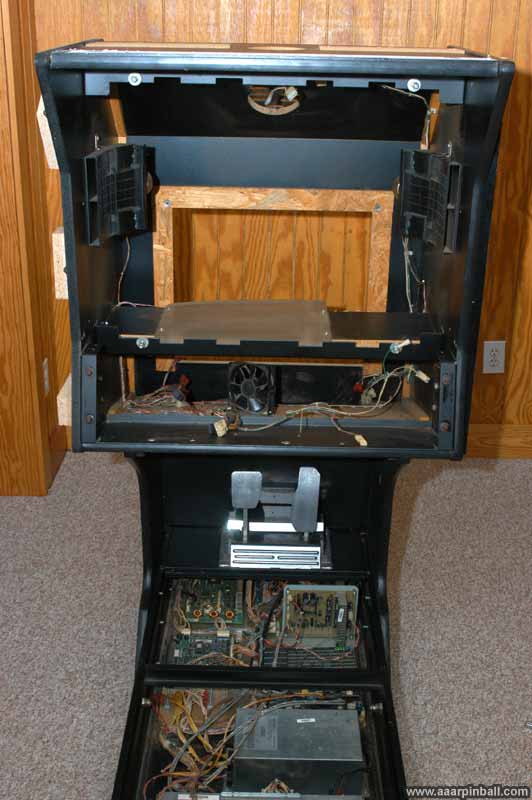

When I had my Virtual-On cabinet they used a normal speaker type at the end of a square tube to direct the sound through the small areas beside the monitors. I did not take any pictures nor could I find any to show you what I am talking about. But I think they would fit.

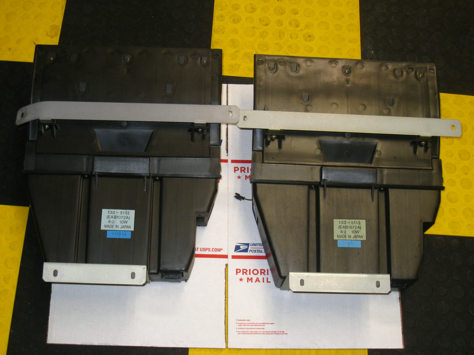

I was thinking something similar as well, like the speaker enclosures for Sega Super GT cab that look like this
Or maybe from a Daytona cab, which improves on the above by enclosing the driver.
Yep that's them. If I remember correctly they are just held in with straps.
