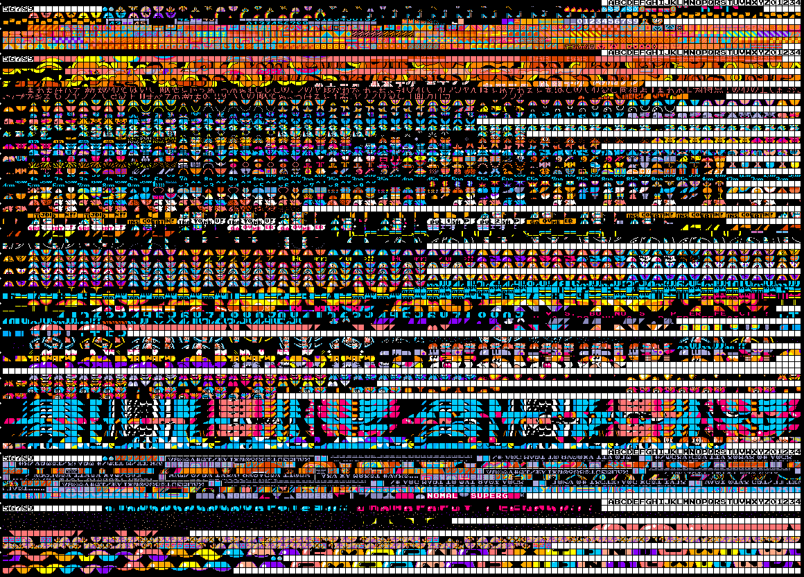

Here are the sprite graphics comparing prototype to final version using MAME's tile viewer
Prototype:
Final:
Looks like the sprite graphics for the Bonus Games that are sometimes triggered by item pickups are missing from the proto. Very interesting!

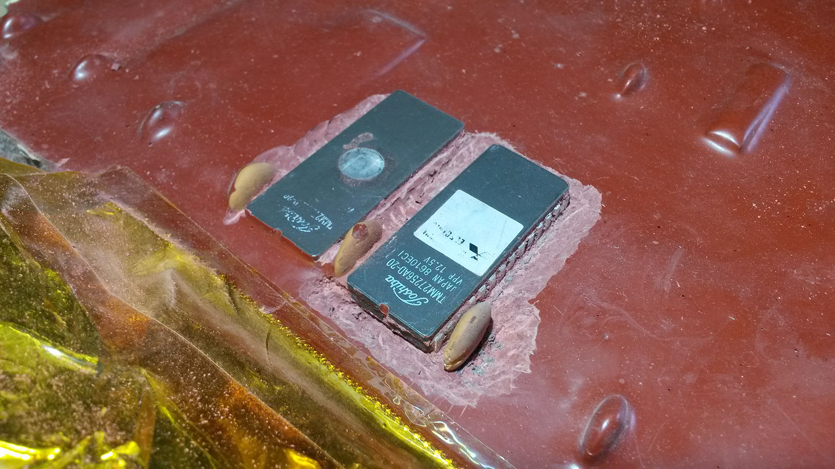

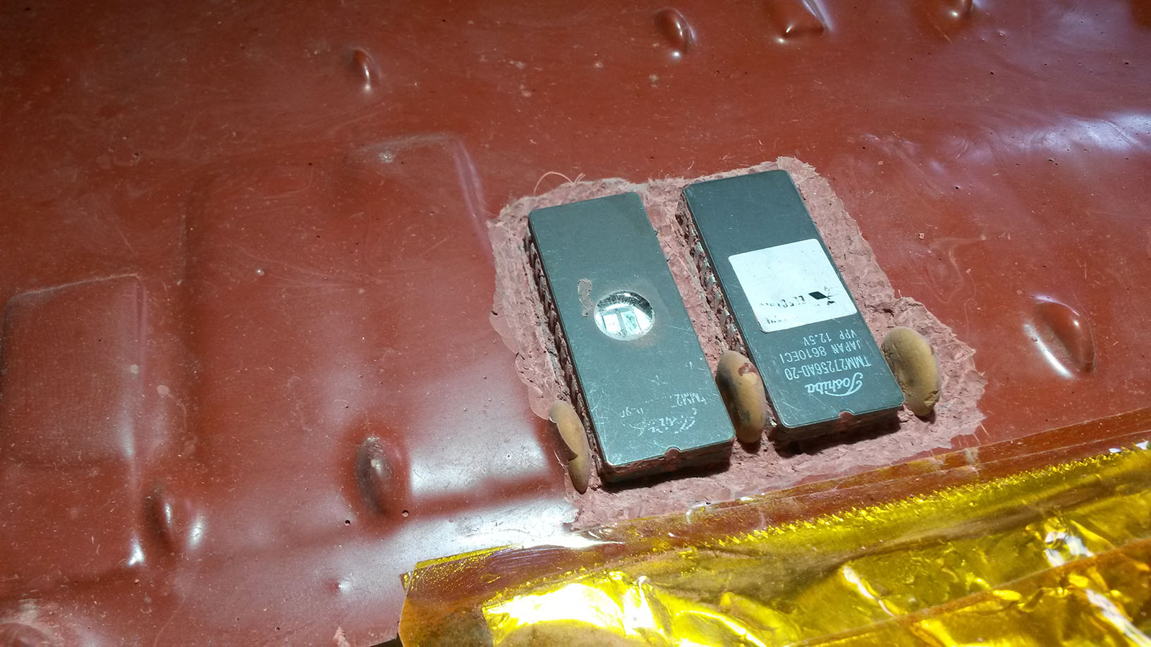

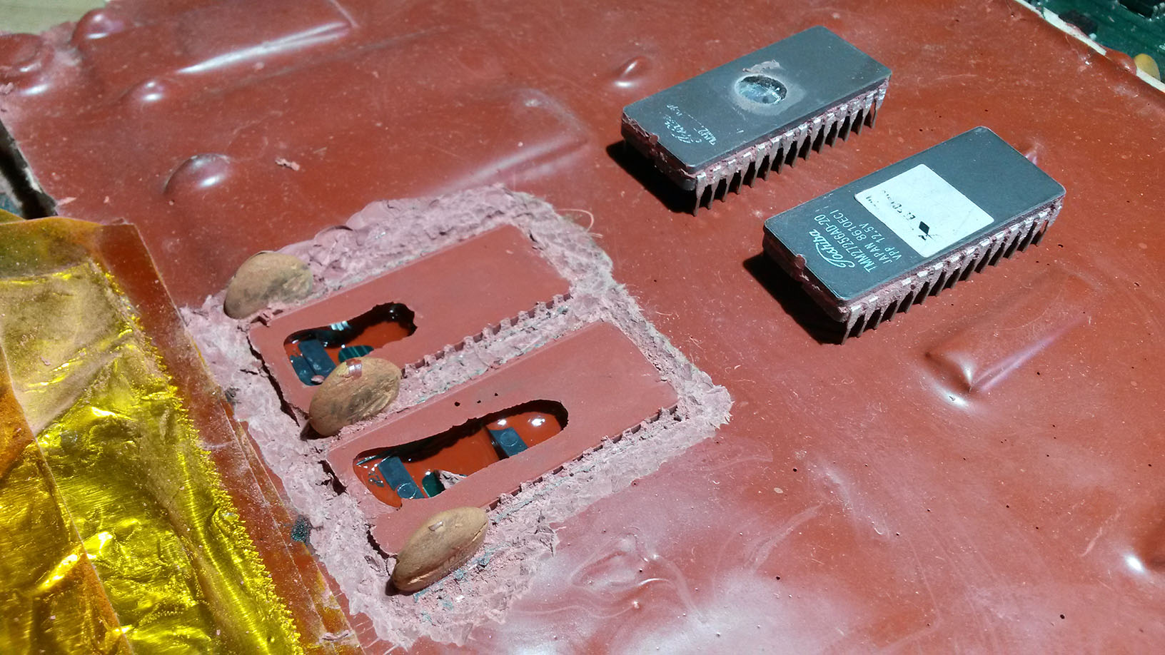

More progress removing eproms from their epoxy graves! Took about an hour to get these freed, not so bad.
Made a small heat shield using tin foil and kapton tape to protect the board inter-connector. Wearing fitted respirator, nasty dust. Eye protection too, don't want a chunk of crud in the eye!

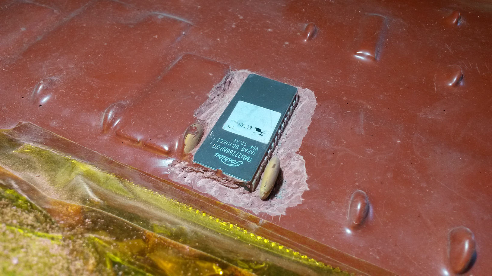

Got the final eprom extracted, along with the PAL logic chip and computed the chip equations (will make another thread on this in the future)
Insane how that stuff just gets into everything.

am i the only one that finds it funny that they went to the trouble of epoxy, but put the eproms in sockets first!!
Not really surprising. it's a prototype so they socket a lot of stuff so they can easily pull/reburn stuff if they have to. then once they were ready for testing in the wild they just dumped epoxy on it instead of soldiering all the sockets and then soldering all the chips.
but can you imagine how much more of a pain it would be to remove the chips if they WERENT socketed?!
it would be a real pain to desolder them on the top of removing all the epoxy...
