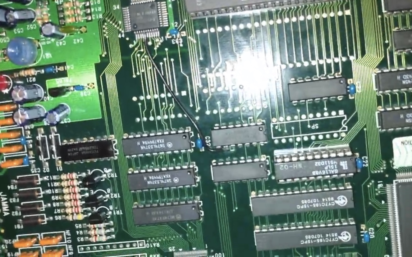

@twistedsymphony I've cutted here, underneath the cable.
I didn't programmed 4E and 8F at all, there are still the original ones from Magical Drop
that's the wrong pin, you've added a wire to pin 7 (or 7, I can't tell) not pin 5.
pin 1 is on the far left and pin 11 is on the far right
EDIT @AlxUnderBase beat me to it...
Yeah, sorry, it was an older picture when i was trying to figure out by my self. this is how its now.
I posted that just for the cut (cable wasn't even connected)
