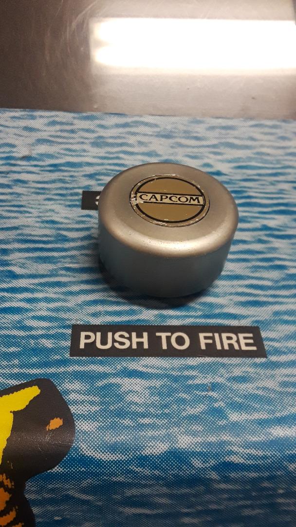

the base is but it looks like someone swapped on incorrect knobs, and the way the new knobs are sized it looks like it would prevent the push function from working properly.

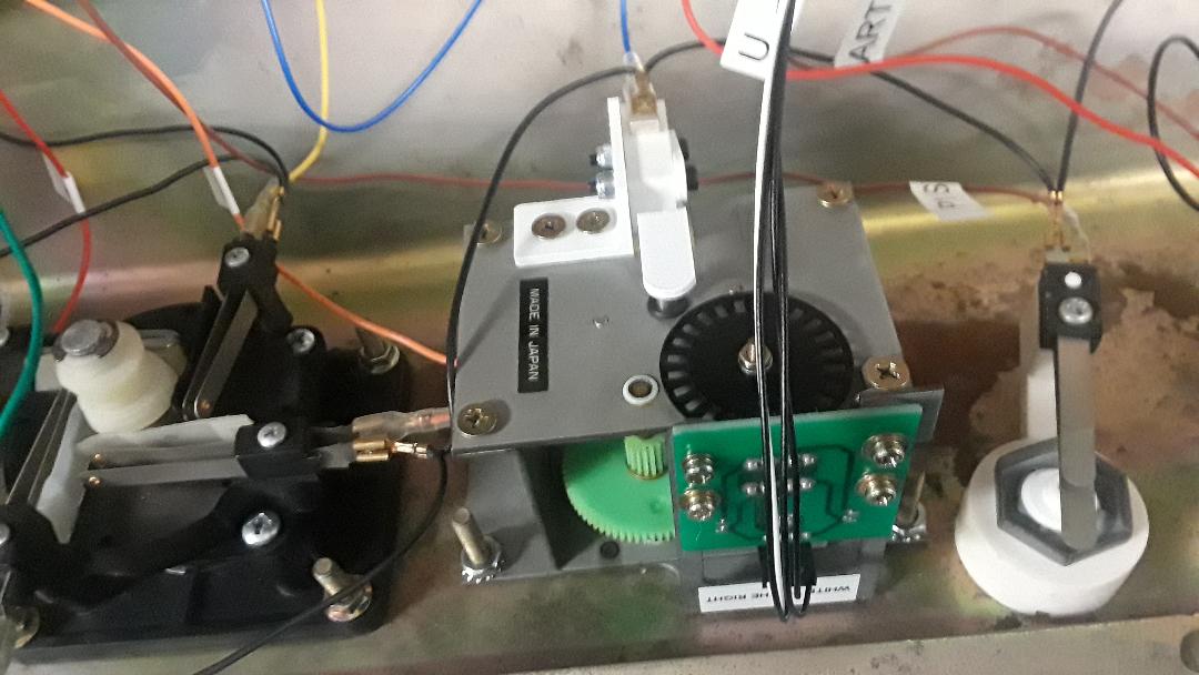

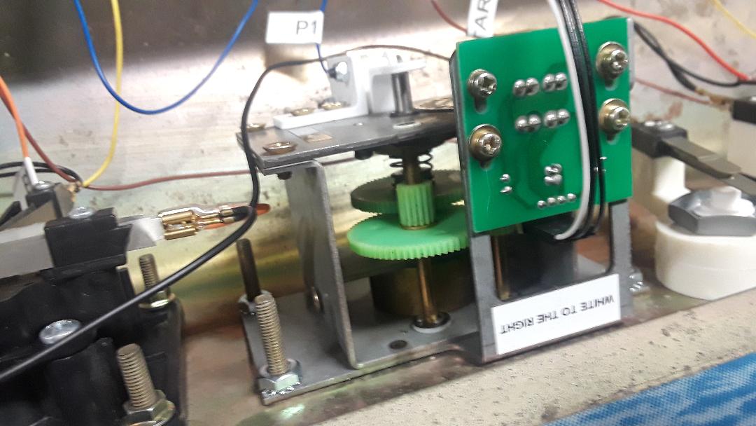

@glstar and @Derick2k I have a friend who is generous enough to lend some spinners for the cause as well, and they look like this.
I think you guys are good now, but want to double check as there a few types of knobs out there and maybe you can use one of the original ones below for an exact match.

Those are for sure original capcom american style spinners.
They are really nice.
I think that Derick2k would have great use to repro them.
