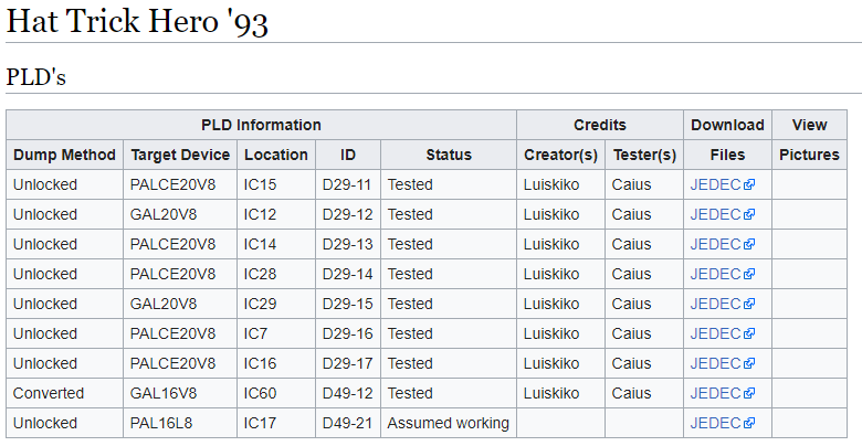

IC28 is labelled as D29-14 which I think originated from Arabian magic. The file is available at jamma-arcade under the hat trick hero'93 title as thats the alternative name for cup finals
You will need a GAl20v8 gal which are hard to get to use the file in its original form though
If you are stuck I can help you and supply a chip/file for use with a modern ATF22V10 gal. There is some conversion needed as the 22v10 ics are larger in size and so you can't just use the original file with the newer ics.

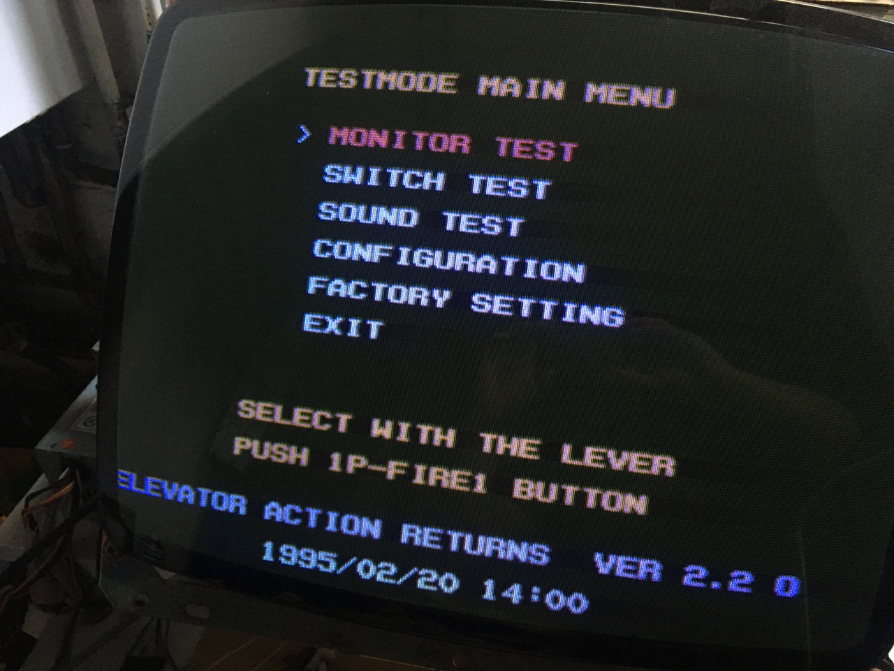

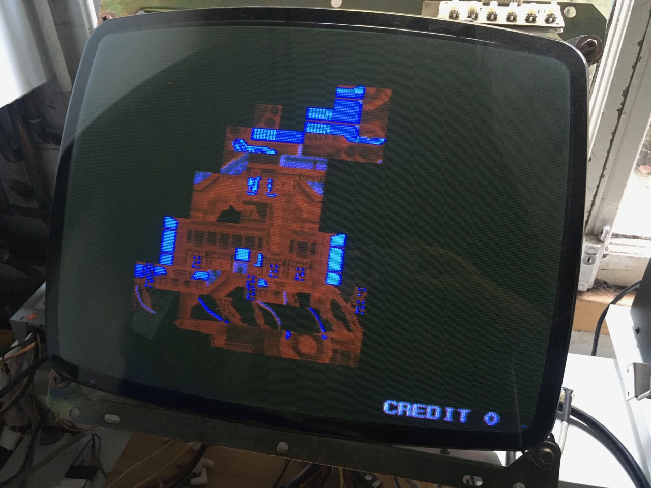

Ok taito f3 arcade fans, i have some cool things to report. Pretty happy with myself right now :)
So, before i get into it then let me share this
I've been on a pal equation journey :)
I have created a custom pal for this board and i think* its now unlocked games with 4 mbit game rom sizes. More to discuss about this, but its really interesting how taito created this single board hardware. (For reference gun lock uses 2 meg game roms and cup finals uses 1 meg game roms.)
Now burning some new spite, tile and music roms to see what we get.

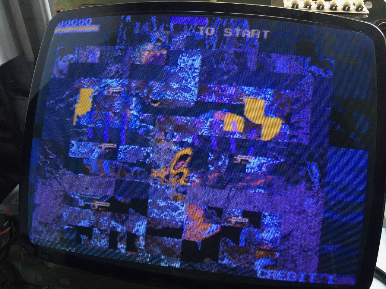

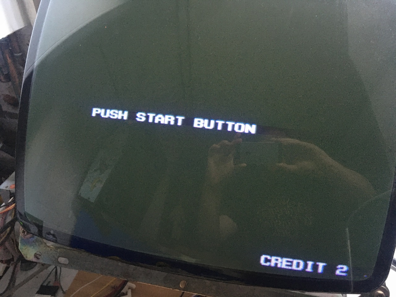

As a quick test, i did what i did before with gunlock to see if i could credit up and start a game, and i could. Graphics wrong again but it think these images are actually pretty useful
