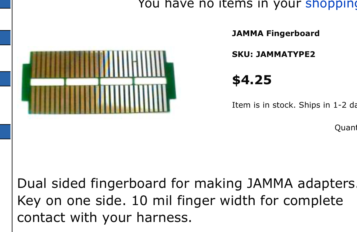

Yes, the seller will send me the board without the fingerprint. Thats why I asking if somebody can help me selling me one.
How I suppose to connect that part with the pcb?
Soldering?
Any video or tutorial I’ll apreciate it.

This looks more complete part for a begginer like me.
Somebody have one of those for sale? Help me guys

What you need depends on what he’s sending you, but there’s no world where you’d need that assembled thing above.
Either you need the whole cps1.5 filter board assembly, or you just need a fingerboard that will slide right in.

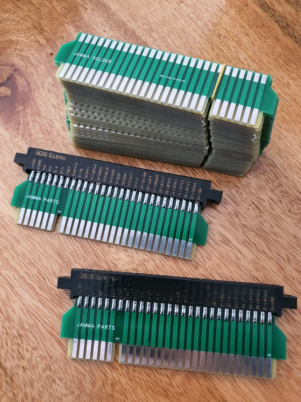

Photos: https://imgur.com/a/uyvkrhy
it all fits together, held by the blue edge connectors. No solder, just pressure.

Ohhh thanks for the pictures.
I think I’m understanding
so I only need buy one of this things
If that’s all he’s not shipping, yes.
And if it arrives looking like that photo above, that is actually 2 finger boards held together with a few bits of plastic ... you’d have to cut one out ;)
