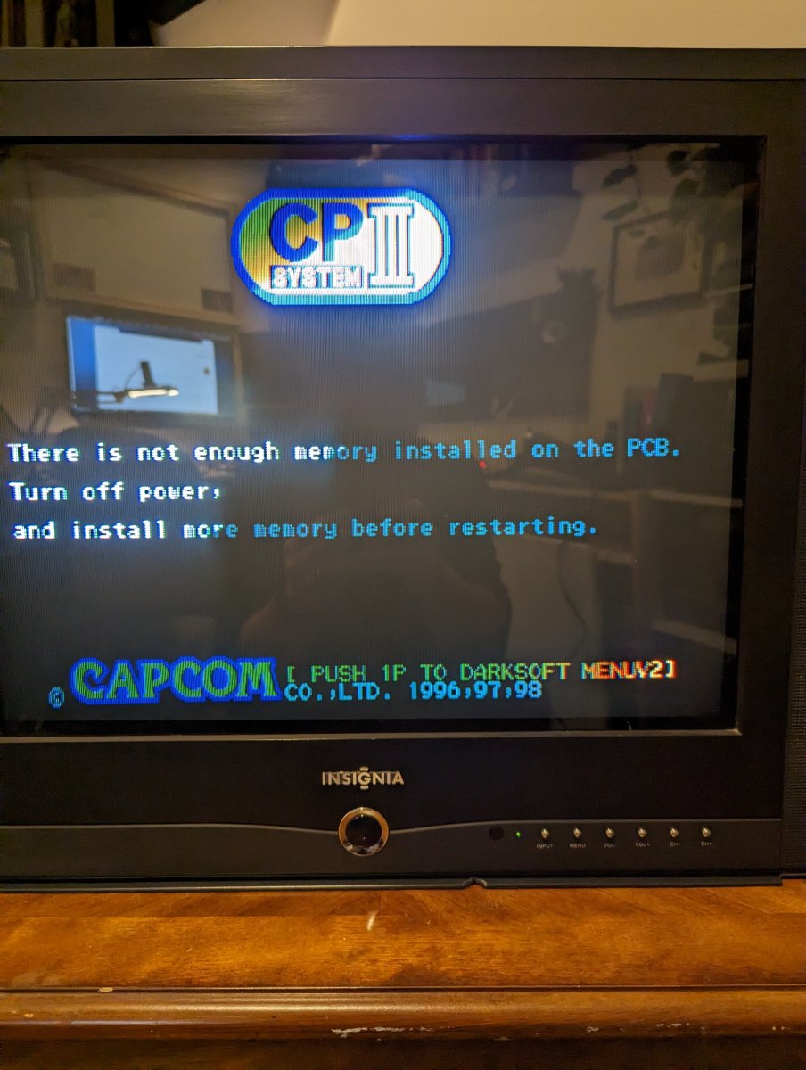

I have a CPS3 with full ram, bluescsi, and CD Ultrabios for standard. Whenever I start it up - the "Not Enough Ram" screen shows up with the the "Press 1p to Darksoft.." at the bottom. However, no matter how many times I press start or any other button, it won't go to the menu. I've cleaned all the contacts on the board, cart, and simms extensively, using an eraser, alcohol, and deoxit.
I know the controller works fine because it works fine with other boards and was working fine prior because originally it was a NOCD cart and I could select my region
I'm pretty new to flashing ics but everything seemed to go fine and I verified it afterwards.
At this point I might re-flash the bios but wanted to get some thoughts before I did so.

Interesting that you have the same issue. But yeah, as previously stated, I did clean the contacts on the simms and slots with deoxit. And yeah, holding down start while booting. Even tried with 3 different controllers.
I'm just going to try flashing the bios one more time and see what happens. Will post the results.
****Update
So I re flashed with SuperBios this time and did another round of cleaning on the simms and connectors. No dice, same thing. I get to the same screen and holding start at startup does nothing. Neither does pressing start, holding any other button, or pressing any other button.
For those more experienced, even if one of the simms is bad I should still be able to boot into the Darksoft menu, correct?

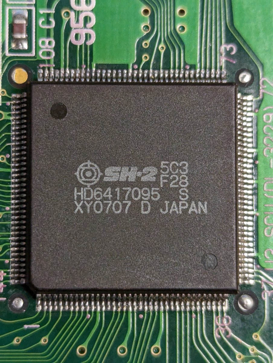

I'm pretty new to CPS3 and the cart I purchased was sold as "custom" sh2 but everything I've read tells me I have standard. I've included a pic of the SH2.
Depends, but most probably if the cartridge boots and at least shows something on the screen, then yes, you should be able to go to the menu. If you dont, then I'd say the cart is bad.
Yes, that picture is a standard SH2 cart.

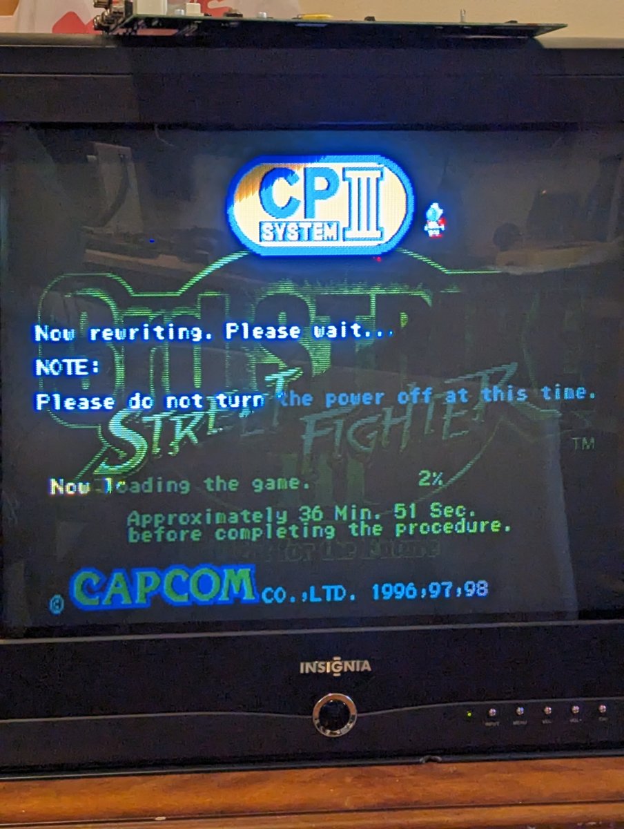

Progress is being made! For whatever reason I decided to swap simms 1 and 2, powered it on and it worked! Not sure why - maybe swapping cleaned a little extra of whatever off the simms. You'd think that 2 rounds of pencil eraser, alcohol, and deoxit would be enough.
Did a quick simm check and everything seemed to be fine but not going to celebrate whole heartedly until I'm actually playing some rounds of SF3.
**** Update
Played a few rounds of SF3:TS and now loading up Warzard. Everything seems to be working fine other than the sound but I think I just need to replace the potentiometer because messing with it does produce sound. It's just really low and the volume doesn't seem to change.
